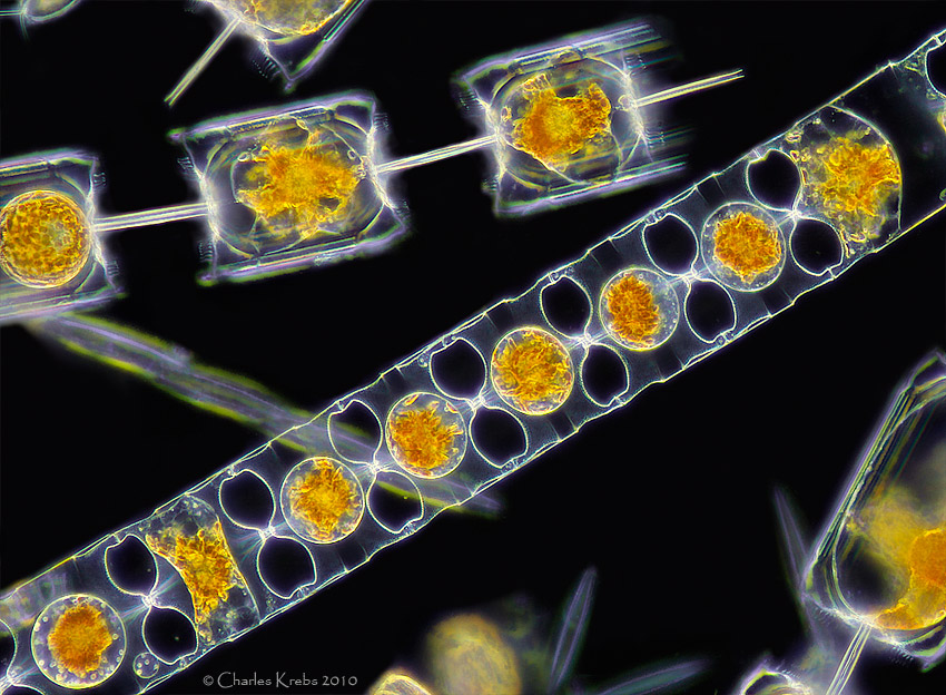

4/0.16 S Plan Apo, brightfield. Not a very large "stack", but it drove me crazy moving the little "plumes". I gave up and was later surprised that there was one batch that looked OK.

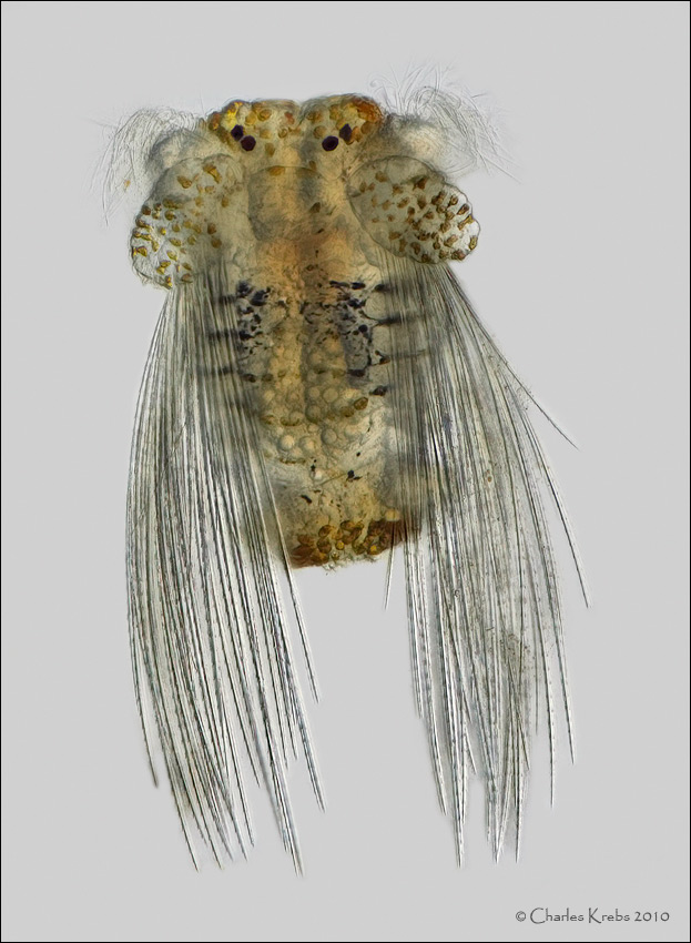

60/1.40 S Plan Apo, DIC. This dinoflagellate was really far too "deep" into the slide for the 60X. I could barely focus without hitting the cover slip. As a result the resolution isn't very good, but it was an interesting angle on a "dino" I had not seen before.

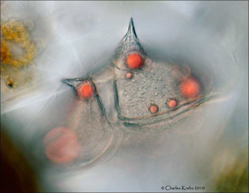

10/0.40 S Plan Apo, darkfield. No idea what this is... (but it looks neat!)

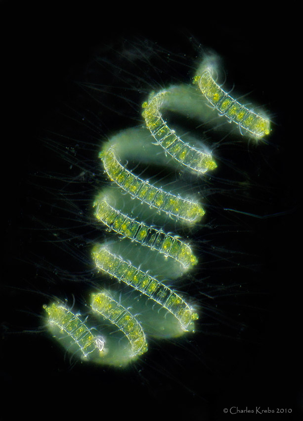

20/0.46 S Plan Achromat, darkfield. I can't do darkfield with the 20/0.70 without changing condensers, so I occasionally put a 0.46 Plan Achromat on the nosepiece for times when the 10X just isn't enough.

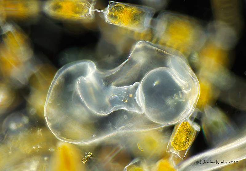

10/0.40 S Plan Apo, darkfield. Cropped from the center of a horizontal frame.

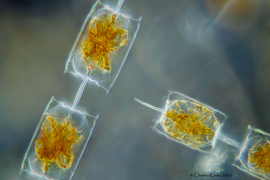

This was an old 25X Zeiss Neofluar (0.60 I think). When used with the darkfield stop I've placed in my condenser it provides a lighting that is right on the "edge" of darkfield and "circular oblique".
It doesn't always look that good, but with certain subjects it seems to work nicely. This was a very deep slide and these diatoms were right up against the cover slip. The other debris had settled to the bottom and made what I felt was an interesting background

Congratulation! The third picture could show a larva (maybe a Dipleurula) from Asterias rubens (commion starfish) and the last picture Ditylum brightwellii.
