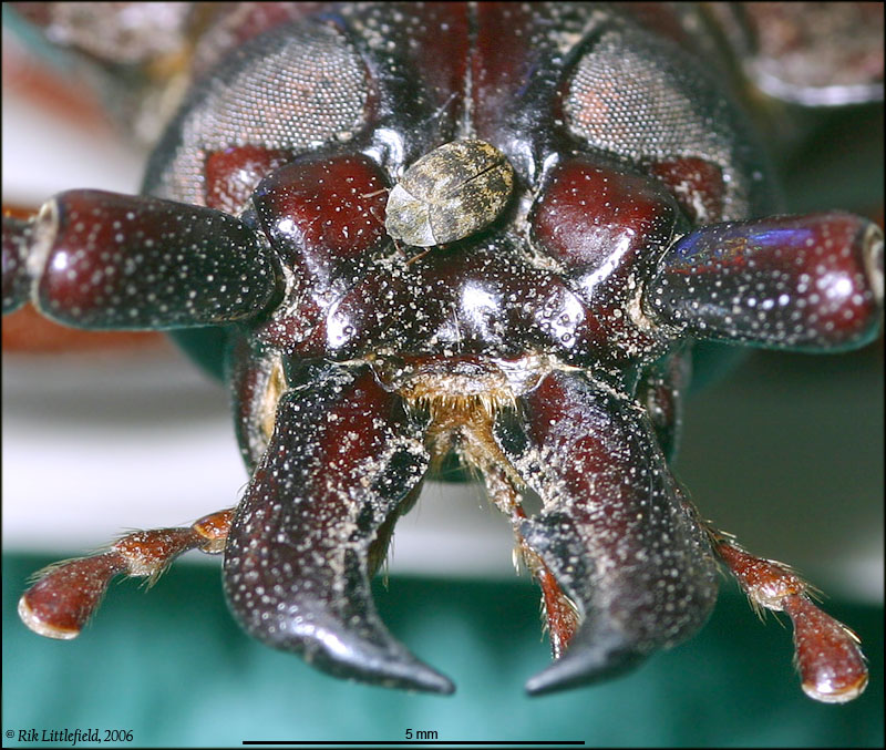

I posted out this shot last night as part of a technical discussion.
But maybe you'll find it interesting as a picture, too.
The larger beetle is a Long Horned Wood Borer (Coleoptera:Cerambycidae), total body length 75 mm from posterior to mandibles. It's from Scottsdale, Arizona -- I found it lying belly up on a sidewalk outside a hotel room years ago. The smaller one is a Carpet Beetle (Coleoptera:Dermestidae), total body length 2.5 mm. It turned up in one of my windowsills at Richland, Washington.
The subjects are posed, of course.
Canon 300D, Sigma 105mm at f/8. Shot at 1:1.5, cropped for presentation. Reproduced here at about 16X life size.
very good photo Rik, I like it alot :lol: I love the wrap-around eyes on these large longhorn beetles and you are right, I never find carpet beetles in the carpet, always on the window :wink:

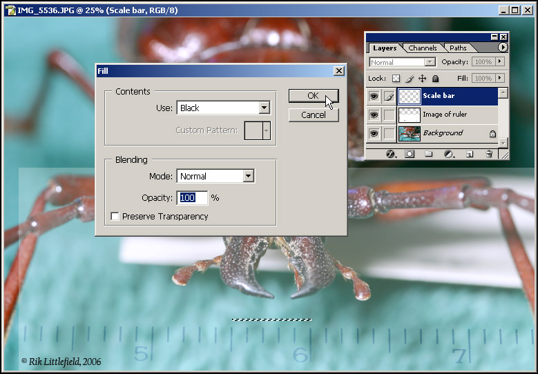

beetleman wrote:How do you come up with the length of your scale bar. Do you measure something on your specimen...easy in this case, and draw it in during processing? I know it is different for Micro.
Nope, no different at all -- you just get to use a bigger measuring stick for Macro. :wink:
The key trick is to shoot a picture of a physical ruler using the same lens settings -- including focus -- as you used with the subject. Then just use your favorite photo editing tool to transfer a measurement from the ruler image to the subject image.
The picture below illustrates one approach.
Using Photoshop, I added the image of the scale over the image of the beetle. I set the image of the scale to 25% opacity so I could see the beetle through it. Looking at the beetle and ruler together, I decided that a 5 mm bar would work well. Using the marquee tool, I selected a region a couple of pixels high and however wide it needed to be, to line up with 5 mm on the ruler. Then I filled with black in another layer, to draw the scale bar. The job was completed by removing the layer containing the image of the scale, and adding "5 mm" as a text layer.
I always do these things as layers so I can freely move them wherever they need to go to fit with the picture.
