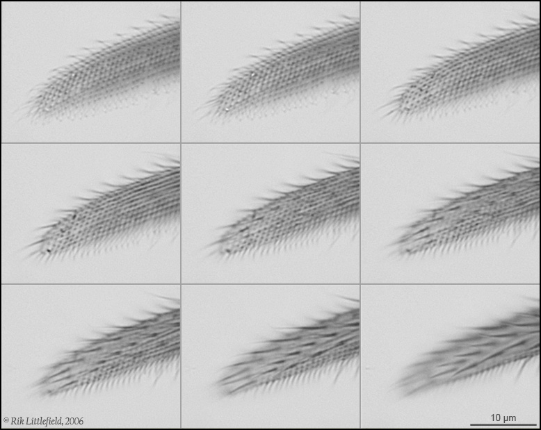

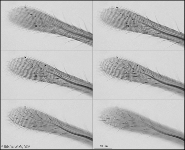

Shot using aus Jena 100X NA 1.25 objective oiled to cover slip, subjects mounted in immersion oil, NA 1.2 condenser watered to slide, Olympus 80mm f/4 bellows macro used as 2.5X relay lens.
Heavily cropped and resized. Focus stepped from near to far.
A couple of weeks ago, I posted over in the macro forum some shots of the whole foot of a jumping spider. Jumping spiders have "sticky" feet that get their adhesion from Van der Wals forces acting on a multitude of tiny "setules" that are clustered at the ends of spatulate hairs. The setules can be clearly imaged using SEM, and the macro shots might just barely be resolving individual setules, so it was natural to ask what they'd look like with a high resolution compound microscope.
Shown above are a couple of answers to that question.
I'm pretty sure that the top set of pictures is one spatula lying flat, while the lower set is a different spatula lying a bit on its side. It seems that each spatula has a few widely spaced bristle-shaped projections on one side, and a dense regular array of setules on the other side. Spacing of the setules measures 0.7 to 0.8 microns, smack in the middle of the size range that we guessed from some of the SEM pictures that people tracked down.
This was my first foray into high magnification photomicroscopy. I'm pretty satisfied with how these shots came out, but the equipment setup was definitely what you'd call "cobbled together" and the whole affair was rather more tedious than I'd like to do on a regular basis. (This, mind you, from a man who regularly shoots 70-100 frame stacks for extended depth of field. Hhmm... :-k )
PS. These shots are green channel only. Color added no useful info and I found the CA fringes distracting.

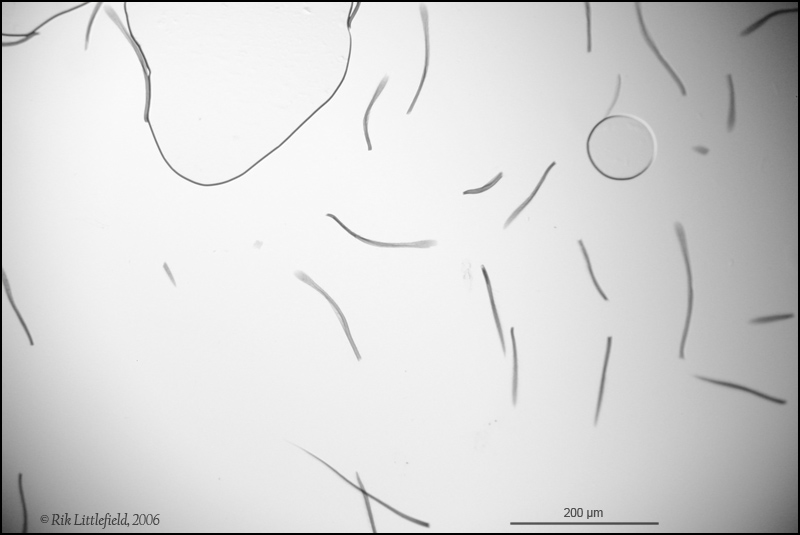

Here's what a larger section of the slide looked like, using a 10X objective with no cropping. Shot through the oil drop left over from the 100X objective. The bubbles are in the immersion oil used as mountant.

What I did, working at 45X under a dissecting scope, was to scrape off some of the hairs into a small pile on the slide. That by itself was not simple, considering the small size of the hairs and the fact that they're designed to stick to anything they touch.
Then I dropped a tiny bit of immersion oil -- about a microliter -- onto the pile. I was expecting problems with wetting -- figured I'd get a zillion little bubbles trapped in the hairs. But that didn't happen at all. The oil wicked right in and wetted everything perfectly. In a couple of seconds, what I had was a small pile of hairs still stuck to the slide, but completely wetted with immersion oil.
That situation didn't last long, however.
As I watched, intensely wishing I had a video camera running, each of the hairs individually detached itself from the slide and quickly floated to top dead center of the oil drop. They reminded me ever so much of what happens with those foam pads that kids play with in a swimming pool. You know -- the ones you just can't resist sinking by standing on them, but then they get loose and come shooting to the surface like that sub in Hunt for Red October? Fun to watch!
Pretty straightforward after that, as far as slide prep was concerned. Plop on a cover slip, a drop of water on the condenser, oil for the lens, and it was ready to go.
