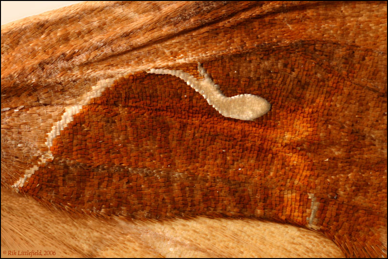

This is the wing of a moth, perhaps Anagrapha falcifera. It's a close relative of Autographa, such as the Silver Y moth that George photographed for us a couple of months ago.
The "Y" pattern on the front wing of these moths is well known.
What's probably not so well known is that the "Y" pattern is not composed of just differently colored scales, but rather differently structured scales.

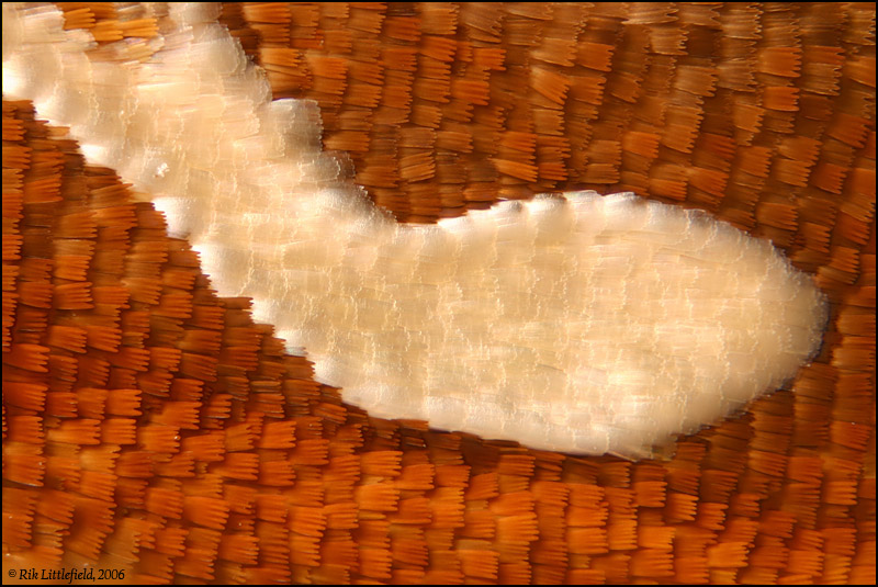

I confess, I didn't know this either. I was just testing a new lens setup and used the moth wing because it's attractive. But when I looked at an "actual pixels" view, I couldn't make sense of what I saw. So I hauled out one of the "big guns", so to speak, and took a really close look. Here are the two pictures.
Canon 300D, Olympus 80mm f/4 bellows lens, full frame, stacked at 0.002".

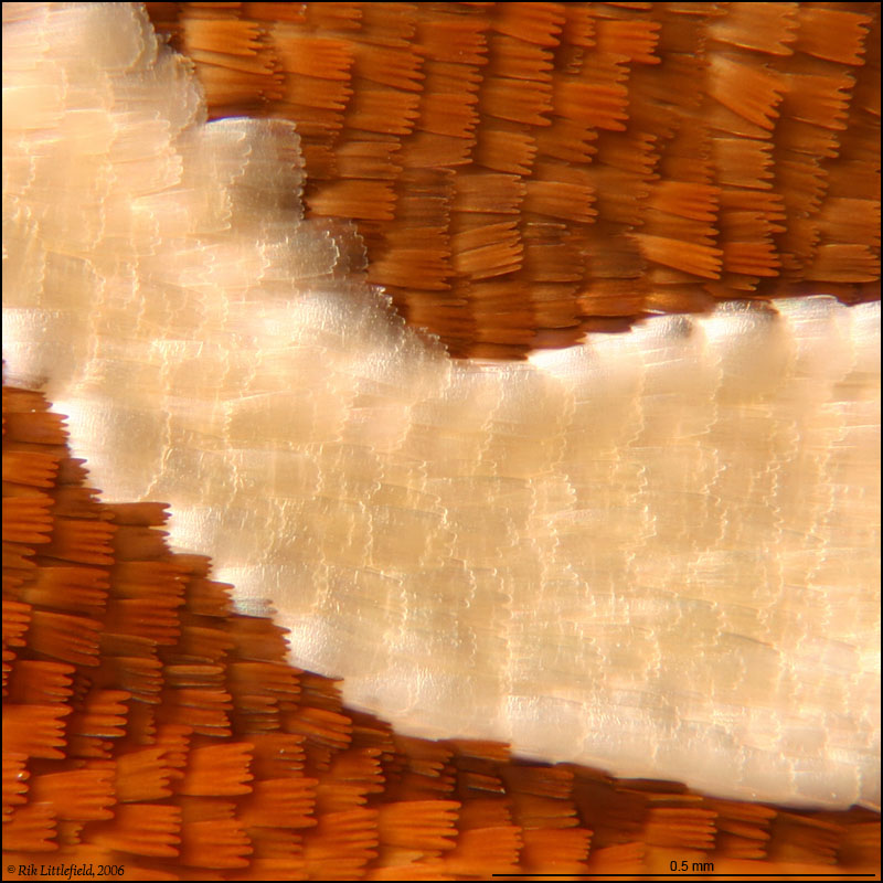

Canon 300D, 10X NA 0.25 microscope objective, 50% of actual pixels, stacked at 0.00033".
At the higher magnification, we can see pretty clearly what's going on. The satin-textured "Y" mark is actually composed of many layers of individually almost transparent scales, lying very close together instead of coarsely shingled like the rest of the wing.

Amazing! These tilings are composed of stripes in fact. Transparent/white part looks like it was glued on the brown surface. I think I have a few photos of Anagrapha or Autographa moth. Must search my archives.

Very beautiful pictures RiK. It looks like natures artwork. I would assume that a stack of clear scales like that might reflect light in a different way that maybe we cannot see, but other moths or insects can see. Lets say it reflects the UV or infrared spectrum in some way our eyes would not see it but other animals might.....just thinking and it is very interesting

Thanks, guys! I was pretty pleased by how these came out -- I'm glad you like them too.
It's a good question whether the stack of clear scales looks like something other than "bright", in other wavelengths. I really don't have a clue, and no equipment to get one. The moths are pretty common. Perhaps someone with a good UV source & a UV-sensitive camera could check one out.
Certainly in some butterflies, there are obvious patterns in UV that are invisible to our eyes. The yellow Sulphurs (Colias) are famous for this, and you can find numerous articles by just Googling on "Colias UV patterns". As far as I can see on a quick scan, there's still a science debate about why the patterns might be there. One common proposal is that it's to help the butterflies distinguish their own kind from other Colias, but some studies have found there's a lot more variation between individuals than between species, which would argue to the contrary. Another mystery...
The link that DaveW posted is a good one. I especially like to see it make the point that while the upper side of a Morpho is blue from interference, the underside is patterned from pigments. Pigments really are a lot more common, though you might never guess that from all the press that interference gets! See my other post tonight for some more discussion & illustration of that aspect.
