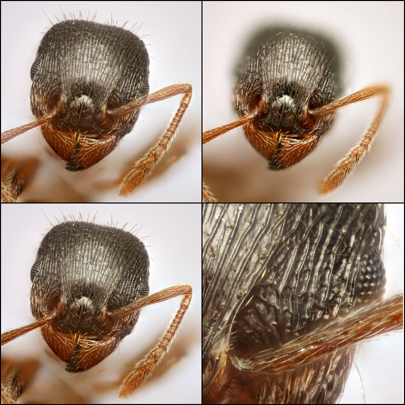

With apologies to Laurie's beautifully posed and lighted study, I set up a similar situation to experiment with methods to overcome bogus transparency.
The strategy shown here is simple: use TuFuse to render separately all of the frames and just the foreground stuff, then use Photoshop masking to manually fix up any places where background "shows through" foreground.
For this subject, the process turned out to be pretty straightforward: render twice, import to Photoshop with foreground over background, add a layer mask to hide the foreground-only image, then paint white on the mask with a soft brush to expose the antennae only from the foreground image.
Upper left, all frames, antennae apparently transparent over the eye and mandible;
upper right, foreground frames only, antenna properly opaque;
lower left, manually merged by masking; lower right, blowup of one problematic region after manual fixup.

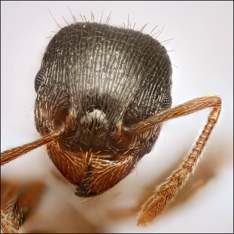

The final result:
I figure this technique might be helpful sometimes.
Perhaps some version of this could even be automated (though that always ends up being a lot harder than it sounds!). :)
Technical: Canon 300D camera, Nikon CF 10X NA 0.30 microscope objective, 124 frames stacked at 0.0002". Flash illumination with pingpong and tissue diffusers, 1.57 mm frame width.

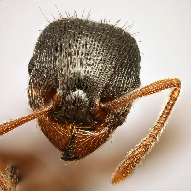

Posts: 24431
acerola wrote:It is interesting, that the second picture has more contrast. Is it tufuse creating better pictures with shorter stack or just post processing?
TuFuse creates better pictures with shorter stacks -- where "better" means that contrast/brightness are more like the in-focus pieces of the original frames.
Consider the limiting case: if you run a single frame through TuFuse, what comes out is just what went in. If you run two adjacent frames through TuFuse, what comes out has overall contrast and brightness very similar to what went in, but the details are merged. The more frames you run through at once, the more each pixel in the result is affected by overall differences in contrast & brightness due to the influence of varying OOF regions across all the frames. If you run through 50 or 100 frames at once, overall contrast will likely degrade while local contrast gets increased.
The depth-map and weighted-average algorithms currently used by CombineZM and Helicon Focus do not have this difficulty, since grossly OOF contributions are simply ignored.
This suggests that some sort of hybrid algorithm might work well -- use the multiresolution pyramid approach to merge details, but only from those images that plausibly contain details at each pixel position.
Developers may be working on this, but probably it will take a while to get the details right. After all, TuFuse traces its ancestry back to work done over 20 years ago.
But if you want to play with this idea in the meantime, you might consider something like this: Break your image into multiple overlapping slabs, say images 1-15, 8-22, 15-29, and so on. Run TuFuse on each slab independently. This will merge details within the slab without changing the overall brightness/contrast very much. Take the resulting images and feed them into CZ or HF to do the final merging, which will again be done without changing overall brightness & contrast very much.
This approach avoids some of the disadvantages of TuFuse, while at the same time retaining some of its important advantages. In particular many of the standard artifacts such as halo, lost bristles, and depth-map "swirly" effects can be significantly reduced or eliminated.
Shown below is an example of what can be made to come out. I choose these words carefully because I had to do quite a bit of playing around to get good parameter values. This is bleeding edge stuff and I don't recommend it yet, but I thought you'd be interested.
This is from TuFuse'ing groups of 15 frames with an overlap of 8 frames, then running CombineZM with a Do Stack macro modified to eliminate alignment, Find Detail 100,3,0, and skip the final sharpening and contrast adjustment. The result matches pretty closely what I see in the in-focus portions of individual images.
This image has had no manual editing, and post-processing is limited to levels adjustment and last-minute sharpening. I see some harsh halos around one antenna and around a few bristles near the top of the head. There is a small swirly transparency defect on one antenna, and a "flash" test shows that one bristle on a mandible got lost. But overall, this looks pretty good to me. ("Pretty good" is a moving target, of course. Four years ago this quality would have been jaw-dropping. :shock: )

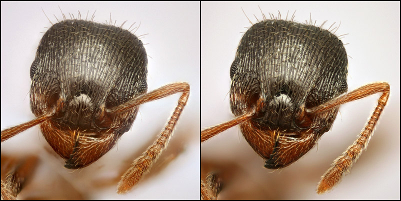

Here is another comparison that you may find interesting.
On the left is what comes from letting TuFuse handle all the frames at once (with a manual correction for the transparency artifact).
On the right is what comes from processing slabs of 15 frames in TuFuse, then doing the final merge with a modified CombineZM Do Stack as described above.
I have done a level adjust to match overall brightness as closely as I could do easily. I see I accidentally introduced a bit of color difference in that process too.
What I find most interesting in these two images is the obvious difference in handling of the extremely OOF background. TuFuse does a much better of identifying and preserving what "detail" there is in that area, despite its extreme fuzziness. This behavior is a nice feature of the pyramid algorithms, which essentially look for information at all scales simultaneously.
The light-colored diagonal stripe just under the mandibles is a legitimate feature, by the way. To keep the legs away from the head, I strapped them down with a strand of dental floss. I'm talking here about one of the micro-strands, diameter about 20 microns. You're seeing it here quite OOF, obviously. :)

So there is no additional Photoshop compositing going on - as indicated in the initial post when using the TuFuse slab stack approach ?
Craig
Posts: 24431
Correct. In the large image two posts above here, the one generated with numerous 15-frame slabs, I did no manual editing of the pixels. The lack of transparency in that case is due to the combination that (a) on average the antennae have somewhat stronger detail than the face behind them, and (b) I was able to tune the Find Detail parameters to lock onto the antenna detail and ignore the face. The tuning was time-consuming and undoubtedly specific to this image. In other cases, I expect it would be necessary (or at least faster!) to manually edit the merging of various slabs, similar to the foreground/background two-slab approach used in the initial post.
