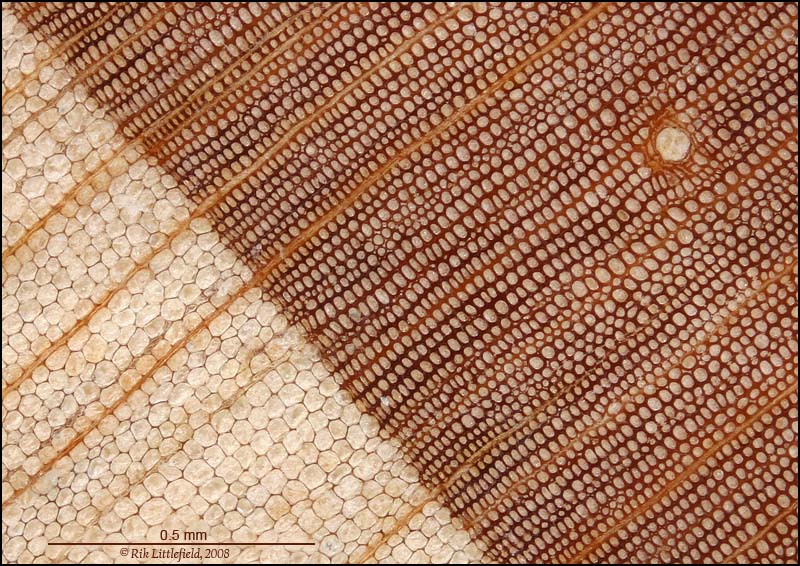

I was testing a new lens tonight, and rather than use the traditional moth wing, I thought I'd try something a little different.

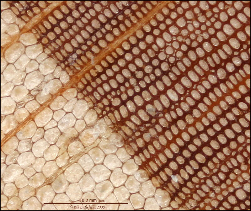

This is end grain from a chunk of scrap wood, perhaps one of the local evergreens though I'm unclear about that. We're looking at part of a single tree ring, with the dark-colored summer wood at upper right and the lighter wood from next spring at lower left. The narrow bands slanting from upper right to lower left are radial rays, running perpendicular to the main rings.
Individual cells of the wood are clearly visible, and it's obvious what makes the ring structure: summer wood has small cells with thick walls while spring wood has larger cells with thinner walls.
The light regions between the cell walls are cell interiors. They are empty space in dried bulk wood but have been filled with sanding debris at the surface as I prepared the specimen.
I actually tried several different procedures, using various materials to impregnate the wood and fill the pores before sanding it. None of them gave the effect I wanted. In the end, what worked best was the simplest imaginable treatment: none! #-o So what you're seeing is just dry wood, sanded smooth with a progression of finer papers culminating in 1200 grit.
The lens is very nice -- sharp almost corner to corner and no CA that I can see. (Thanks for the tip, Charlie!)
I thought the pictures ended up pretty attractive and interesting also. Hope they sit well with you too! :D
Technical: Canon 300D with Nikon CF N Plan Achro 10X NA 0.30 objective on 150 mm extension. Top image is about 70% of full field, rescaled to 800 pixels; bottom image is actual pixels. Stacked at 0.0002" to work around slightly imperfect alignment of the subject.

Rik,
That is intriguing and interesting. There appears to be a smiling face in the first image. Wonder what caused that characteristic - top right, just where it should be for composition.
I can't stop looking at the lines - mesmerised. Such a distinction between spring and summer. Great subject.
If you still have the subject in place, how does the CF compare to the OM20 at 150mm extension? Does the OM20 begin to lose clarity at a certain point with regard to extension.
Craig
Posts: 23616
augusthouse wrote:That is intriguing and interesting. There appears to be a smiling face in the first image. Wonder what caused that characteristic - top right, just where it should be for composition.
That's a hollow vessel of some sort, not sure what kind. The smiling face is just how the sanding debris happened to pack in. I liked the vessel and the pattern around it, but I didn't notice the face until you mentioned it.
My OM20 doesn't begin to compare with a 10X microscope objective. See previous comparison shown here. This newer lens has central resolution that's very similar to the 10X NA 0.25 illustrated there, but the older lens has a smaller and more curved field, with noticeable CA.

Rik,
I want this on canvas and on my wall!
Craig
Very impressive! Good subject well-executed.
This is impressive and very interesting. Wonder what I could do with the stereomicroscope, good project for today since it is raining out. :D

Rik,
Yet another superb image. The contrast and the patterns were stunning.
I am fascinated with the patterns in nature and, especially, in woods. One of my back-burner projects is trying to section wood samples for viewing with the microscope.

Rik,
It is going to look great stretched on canvas and floating over a charcoal backing-board.
I showed the image to a few people. All were intrigued and I asked them to guess what they were looking at -they all had various interesting answers - and then I told them what it was and the actual size - while their jaw-dropped I was then able to go on and explain other aspects of it's 'story' as outlined in your post in regard to spring and summer... The smiling face completed the event. To me this is what it is all about and the reason why I originally became interested in photomacrography.

Well I'm not worried about what was used, but this is pure magic to see timber cells at this scale. Seen quite a few shots when I was going through an apprenticeship, but these are simply the best I've ever seen Rik. The most I remember was that parenchyma cells held the sugar...........I think :D . I might have to do a google on it now.
Anyway, outstanding shots, exceptional lighting and very interesting from my point of view. Fascinating thanks.

Gosh, it's quite an accolade when even the wood workers think the wood works! Thanks, guys. :D
I'm almost afraid to polish up another piece, though, for fear the second one won't work as well as the first. :roll: Ah, but that never stops the movie-makers, guess I won't let it stop me either. :wink:

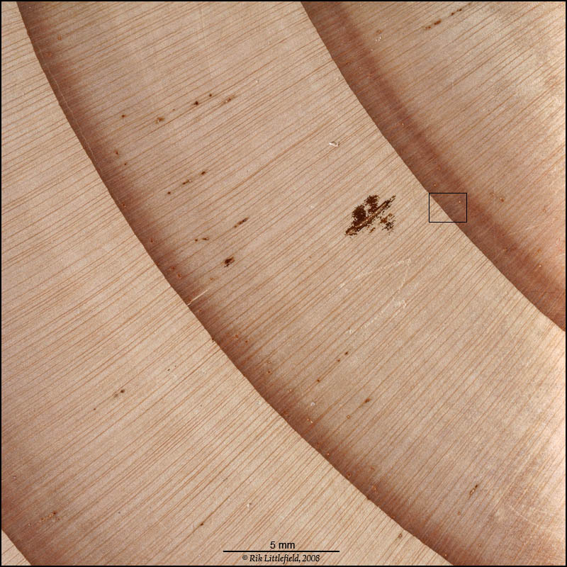

After several confusing conversations on the subject of wood grain -- a couple of them with myself! -- I realized I needed to provide some more information to better explain the high magnification pictures that started off this topic.
What's shown here is an wider view of the wood around the earlier photos. The area outlined in black, at upper right, is what's covered by the first photo.
Hopefully this larger picture makes clear that the direction of growth is from upper right to lower left.
The transition from "spring wood" to "summer wood" is actually quite gradual, and is not what is shown in the first photo.
Instead, the first photo shows the end of one summer's wood, and the start of next spring's wood. That transition is very sharp, and corresponds to the times when the tree went dormant in the fall and started up again several months later.
I hope this is more clear -- at least now I understand it better! :D
I've tweaked up the text in the first posting to give a better explanation.
