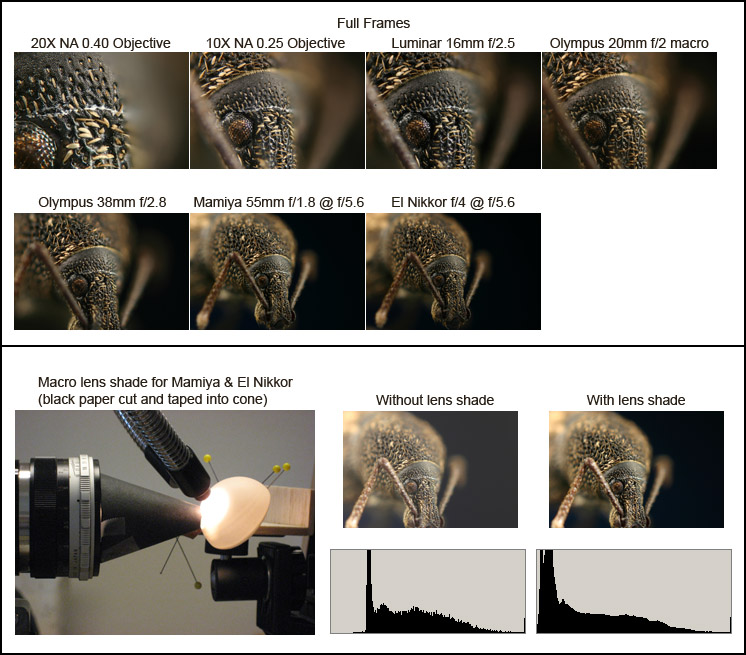

Test subject was the snout beetle face that I had previously posted.
Lighting was fiber optic halogen, with a pingpong ball diffuser.
I tested seven different lenses:
  • El Nikkor 50mm f/4 enlarging lens, reversed
  • Mamiya Sekor 55mm f/1.8 lens from 35mm film SLR, reversed
  • Olympus 38mm f/2.8 bellows macro lens
  • Olympus 20mm f/2 bellows macro lens
  • Zeiss Luminar 16mm f/2.5 macro lens (looks just like a microscope objective with an aperture ring)
  • aus JENA 10X NA 0.25 microscope objective (effectively 14.5mm f/2)
  • Edmund 20X NA 0.40 microscope objective (effectively 7.6mm f/1.25)
Due to the large range of focal lengths, I could not set up to get exactly the same field size (magnification) with each lens. So instead, I set up to get as close to the same magnification as I could without moving outside the lens' design parameters.
For lenses with variable apertures, I shot a series of single frames stepping aperture over each lens's full range. From those, I picked the aperture giving highest resolution, to use for stacking.
Along the way, I noticed that a couple of my lenses seemed to have a lot of flare when used without a macro lens shade, so I made one of those. It helped a lot.
Here are some pictures that summarize the results.
First, full frames illustrating the field size for each lens test. You can figure out the magnifications yourself, from the scale bar in earlier post. This image also shows the macro lens shade and its effect. You can see from the Photoshop histograms that without the shade, all the dark tones suffer pretty badly from stray light

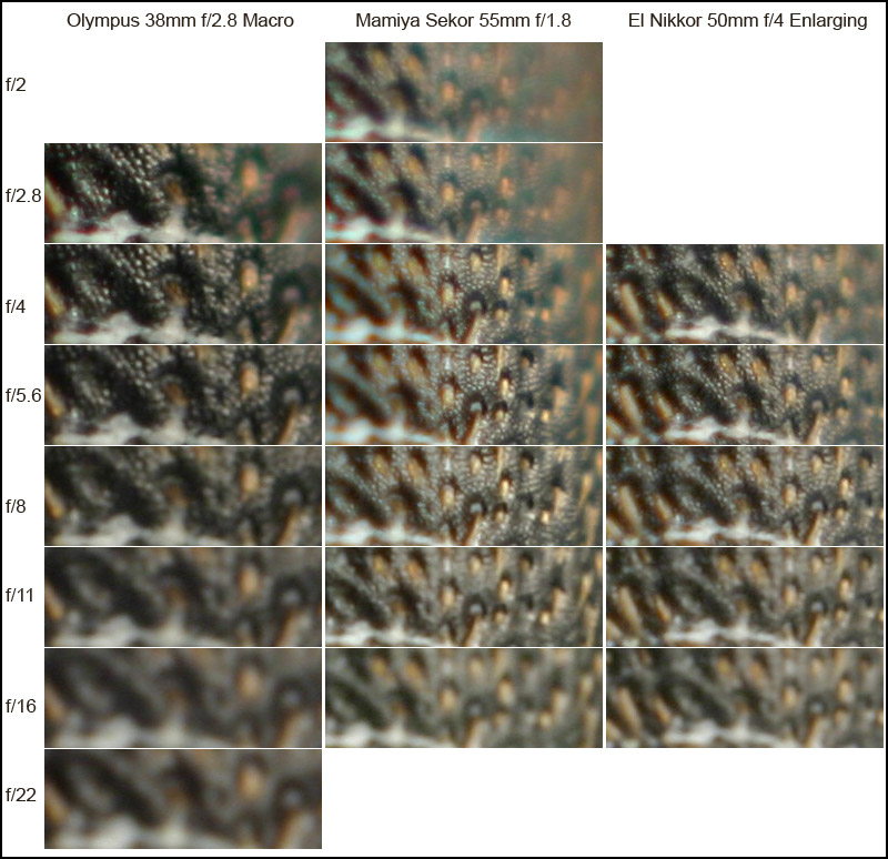

Second, here are some illustrations of what happens as various lenses get stopped down.
All of the lenses have lousy resolution when stopped down too far, mostly due to diffraction. But they vary in what happens at wider apertures.
The Mamiya lens in the middle is typical of what I find with "ordinary" lenses -- performance peaks around f/5.6 and falls off for wider apertures. There's also a significant shift in focus point over the first couple of f/stops, so it's a bad idea with this lens to focus wide open and then stop down to shoot. (I've seen the same effect with other lenses, including my Sigma 105mm macro.)
In contrast, the Olympus 38mm macro lens actually has highest resolution wide open at f/2.8, and starts to degrade noticeably at f/5.6.
By the way, it would be a mistake to compare across lenses from these pictures. These are actual pixels, but the magnifications are different.

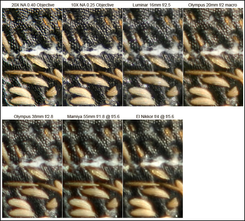

Finally, here is a direct comparison of center resolution from finely spaced stacks for all the lenses. What I've done here is to resize the result images so that they're all the same magnification. The Olympus 38mm image is just about actual pixels, and the others are scaled up or down to match. (There's a bit of detail lost in the 20X image, but I think the others keep everything that matters.)
So what's the bottom line?
Well, it depends...
At one extreme, we've got the standard microscope objectives. They give great resolution and they're pretty cheap, but they give very short working distance and the DOF per frame is so shallow that you have to shoot really deep stacks, which costs time and wears out your camera. At the other extreme, the Mamiya and El Nikkor lenses give great working distance and they're cheap too, but the resolution isn't quite up to the dedicated macro lenses and flare may be more of a problem. In the middle there are those dedicated macro lenses, which are real nice if you've got 'em, but they're fairly expensive and can be hard to find.
Note that center resolution doesn't tell the whole story either. Go very far off center, and some lenses start to lose resolution and pick up color fringes. The dedicated macros seem to shine in this regard, showing essentially no change in image quality across the whole frame (as shown by other tests, not these).

Carl_Constantine wrote:I would think that at F11 or F22, the depth and clarity would be better (though a significantly longer time to shoot) than the lens would be wide open, or even at F5.6.
That's a common belief, Carl, but it's completely wrong. (Not to worry, you're in good company! :D )
That why I keep harping about stacking being a good thing, if you can afford the limitations.
To get the sharpest image, you need to open your lens a lot farther than the standard recommendations for macro work. That's because the standard recommendations for macro work are based on balancing the effects of geometric blur and diffraction in one shot. Stacking lets you shift the balance and get the same DOF with a lot higher sharpness, in addition to the obvious possibility of getting a lot more DOF with the same sharpness.

What surprises me, in these results, is how much better the microscope objectives did than even the dedicated macro lenses.
According to theory, the resolution of a diffraction-limited lens system depends only on its effective aperture -- the angle of its entrance cone.
That theory predicts that an NA 0.25 microscope objective and a really good f/2 macro lens (at high magnification) would give pretty similar resolution, since NA 0.25 is very close to f/2.
Yet in these tests, an inexpensive objective (10X NA 0.25) gave much sharper images than two much-touted macro lenses of similar focal length and nominal aperture (Luminar 16mm f/2.5 and Olympus 20mm f/2).
Why would that be?
Reviewing the pictures this morning, I think I see one important clue. The full frames from these three lenses show similar magnification. But the blur of the background antenna is much wider for the objective than for the two macro lenses. That seems to indicate that the objective actually has a much larger effective aperture than the macro lenses, markings and calculations notwithstanding.
I'd be interested to hear your thoughts about this. If you see some mistake in my thinking or experimental procedures, please, let me know!
