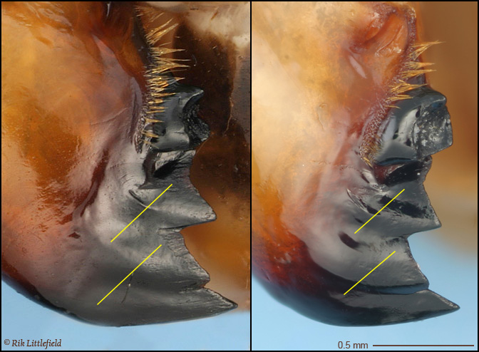

MacroLuv wrote:It looks sharp as a shark's tooth. :shock:
It sure does!
I did some follow-up study, and I was interested to find that some of that rough and rugged appearance is apparently due to wear.
Here is a side-by-side comparison.
On the left, one of the mandibles shown above, from a specimen that died of old age after eating its way through a mantis corpse.
On the right, the matching mandible from a different specimen, this one fresh from the pet store where I suppose it had only nice soft food to eat.
There is some overall difference in the surface texture, but what really catches my attention is the striking difference in what I assume are wear patterns -- the scratches and faceting along the direction of movement.
