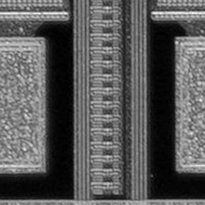

After seeing how well a loaner Lomo 3,7 performed in the 4X I recently ran, (thanks to zzffnn) I ordered a Lomo for myself, and I got it right before the weekend. Images from the new lens are great, CA free and sharp corner to corner on an APS-C sensor.
I had some free time and I couldn't resist comparing the Lomo to my MP-E 65 via a Sigma MC-11.
MPE at f/2.8.
Identical settings.
2 X Godox TT350 flash.
All manual settings on a Sony A6300.
MPE single frame, Lomo image is stacked.
Center:
Far left corner:
Left edge:
To my eyes the MP-E has a small lead in resolution but also has CAs. The Lomo is free of CAs and looks sharper in some areas thanks to the APO correction.
For larger images and more info follow this link to the Lomo 3.7x page on my site.
FYI, next week I am working on adding code to my site that will open the thumbnails at 100% view, not to fit the browser window was it does not.
https://www.closeuphotography.com/lomo-3-7x-objective
Questions and comments welcome.

I was having trouble seeing that the 65MPE was higher resolution vs the Lomo due to the high CA levels, so edited the corner comparison photos:
- cropped to an area that shows fine detail
- removed the R and B channels
- equalized the brightness
- output as monochrome and 200% size
- animated the two for pixel peeping
Indeed the 65MPE is showing a higher MTF on G channel. I guess this is mostly due to the f/13 effective vs f/17.
Would the 65MPE CA improve at f/3.3, or f/4?
RobertOToole
Joined: 17 Jan 2013
Posts: 599
Location: United States
PostPosted: Tue Dec 26, 2017 4:26 pm    Post subject: Reply with quote
The does make it easy to see a difference.
Thanks Ray.
With a bayer sensor, don't forget, there are 2X of the green photo-sites, compared to red and blue, that should have something to due with the increased contrast.
Yes, the MP-E CAs do improve at f/3.5 or 4 at this magnification, but the sharpness drops. Next time I run the MPE I will include the stopped down apertures.
All the best,
Robert

ray_parkhurst
Joined: 20 Nov 2010
Posts: 1186
PostPosted: Tue Dec 26, 2017 9:17 pm    Post subject: Reply with quote
Looking at just G channel is good for assessing resolution, since each pixel site is more fully covered and the G wavelength is in the middle of the visible spectrum. I did the same color processing to images from both lenses so this should be a good comparison.
