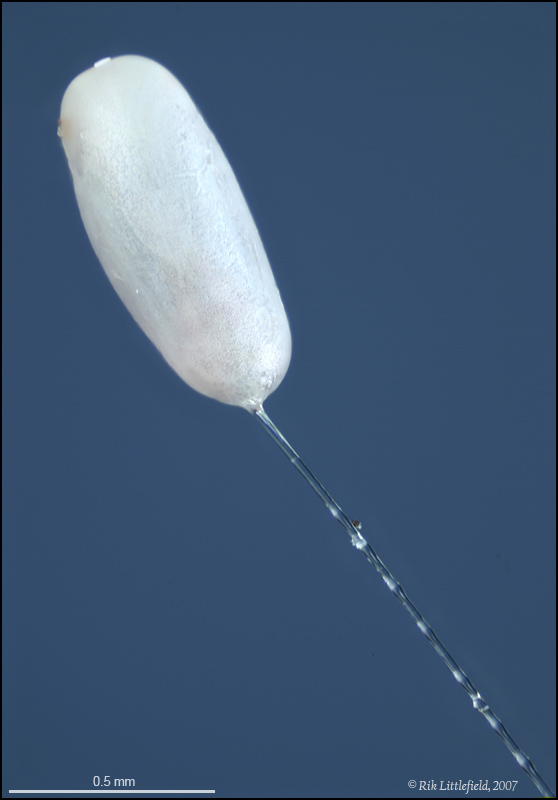

I've been keeping an eye on these things for a couple of days, finally took time to shoot one. I think it's just about ready to hatch -- if I play my stack like a movie, there seems to be something big and fuzzy moving around inside. :shock:
The stalk of these things is silk, or at least so says "Life in the Undergrowth".
What I did not appreciate is that the stalk is also covered in some nonvolatile liquid. That's what makes the beaded appearance that you can see here.
I suppose the liquid is there to further discourage things that might like to eat the egg.
My first thought was "glue", like on a spider's web. But actually its consistency is more like thin oil -- fairly low viscosity and it didn't pull out into streamers at all. I have no idea what it is, chemically. :?
Technical: Canon 300D, 10X NA 0.25 microscope objective on 160mm extension, 65 frames stacked at 0.00025". Dual fiber halogen illuminator with ping-pong ball diffusers, one from above and in front, the other below and behind (backlit). Custom white balanced on the illumination. PTLens'd to remove CA.
I had some trouble getting this stack to process well, and there's still a bit of "stacking mush". There is so little contrast in the texture of the egg that I had to pre-sharpen before running Helicon Focus, even with R=20. "Presharpen" means that I used Photoshop batch automation to process each of the source images: resize to 70%, then USM by 60% at 1.5 pixels.

Really racking up the points this week Rik. Another excellent photo.

Great! Rik, you have done a superb job again. Thanks for sharing and for the technical info.

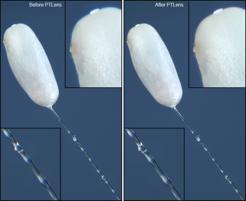

For a comparison I would be interested in seeing the pic before CA removal, IYDM.
Thanks in advance! :D :wink:

Impressive technical performance here (using the "custom" lens, using stacking, follow-up with PTL) to produce a pleasing picture of something very interesting.

I like the simplicity of it and the contrast between the subject and the background. Nicely done.

Planapo wrote:For a comparison I would be interested in seeing the pic before CA removal, IYDM.
To make the comparison easy...
