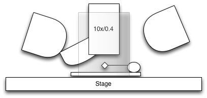

With only 3mm of working distance I am curious, how did you illuminated these?
Charles Krebs wrote:Waldo,
Excellent work!
I used this:
Very unsophisticated. Basically three Ikea lamps to the back, left and right of the objective. The objective is wrapped inside a paper cylinder (shaded image). This extends to below the subject.
It is very hard to work like this because I cannot see anything. My first subject was bumped off the pin because I drove the objective into the pin :(
PS: Exposure times were ISO200 and 1/8 so long exposures were needed.
