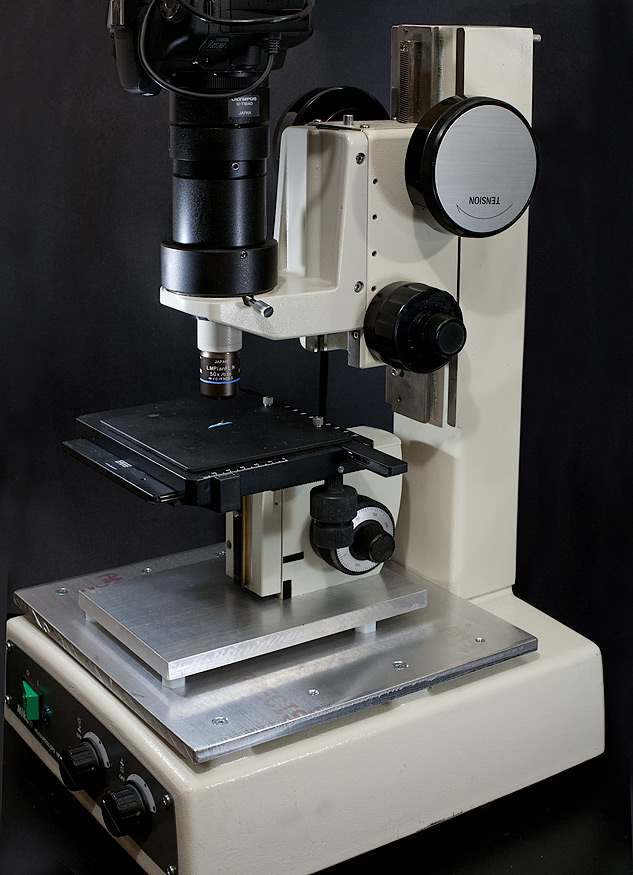

In a recent post I had Rik a little stumped as to how I maintained my sanity working with three objectives having three very different parfocal distances (Olympus:45mm, Nikon:60mm and Mitutoyo:95mm) on the same microscope. It's pretty easy to understand once you see how the Nikon MM-11 microscope is made. The key is the very substantial and lengthy 3rd focus movement on the pillar upright (the big knob in the pictures below).
While I do have a 5 objective nosepiece for this, I really prefer using a single place nosepiece. (I would not put objectives with such different parfocal distances on the same nosepiece anyway, but the single place nosepiece is very nice to use as it allows maximum access to the subject and avoids unused objectives getting in the way of lighting paraphernalia. (And coupled with the large range of vertical adjustment, makes the different parfocal distances a non-issue.)
While this is still a "work-in-progress" it is quite functional and a real pleasure to use. It is outfitted with an Olympus U-TLU (180mm tube lens unit) and an Olympus U-TMAD (hollow adapter that takes a regular T-mount). The upper Olympus dovetail mount is a little smaller than the Nikon one, so I was able to shim it up a little to attach and center the Olympus pieces on the Nikon stand. I've got some nifty plans to change this upper arrangement but this will do for the time being. The only frustration is that the camera can't be readily rotated.. but that will be remedied!

Nice beast!, Charles.

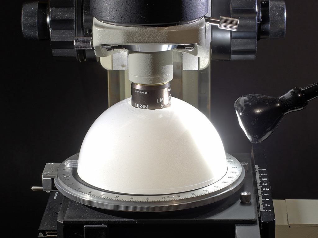

In the second picture I recognise a focusing block from a Zeiss Standard (inverted?). A Zeiss rotatable stage widely available may prevent the need to rotate the camera.

Charles,
That is a beauty! Shocked
For the camera rotation you can use a Baader "T-2 Quick Change System":
http://www.alpineastro.com/eyepiece_adapters/eyepiece_adapters.htm#Quick Change
PostPosted: Fri Jul 27, 2012 12:03 pm    Post subject: Reply with quote
Pau,
Good eye!... yes that is an old Zeiss stage/focus mechanism. I have made up a variety of top "plates" that I attach via the two thumbscrews that normally hold the slide "fingers". One includes a rotating platform. It is nice as long as you establish the orientation before you establish the lighting effect. If the lighting has already been established, and you then decide you need to re-orient (rotate) the subject it can change the lighting effect as seen of the subject. In this case a rotating camera is better. Eventually I would like to have both options.
Rogelio,
I've been very pleased with the rotating mechanism made up from 2 inch "astonomy" visual backs on my BH2. So as you suggest, I'll do something similar here. Instead of the U-TLU I want to put an Olympus super-widefield trinocular head on top with direct projection onto a "rotatable" APS-C body. As nice as it is to use live-view on the camera LCD or an external monitor, I still prefer viewing a subject through a good pair of eyepieces, especially when "scouting" a subject for a good picture.

Your photos of the MM-11 adaptation are crisp and helpful, but I don't understand the larger-diameter component that you're showing at the bottom of your U-TLU / U-TV1X / U-TMAD / T-mount stack that actually attaches to the Nikon dovetail... Is this an Olympus part, or is this something you had made up?
As an aside, for those who might be wishing to emulate this very stable set-up to make a vertical stacking rig, these Nikon toolmaker's microscope stands have been coming up on eBay rebranded as "ADE Phase Shift MicroXAM" units that were the basis for a special-purpose surface profiler. It's pretty straightforward to return them to a more stock Nikon spec and appearance. Three days ago a complete example sold for 102.50!
PostPosted: Mon Jan 14, 2013 2:03 pm    Post subject: Reply with quote
Apo,
Good eye! Wink
That is a simple hollow Olympus tube (U-EPA) that is normally used to raise the viewing head if needed for more comfortable observation. It is not necessary here. The reason I did include it is that I do not have a Nikon stand to Olympus BX adapter. The Nikon female dovetail on the microscope is larger, so I needed to attach some shims to the Olympus dovetail to get a tight, centered fit. I already had a couple of these inexpensive U-EPA tubes, so I decided to work on the dovetail on one of these rather than possibly mess up the dovetail at the bottom of the much more expensive U-TLU component.

For some time now this MM-11 has been completed the way I had initially intended (mostly... one is never really done tweaking these things Wink ).
These pictures are to update the project.
The big change from the initial pictures is the replacement of the Olympus U-TLU tube lens and the Olympus U-TV1X adapter. In their place an Olympus U-SWTR-3 super-widefield trinocular head was added. (The 180mm tube lens is built into this head). On top of the trinocular head a camera adapter was made up from "astronomical" components. This adapter allows for smooth 360 degree camera rotation, and was made so that the camera is parfocal with the viewing eyepieces.
The eyepieces on this trinocular head have a field number of 26.5 mm. The diagonal of the Canon sensor I use is 27.3mm so the "fit" is pretty good.
Directly under the trinocular head is a piece made by Leeds Precision Instruments, Inc., the LBX-100 (flat, "rectangular" piece). This has Olympus BX dovetails top and bottom and provides a slot for polarizing or other filters. Leeds at one time made quite a few unique custom parts for Olympus BH/BX microscopes. They no longer market or show these items on their web site, but I think they still have some "old stock" for a few of these pieces. Here is an old catalog:
www.krebsmicro.com/pdf/LEEDS_LPI_CA_Cat.pdf
The round "spacer" under the Leeds part allows me to go from Nikon dovetail to the Olympus BX dovetail.
This is the 5 place RMS nosepiece (Nikon) with some Olympus MPLFLN objectives. Sometimes I will only use two or three objectives in the turret if I need more room to work with certain diffusers or reflectors. There is also the single place nosepiece that can be used with the Olympus or Mitutoyo (with RMS adapter). If I know exactly what I am after and do not need to survey the subject at different magnifications this nosepiece allows the most freedom and clearance for diffusers, reflectors and lighting.
