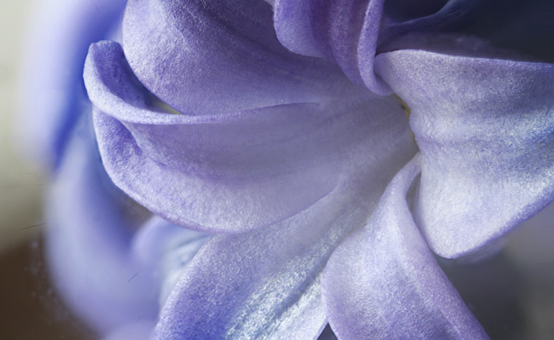

Ok I tried implementing your suggestions on a new series since there was a number of problems I found with the first shot (ie: no lens shade, and areas of missing focus because too shallow DOF).
Except for the better DOF, I can't say its processing any better then before. Its very strange, it seems like the program is washing out the shadow areas with the "unfocused" parts of the earlier frames. I'm processing from the back forward, which I think is the proper order...
To get around it I spent about 2 hours painting back in lost data, which brings up another problem = Is there a way to save a project in HF so that you can go back and edit the frames later? When I go to save all I get are standard outputs, and opening one of those does not bring up the edit tab (or whatever its called).
Again I'm at work w/o the new image, but a early version can be had in the gallery: http://www.photomacrography.net/forum/v ... php?t=1711
New setup:
F5.6 @ 3/8mm
Contrast Adjustment before stacking
HF: 17/2
HF Edit: 2 hours re-editing back in the lost detail
Thank you for all your help.
New setup:
F5.6 @ 3/8mm
HF: 17/2

I'm saddened to hear that you're still having problems.
For what it's worth, I've come to think of these stacking programs (and most other software) as being like trained animals. Most of the time they do something close to what you want. But it's seldom exactly right. Sometimes they do something completely weird, for no obvious reason. And if you want them to do something different, the retraining process can be long and uncertain. The best way to get good results is to figure out what the animal wants, and give it to them. <wry grin>
What HF really wants is small, crisp detail at a contrast level that's well above noise.
If by "Contrast Adjustment", you mean levels & curves, that won't help much because they don't change the detail-to-noise ratio.
What's needed is more like unsharp mask with a radius and amount chosen to bring out detail in the subject while not affecting the noise too much. With the reduced size test stack you posted, I got encouraging results (very much like Charlie's) using radius 2 pixels at 50%.
Front-to-back versus back-to-front makes no difference except for the size of image you get. Once I even scrambled a bunch of file names to randomize the order of processing. (The stack was already aligned so I could turn off auto-adjustment.) Literally all the randomization did was to change the bottom bit in some pixels. I attributed that to just arithmetic rounding.
About saving the project so that you can go back and edit -- nope, I don't know any way to do that. If you find one, please let me know too. Seems like I'm always finding something I'd like to tweak.
PS. One more hint is to shoot at the very lowest ISO you can afford. That reduces the noise & makes it easier for stacking software to pick out detail in the subject.
