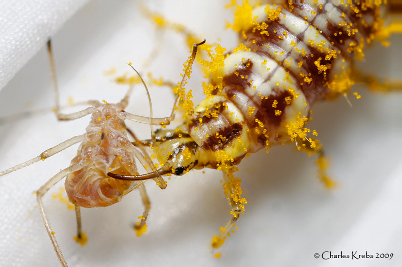

I watched a couple of these larvae actively hunting in the central disk of some daisies. They were so covered with pollen that at first I could not identify them. On occasion they would walk up and down the length of a petal looking for a meal, where this one found an aphid. Sucked it dry in about 3 or 4 minutes!
It was quite breezy out, so it was nearly impossible to focus. I carefully picked the flower and set it down on an outdoor table.
This was photographed at a little over 3:1 with the Canon 65mm MPE. For DOF purposes I was only able to get two shots where it was relatively still. Those two were stacked in ZS.
Green lacewing larva (Chrysopa sp.) with aphid

Paul,
Extremely low-tech
Nothing more than a piece of white paper held atop a hot-shoe mounted flash to bounce enough light onto the subject. I used an aperture of f6.4 (which would make the effective aperture somewhere near f26) and an ISO of 200. The 65mm MPE was tripod mounted on the Novoflex focusing rail that I normally use with this lens.
The 65mm MPE is a tricky one to light effectively with a "mounted" flash, because of the short working distance, the diameter of the front of the lens, and the degree to which it extends when focused closely. The Canon MT-24EX and Macro Ring Lite MR-14EX are the easiest solutions since they attach to the front and move with the lens as it extends. One "downside" is that they are expensive. Another "downside" is that they position the light source very close to the subject, which can make the "depth-of-even-illumination" very shallow. Depending on the subject and composition, this might result in "bright" objects in the foreground, and/or rapid darkening as objects get more distant.
Overall I was pleasantly surprised by the result using this low-tech solution. (Not too useful for verticals though )

Why not just have your paper rubberbanded on the side of the flash - which is now the top surface ? Another quick'n'easy one I thought of while sitting on a bumpy commuter flight recently was to use a white barf bag banded to the flash to form a tube and cut out a window over where your subject would be. Haven't tried it though ...Charles Krebs wrote:(Not too useful for verticals though )

Thanks, Charlie for taking the time to post details etc.
It reminded me of something similar I tried before making the macro arm that I use now - still with a 550ex too.
<< One "downside" is that they are expensive >>
Indeed - Have been tempted, but have resisted - and the 550 is fine for std photos too.
<< Not too useful for verticals though >>
True - but not a problem here, since my macro rig includes a landscape / portrait 'flipper'.
A good result though

They're small but they'll take on a person anyway, I learned! (HERE)Aynia wrote:Yikes.. looks very sharp indeed.. wouldn't want to mess with it.
