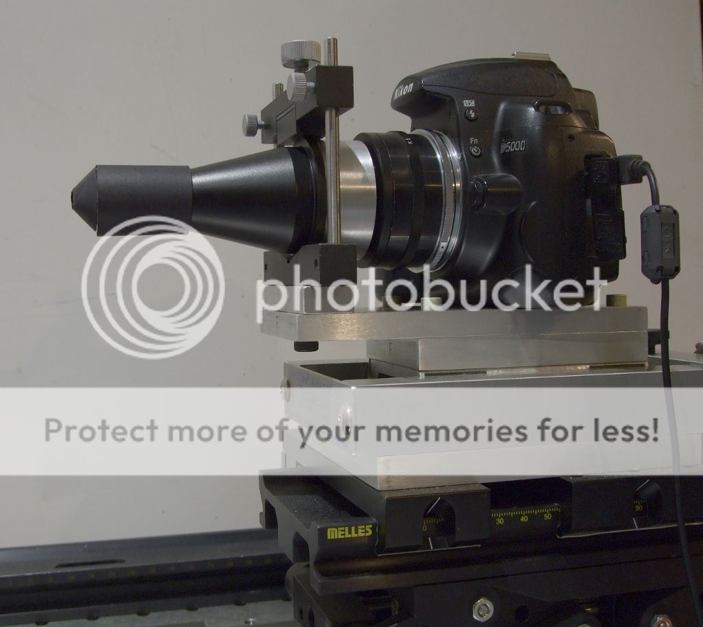

I'm just including a picture here so you can see what I have done. The cover doesn't affect the angle of illumination at all. The cone is actually glued to the end of the objective with some light glue. I don't know the technicalities of what is happening with the light, I'm just showing what I have seen, and the only difference between the two shots is that the first is with a chrome objective and the second it is black. The first image has a lot of flare around the design and in the second one this is greatly reduced. Also it looks to me like there is more blurring in the first shot in the OOF areas.
Let me illustrate what I meant.
Here is a picture of my CFN 10X NA 0.30 focused on a penny. I've annotated the picture to show three "families of angles", to use the notation of the Light Science & Magic book.
The gray section labeled "Excluded by aperture" is the region where no significant light can come from, because that's the glass that leads to the black hole of the camera.
The green section labeled "Always allowed" is the region where illumination can reach the subject without bouncing off the objective.
Neither of those is altered by your black paper.
What's affected by the black paper is the region I've labeled "Excluded by mask". That's the area from which light can reach the subject only by being reflected off the shiny end of the objective.
You've told us that adding the black paper reduces the exposure by 1 stop. That means about half the light is coming by reflection from the red region.
I hope it's obvious that the green region alone is narrower and farther off axis than the green+red regions combined, and that's what I mean when I say that the mask "is making the illumination more oblique".
