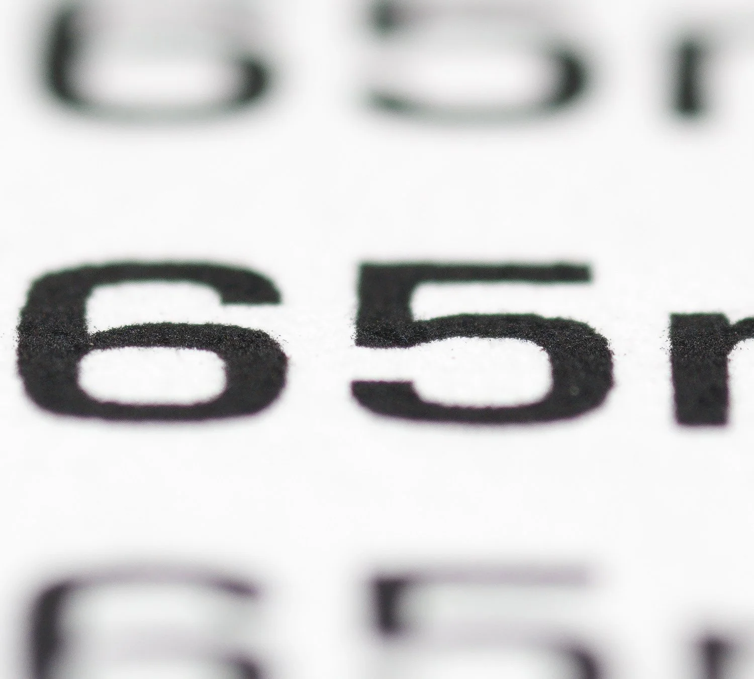

MPE
__center-100-percent-crop-Canon-65mm-MP-E-1-5x-Macro-lens-www-Closeuphotography-com.jpg

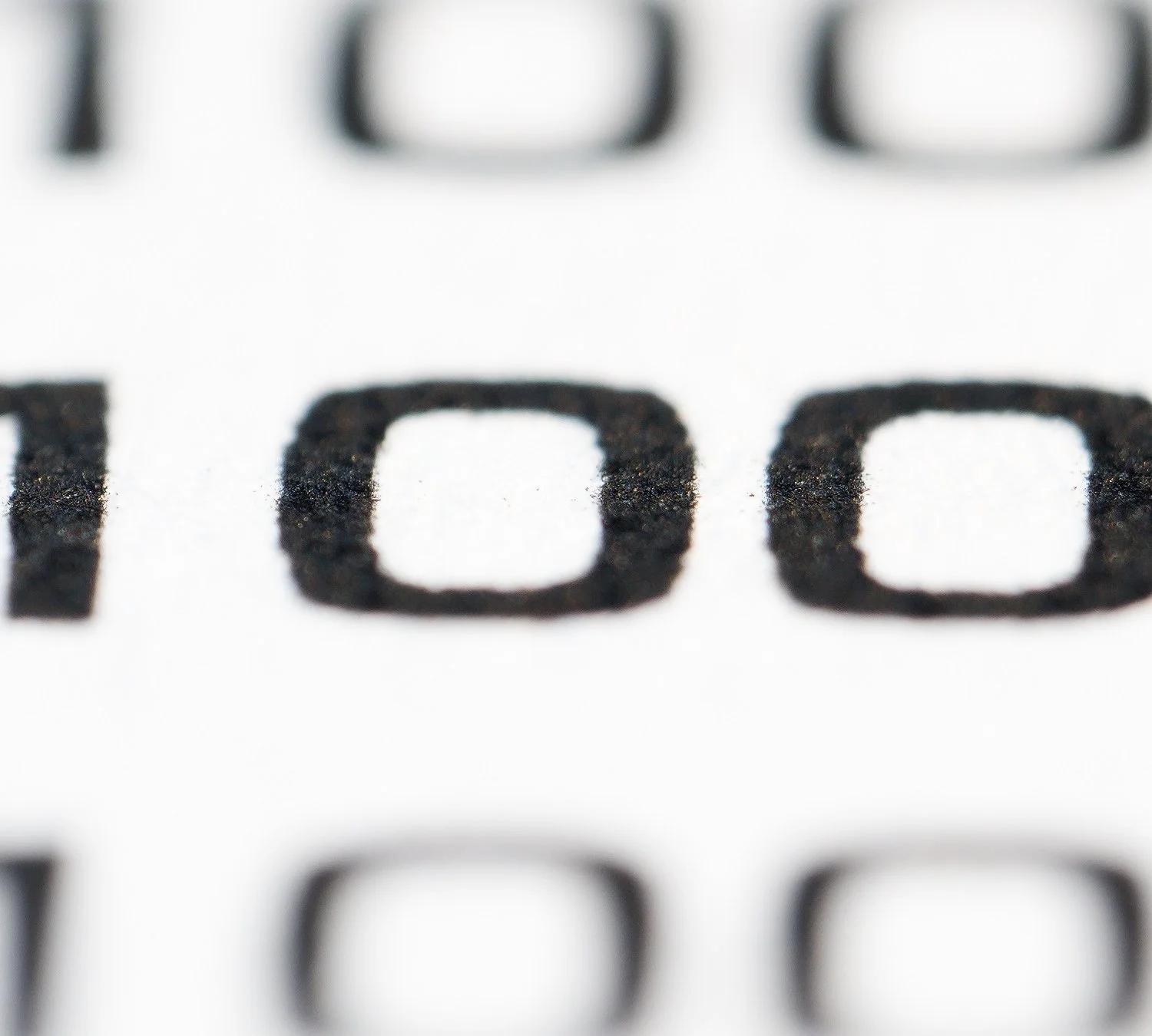

LA100
__center-100-percent-crop-Laowa-100mm-f2-8-APO-Ultra-Macro-APO-Macro-lens-www-Closeuphotography-com.jpg

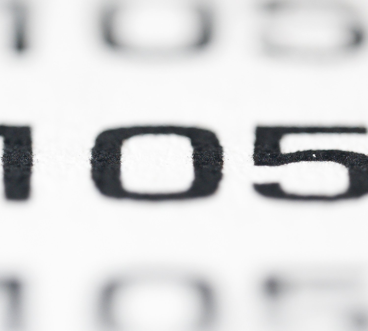

PN105A
__center-100-percent-crop-Nikon-Printing-Nikkor-105mm-f2.8A-www-Closeuphotography-com.jpg

1X LENS TEST SETUP
Canon MP-E 65mm 1-5x test aperture: f/4, effective f/8 at 1x
Laowa 100mm f2.8 APO Ultra Macro APO test aperture: f/4, effective f/8 at 1x
Nikon Printing-NIKKOR 105mm f2.8A test aperture: f/2.8, effective f/5.6 at 1x
Sigma Art 105mm F2.8 DG DN test aperture: f/4, effective f/8 at 1x

1X TEST FINAL RESULTS
Best Image Quality at 1X: Nikon Printing-NIKKOR 105mm f2.8A
Best Image Quality with Auto Focus at 1x: Sigma 105mm F2.8 DG DN Macro Art lens
Price vs Performance at 1X, no AF: Laowa 100mm f2-8 APO Ultra Macro APO Macro lens
Notes:
The PN105A is still as amazing as ever. Awesome image quality.
The Laowa IQ was a very nice surprise. I was so impressed I actually bought the test lens from the owner. The Sigma Art lens was also a nice surprise, it actually was better than all of the older Sigma macro lenses and maybe the most highly corrected and sharpest consumer lens I've ever used. The Sigma is the closet to a true APO consumer lens, but Sigma doesn't give the lens any gold or red rings or any APO tags!
Additional images, comments and details in the full test on my site: https://www.closeuphotography.com/1x-ma ... -test-2022

I was glad to see both the Laowa and Art lens just about LoCA free!
The Printing-NIKKOR lens looks like a mono (B&W) photo.

I have one question...the Laowa and Sigma lenses are f2.8 wide open but you tested them at f4. Was this done due to aberrations, coverage, or ??
RobertOToole
Posts: 2627
Joined: Thu Jan 17, 2013 9:34 pm
Location: United States
Re: 1x Magnification Test Online
Post by RobertOToole »
ray_parkhurst wrote:
Fri Jan 28, 2022 7:44 pm
Great test Robert!
Hi Ray,
Red fringing at wider apertures, so one stop down was best. That wafer I use is tons of contrast so the reds will glow on hard edges. Coverage was 100% fine on all the lenses.
Best,
