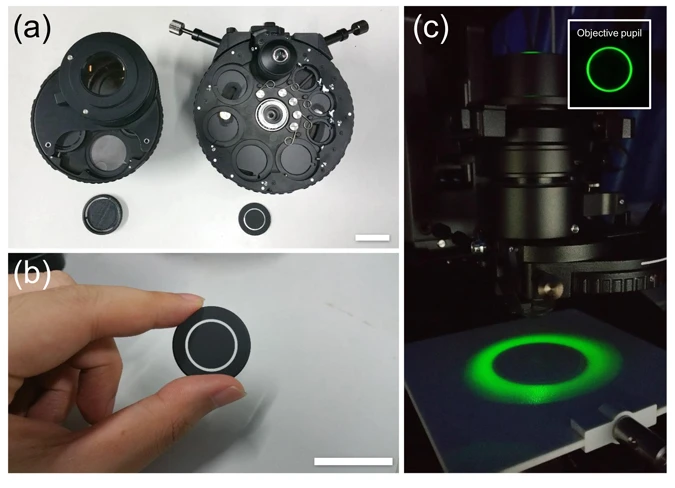

My condenser (U-UCD, neither the B nor 8, it's likely a renamed BH2-UCD) came with these weird things:
I was initially excited, thought I scored an absolute steal as it came with 4 DIC prisms. Looking at them now, they don't look like DIC prisms at all. Anyone has a clue? They sort of look like infrared bandpass/notch/high-pass filters because they are so dark, but a couple has this circular pattern on the optics.
Are they not simply ring apertures for phase contrast?
They look too dark though, I initially thought they were PH discs too.
It could be an angle and underexposure. I think you're right.
Still a good deal then. I can sell these rarer big PH discs off.
They should be for the BX ones. The other under the dry top is likely the darkfield ring.
Then they still look weird, maybe it's a DIY part... I thought those discs have 3 thin sections joining the concentric circles. Manufactures probably do this to make mass manufacturing easier.

Macro_Cosmos wrote:
Tue Sep 01, 2020 12:47 am
The condenser phase annuli were originally made from a photoresist layer on a glass disc (Zeiss, Leitz) and didn't have the three arms holding the centre. The newer ones are cut out from plastic (no doubt cutting costs as well) and need the three arms to hold the centre in place.
You can see a phase annulus like these in this study https://media.springernature.com/lw685/ ... pg?as=webp but it's not 100 % clear from the paper if it was custom-made.
"N" could mean narrow, "W" could mean wide, that would explain why there are two different annuli for 20x ... so maybe this is an experimental setup ...

Ichthyophthirius wrote:
Tue Sep 01, 2020 2:37 am
I've actually briefly skimped through this study as I was ravaging the net for a condenser, finding every obscure source I can land on. I just assumed their rings were DIY.
That explains a lot then, this UCD is definitely old. I really hope it's compatible with my DIC prisms that are also coming, or else I'll be pretty well... upset to say the least.
Do you have the diameter of these discs in mind? I want to experiment with a kind-of-DIY "UCD" setup and compare the results.
