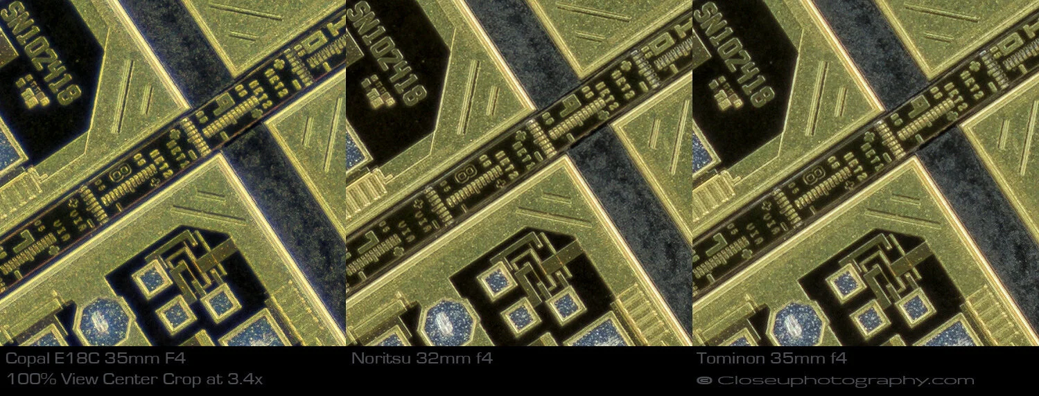

3.4X 100% VIEW CENTER CROPS: STACKED LENSES
Copal 35mm f4 E18C Printing Machine Lens
Noritsu 32mm f4 Printing Machine Lens
Tominon 35mm f/4.5 Copy Lens
Best: Noritsu 32mm

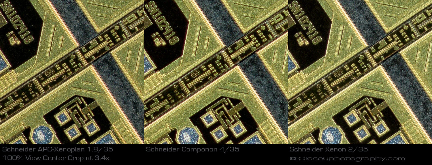

3.4X 100% VIEW CENTER CROPS: FAST STACKED LENSES
Schneider APO-Xenoplan 35mm f1.8 Industrial Lens
Schneider Componon 35mm f4 (f/2.2) Industrial Lens
Schneider Xenon 35mm f/2 Industrial Lens
Best: SK Componon and Xenon.

The Noritsu 32mm, the sleeper lens of the test, slow at f/4 but very consistent and zero CAs, and the Componon / Xenon were crisp clean and sharp edge to edge even at f/2.2!

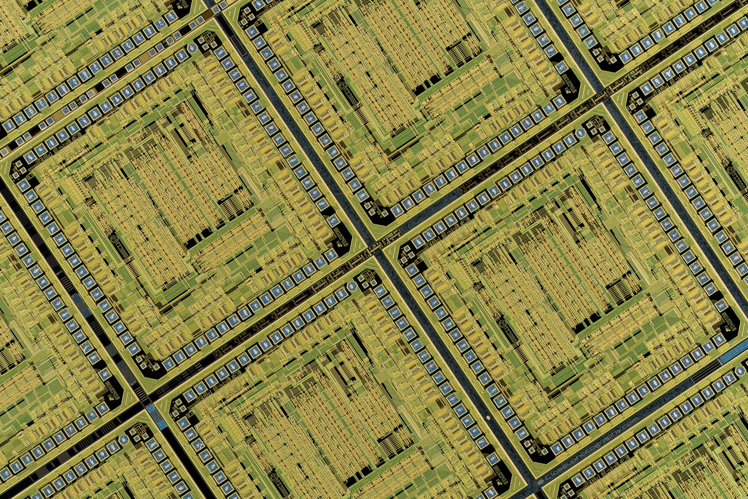

2500px size image with the SK Xenon:
