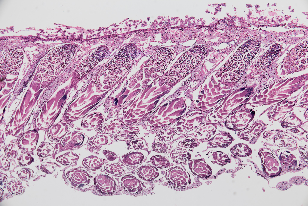

Grasshopper testicle, 4x*1.25*1.4xTC, BF, Canon 6D
Full Image
Grasshopper testicle, 4x*1.6, BF, DS-Ri2

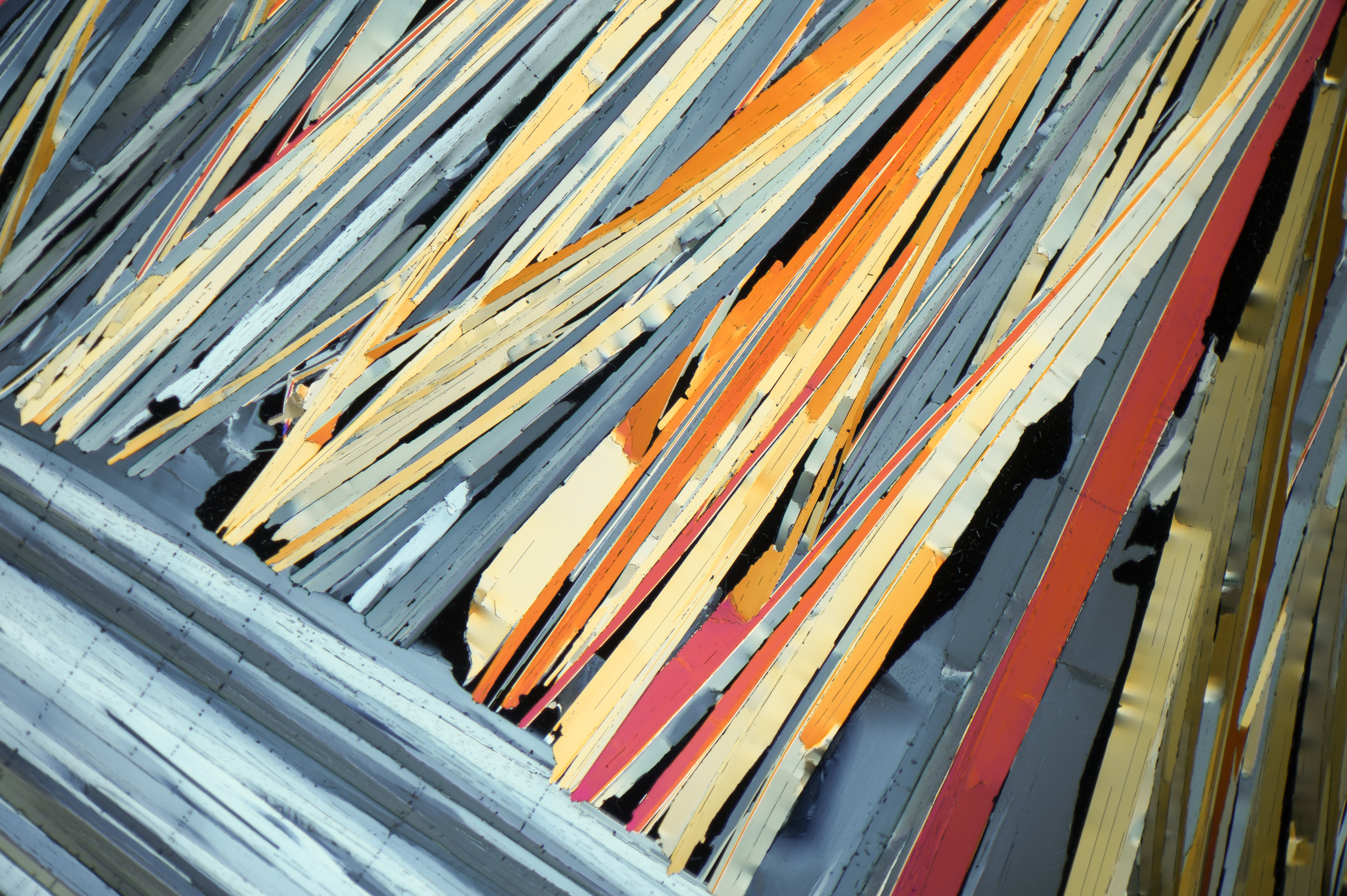

Benzoic acid melted, 10x, POL, Canon 350D
Full Image
Benzoic Acid melted, 10x*1.6, POL, DS-Ri2

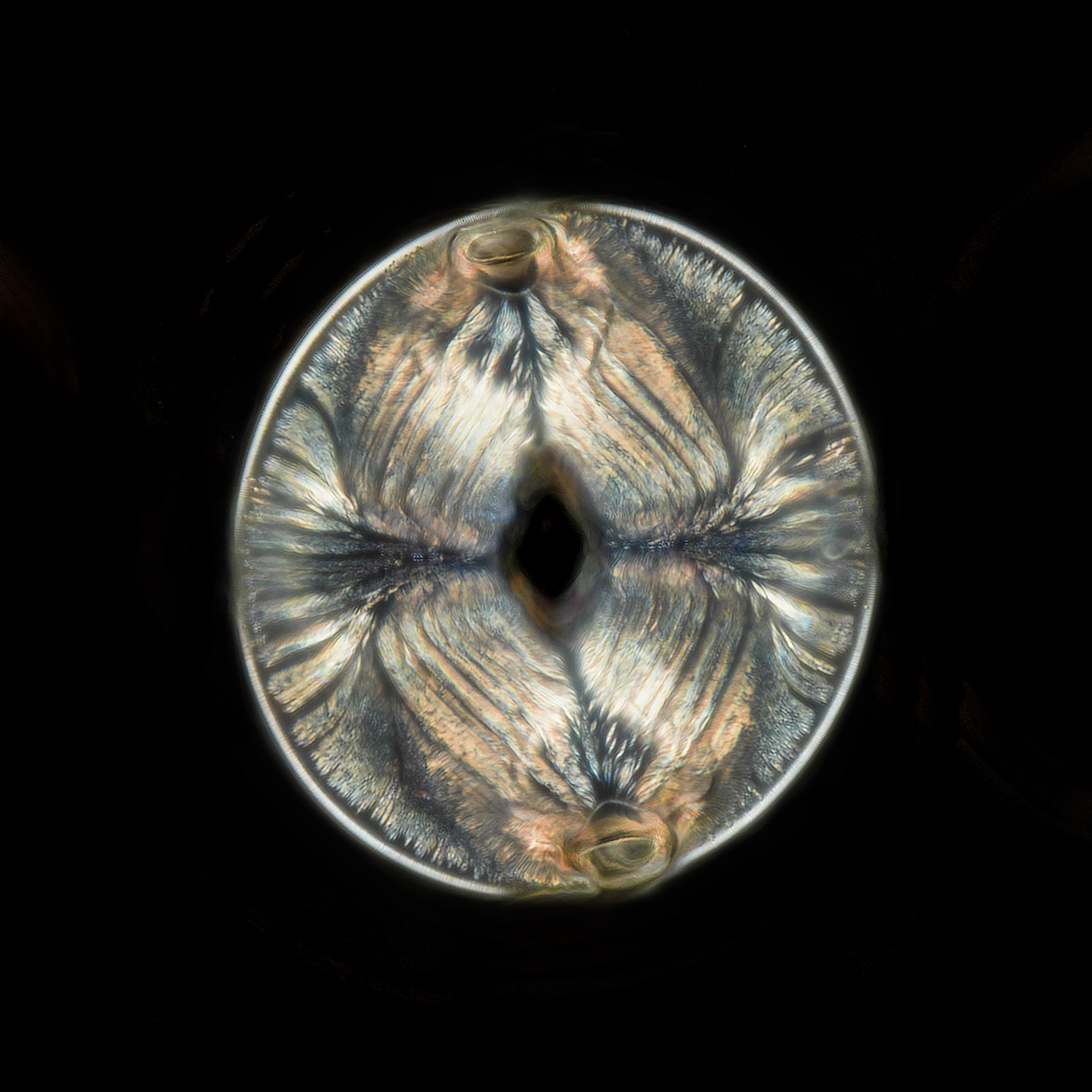

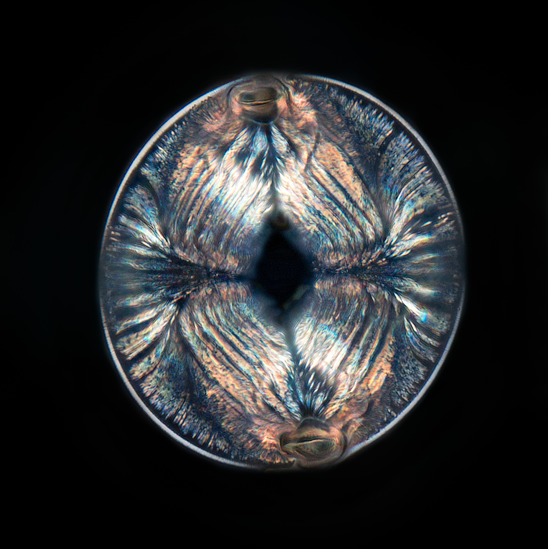

Diatoms, Oamaru N.Z., Auliscus oamaruensis, 40x, POL, HF B, Canon 350D
Full Image
Diatoms, Oamaru N.Z., Auliscus oamaruensis, 40x, POL, HF A, DS-Ri2

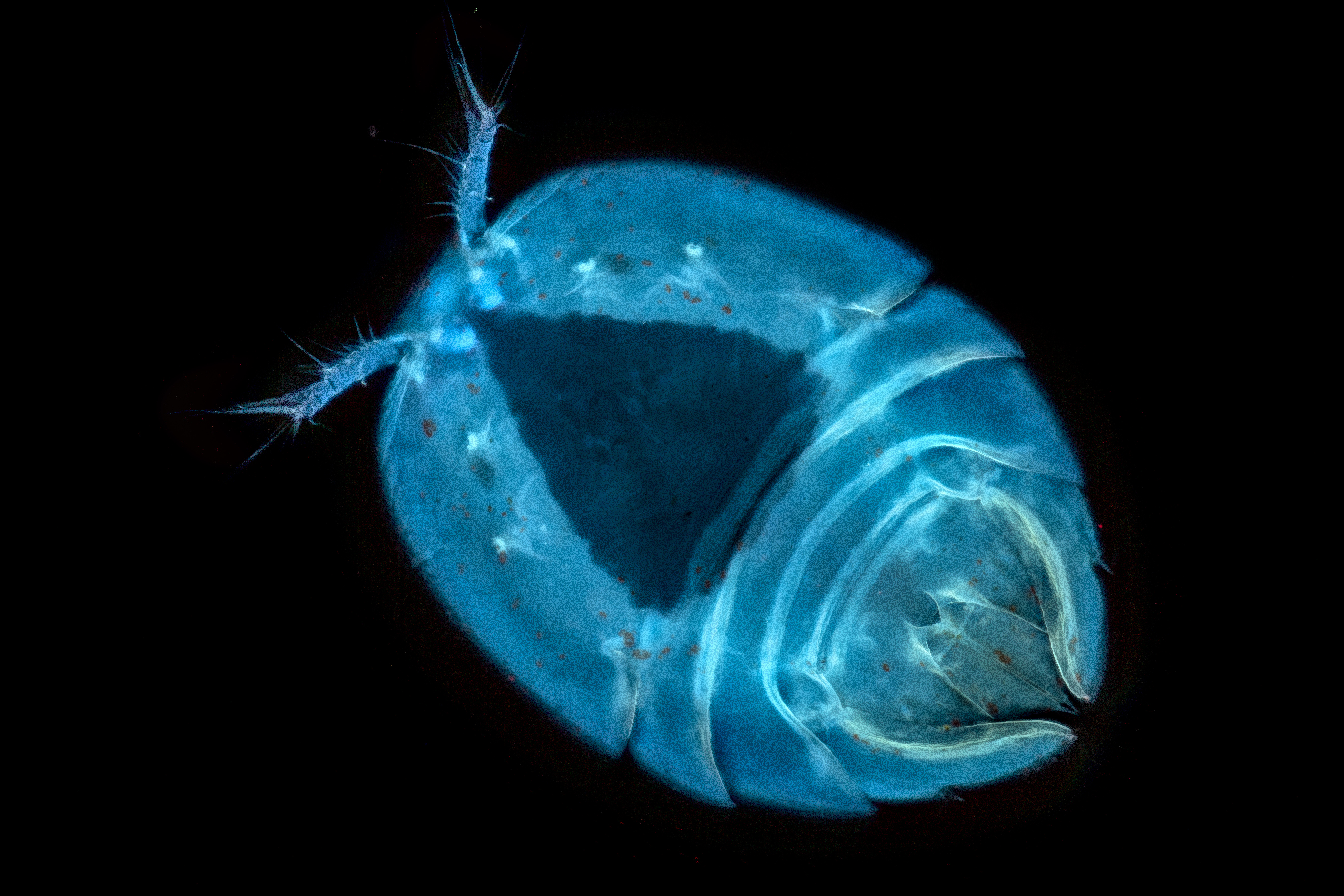

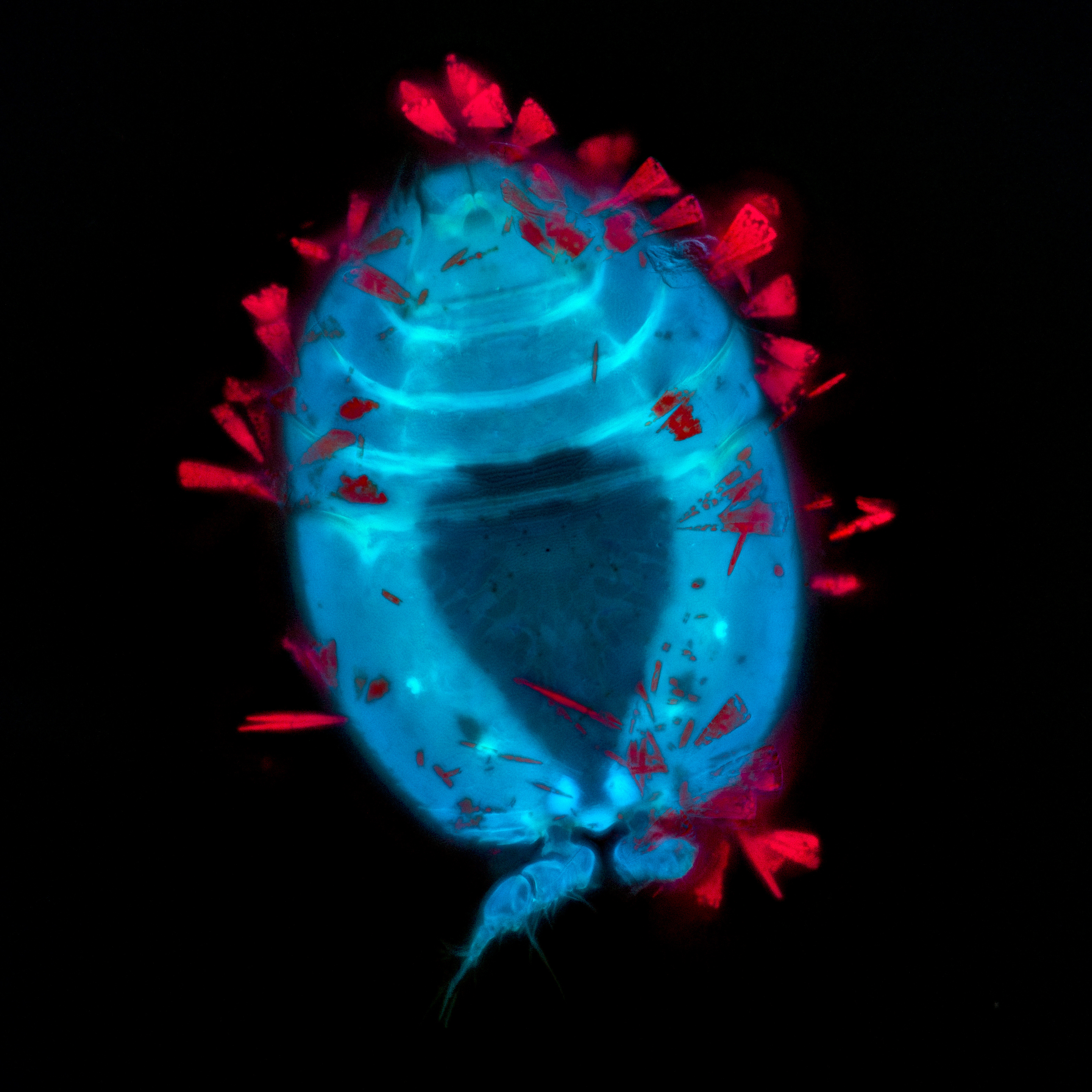

Harpacticoid Copepod - reef, 20x*1.25*1.4TC, FLUO-C6, HF C, Canon 6D
Full Image
Harpacticoid copepod - reef, 10x*2, FLUO-C6.1, HF C, DS-Ri2

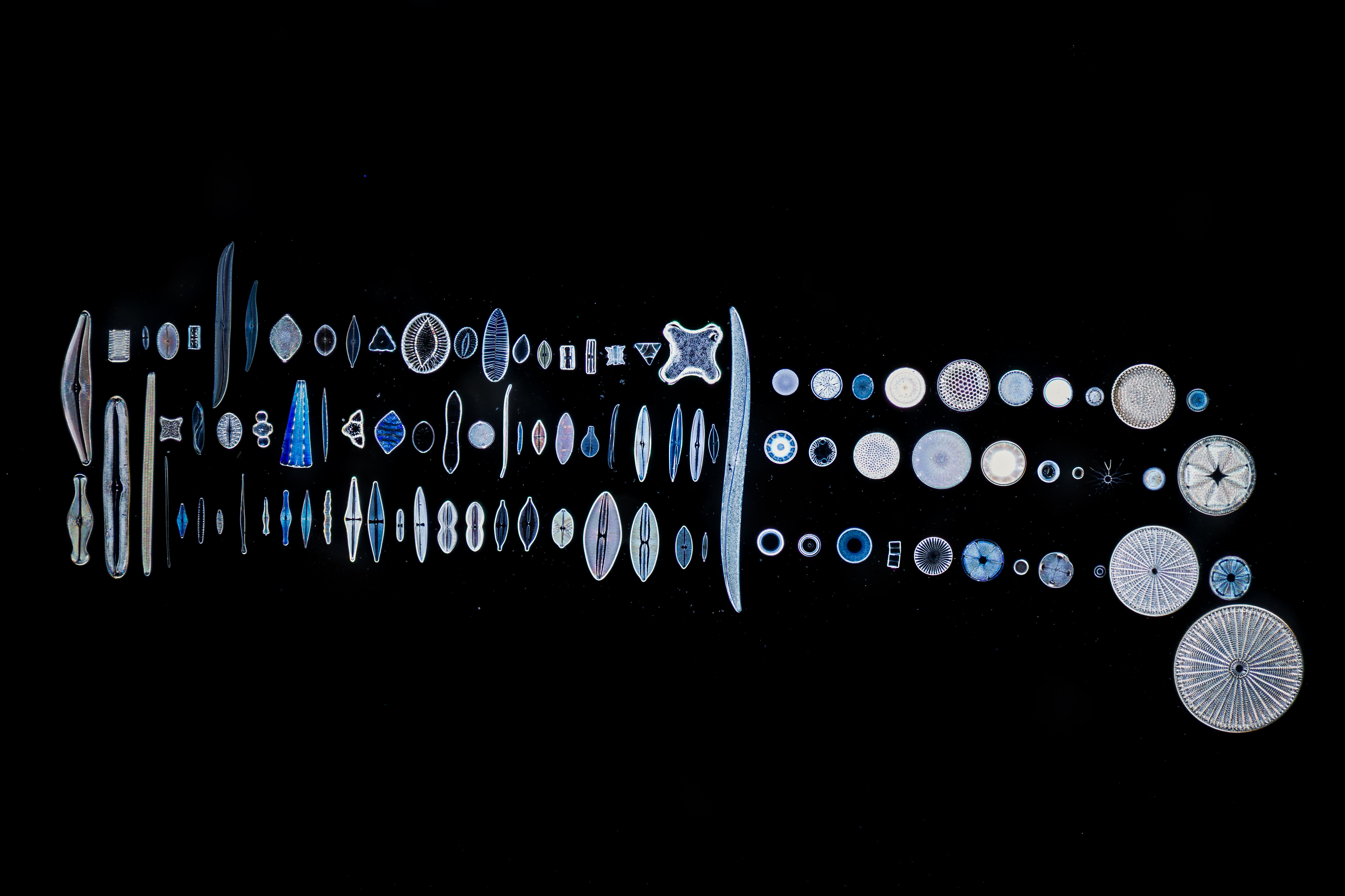

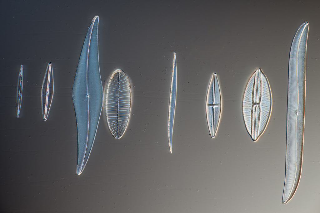

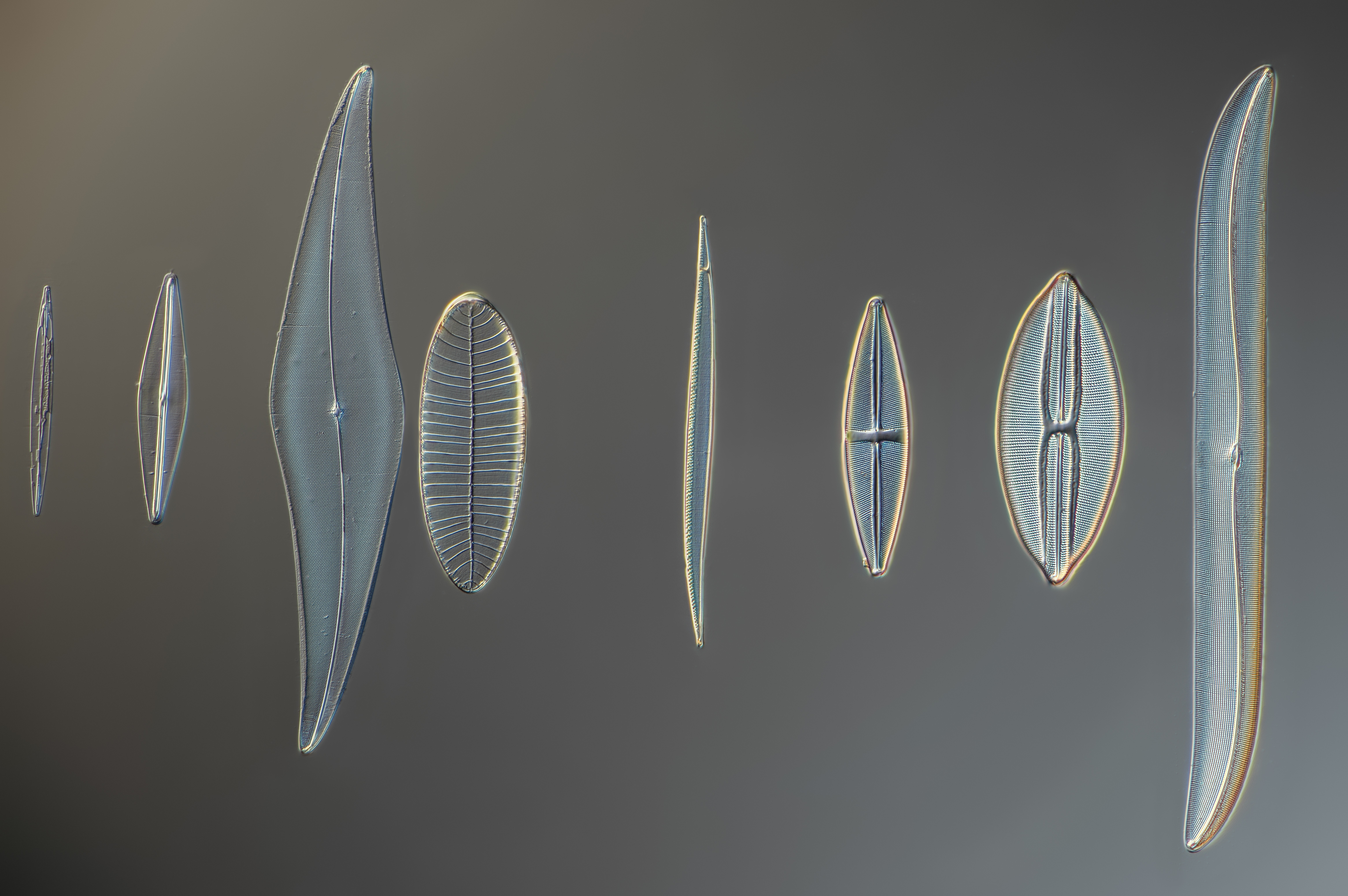

Test diatoms, 10x, DF, Canon 350D
Full Image
Test diatoms, 10x*1.4 TC, DF, Canon 6D
Full Image
Test diatoms, 10x*1.6, DF, DS-Ri2
