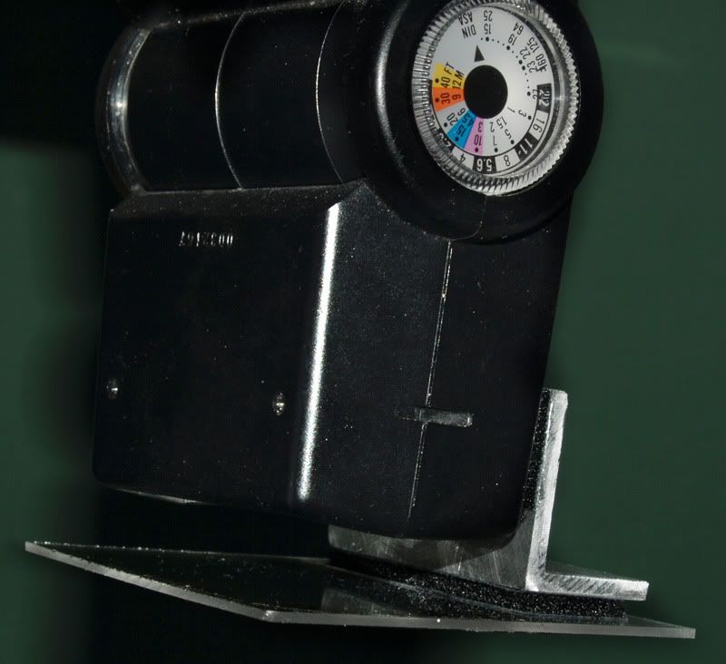

The filters have arrived and I have mounted them on the flashes. The mount is rather crude at this point, but I want to see if the polarizing filters will make enough of a difference to spend more time on the mount. Version 2 will probably be all acrylic and be able to use other gel filters as well.

I like the speedlight filter mount :)

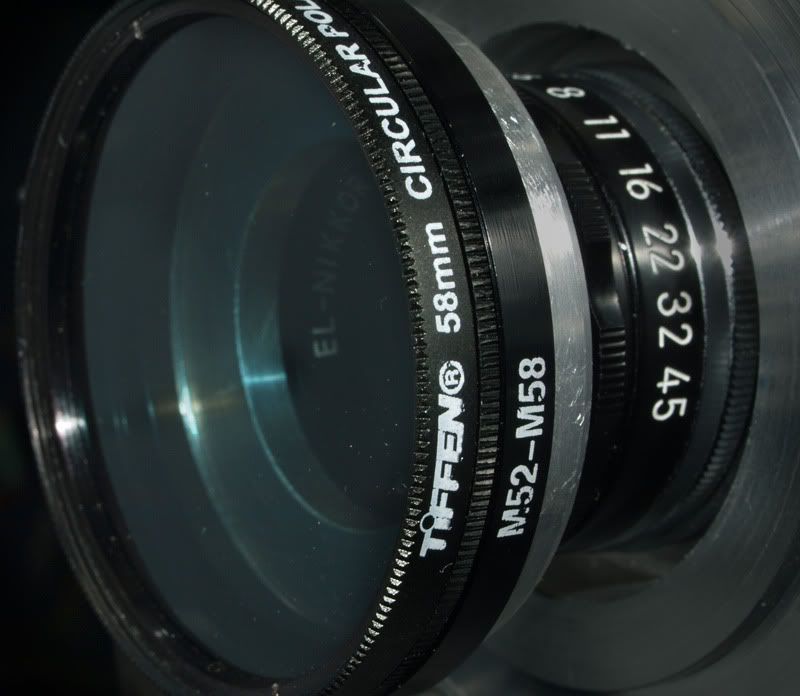

I had forgotten that I made a reversing adaptor for an El Nikkor 80mm f5.6 lens a year or so ago. It happens to have 52mm threads, and I also have a 52mm to 58mm step up ring, so it all fits together well. First test looks promising.
Here's a shot of the adaptors.

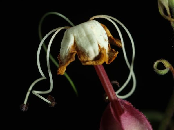

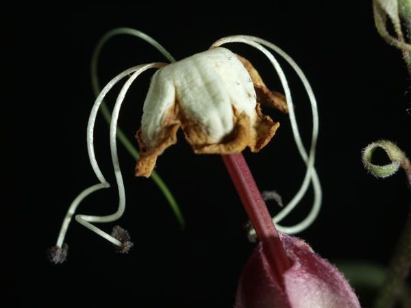

Here's a couple of test images with twin flashes. The only change between images was rotating CPL 90 degrees. Key light is on the right about 3:00 oclock and fill light on the left at 11:00 oclock. Both slightly in front of the subject.
Minimum polarized
Maximum polarized
