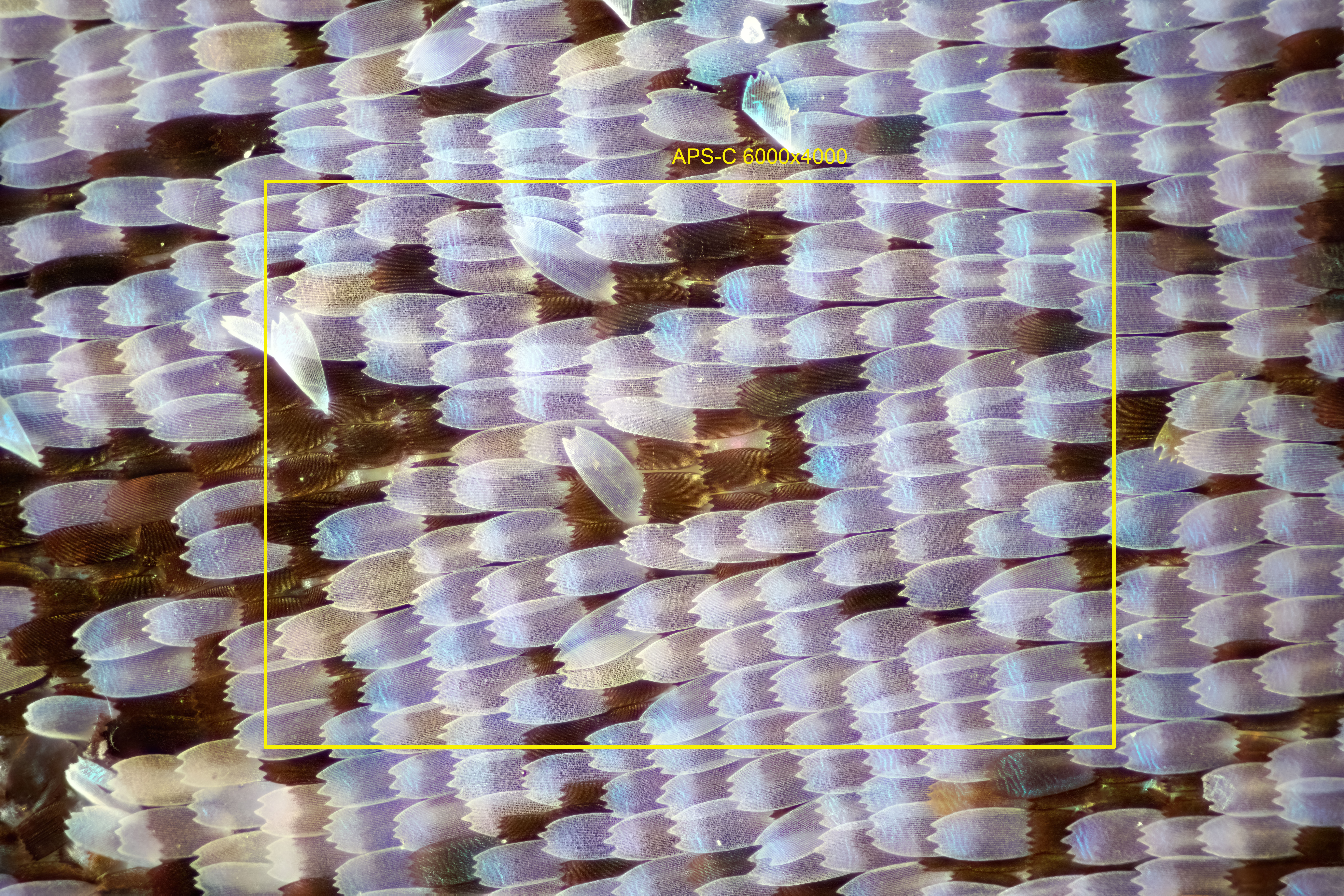

on the other hand on APS-C the 20x M Plan from Nikon should be OK, at least my version was (click big):
http://www.lolux.de/Lothar/20x_mplan_ni ... cessed.jpg

I don’t think you will find big differences between 18MP, 20MP, and 24MP Cameras. With so little difference among pixel counts, I would choose between these cameras based on other features. However, if there is no other difference that you care about, by all means choose the 24mp camera. I use a Nikon camera with an APS-C 24MP sensor in the macro studio.=> According to you my 18Mpx aps-c is correct for the X10 Nikon ? Or is it too small to take advantage of the optical qualities?
=> I was thinking of buying a 20MP reflex (Canon 7D) or even 24MP which would be largely sufficient for my use, I didn't want to buy the Canon 90D with very few shots for 500€ (1/2 price of new) last month... But if it brings out the diffraction even more, it's not good? Since I'm looking for "the sharpness" and I know that the sharpness is given by the lens, not the sensor.
=> So if I start with a 31Mpx = what do you think I'm starting with?
As to the question of where each sensor’s resolution becomes limited by a given combination of an objective’s magnification and numerical aperture, I’ll leave answering that to others.
