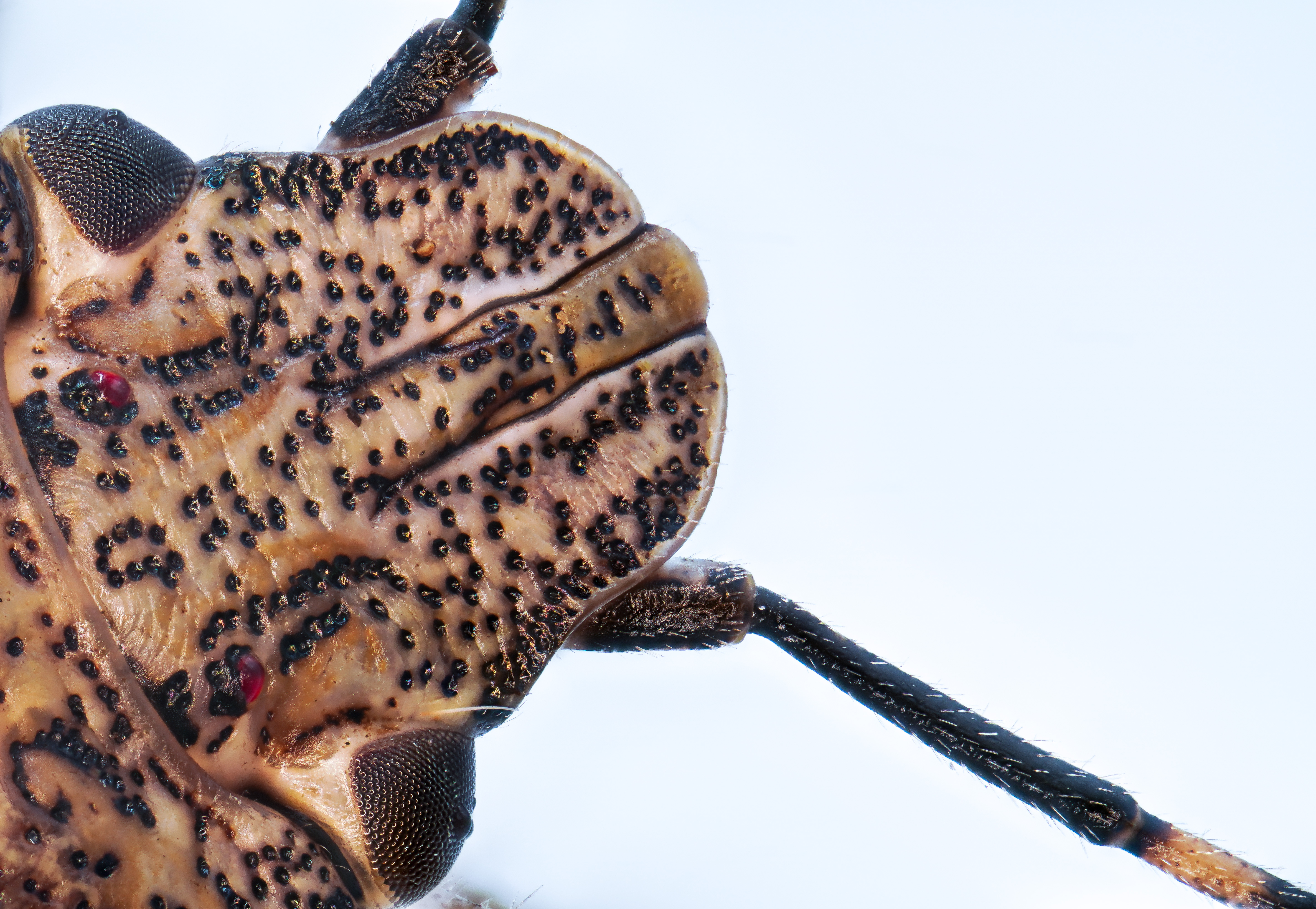

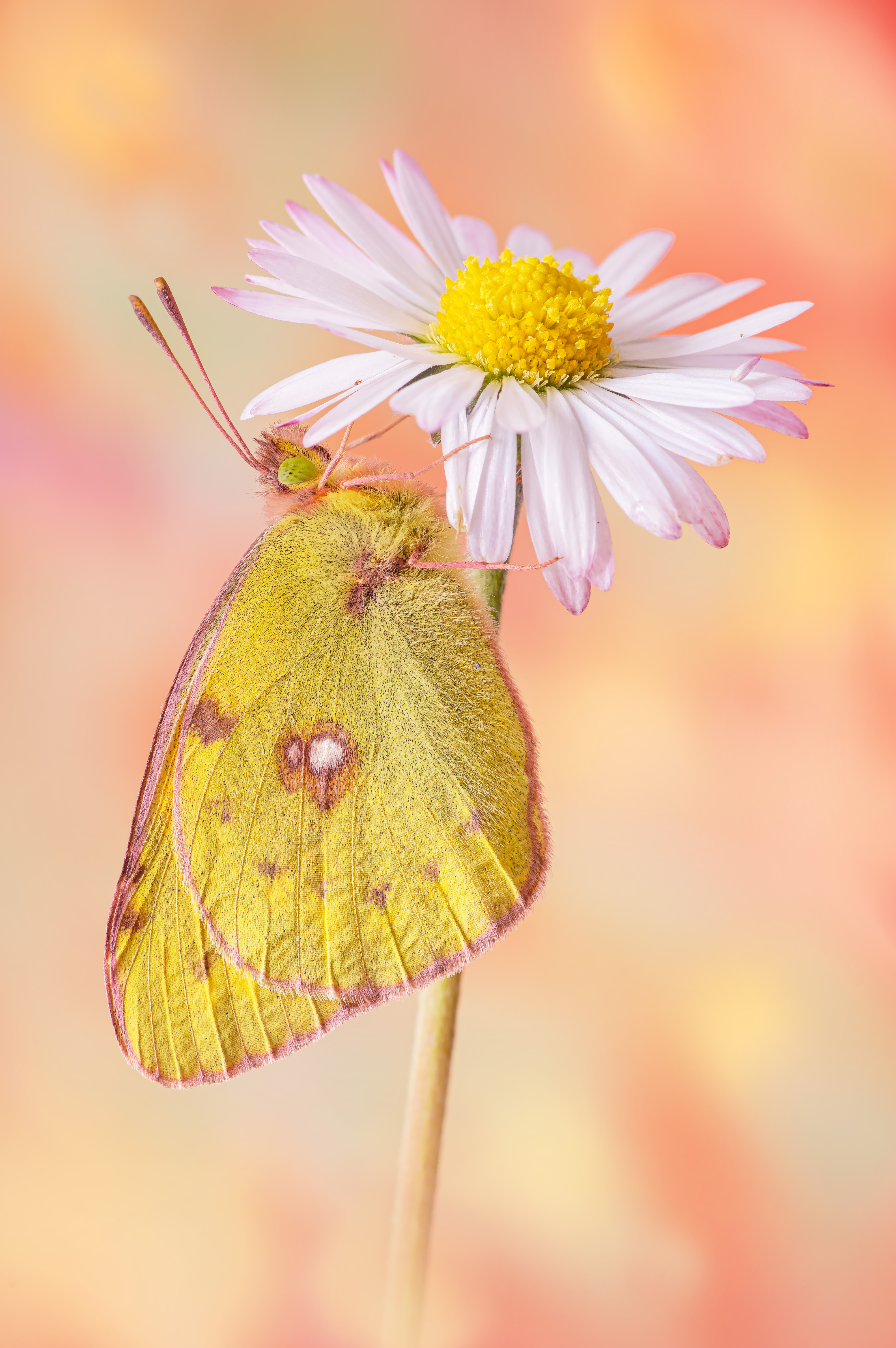

I'm an experienced macrophotography user (from close up to 5X ) and now i discovered the magic world of photos at >10X magnification
My goal with 20X is to have the same quality as my Laowa 25mm 2.5-5x or Pentax 100mm macro at 100% view (I print A3+ and A2 my best photos).
Example:
www.antoniodesantis.it/fs/vespa.jpg ( Laowa 25mm at 2.5X )
www.antoniodesantis.it/fs/cimice3.jpg ( Laowa 25mm at 5x)
www.antoniodesantis.it/closeup/colias_crocea.jpg (Pentax 100mm)
The photos with Laowa are first attempts with WeMacro rail and focus stacking technique I used Helicon Focus trial version.
Do you think that with the Nikon lenses you pointed out to me the results will be good?

I know you are an experienced macro photographer, Antonio. I only meant to describe you as inexperienced at magnifications higher than 5x--and this only to help other forum members note where you are in the learning curve in order to give you appropriate advice. (Also, I believe you will not be inexperienced at 10x and 20x for long.anto74 wrote:I'm an experienced macrophotography user (from close up to 5X ) and now i discovered the magic world of photos at >10X magnification
Very fine images! Your Laowa is looking good at 2.5x; but by 5x, it's not as good as a 5x microscope objective would be. This is typical and expected. So given your high standards, you may want to add a 5x microscope objective at some point in the future.anto74 wrote:Example:
