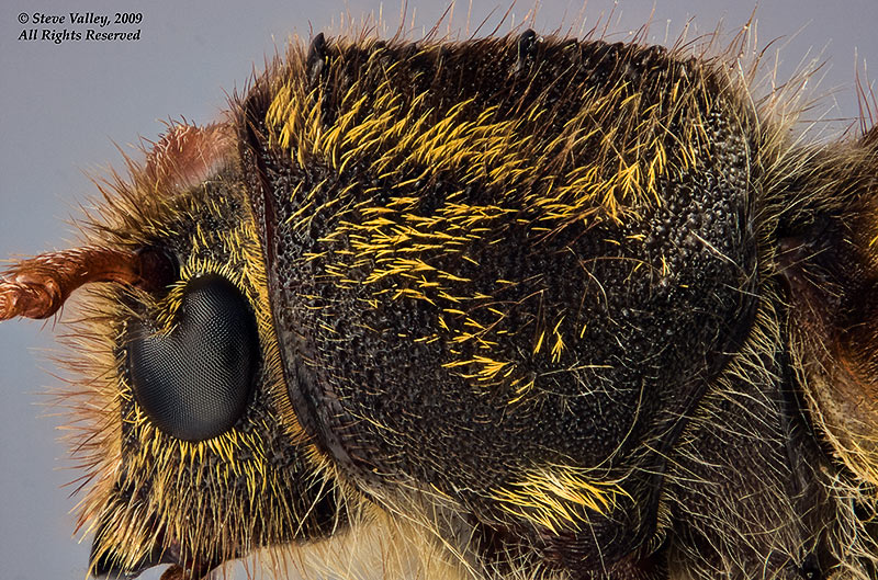

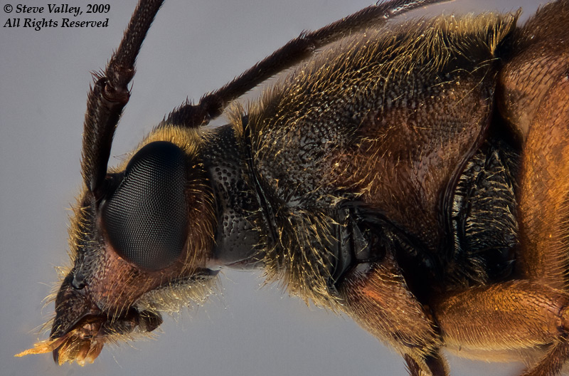

These are both Cerambicids or Long Horned beetles. I have been working on this group for a while now and this week I have been shooting lateral views of the pronotum (the area behind the head, the first segment of the thorax). The area imaged is about 5mm long.
Leptura obliterata, was not as clean as I would have liked. I ran it through my cleaning routine twice but could not remove little beads of some kind of resin on the tips of many of the setae of the pronotum. 55 layers in the stack.
Neoclytus conjunctus, 39 layers in the stack.
Both images were shot with an Infinity Optics KF2 Long Distance Microscope w/CF4 objective, Canon 40D, (Visionary Digital Imaging System)
The stacks were processed using Zerene Stacker.
