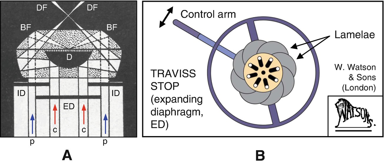

I think OP is referring "reverse iris darkfield diaphragm", originaly proposed by W. R. Traviss and patented by W. Watson (London, UK) in early 1900s. It's interesting and rare device, only few times it appeared on ebay.

In the diagram Duke shared, under "A", illustrates a Leitz condenser, which mixes DF (darkfield) and BF (brightfield), and it's capable to seamlessly switch between the two as the name implies. Obviously the BF obtained would be truly BF, but rather oblique due to the Traviss Stop. If there's an option to swing out the Traviss Stop mechanism, true BF can be achieved. Many older microscope condensers allowed components to be swung out.

If I understand correctly, the point of Olympusman's "feathering" approach is to produce an asymmetric cone of light, which then gives a sort of 3D appearance.
I assume the Expanding Stop would do the same thing if swung off-center, but that's because of the swing, not the expanding feature.
Please correct or clarify, if I have gotten that wrong. Thanks!

Yeah you're correct Rik, there's many ways to achieve the effect. With a Traviss Stop, you'd probably have more control but the same can be achieved with cardboard and scissors, or Saul's Kit.
I only wanted to add a little information to Duke's comment since I was coincidentally doing some research on a "centred iris", something I came across before but forgot the terminology of when trying to explain an oddball darkfield condenser with the expanding aperture mechanism to a friend.
