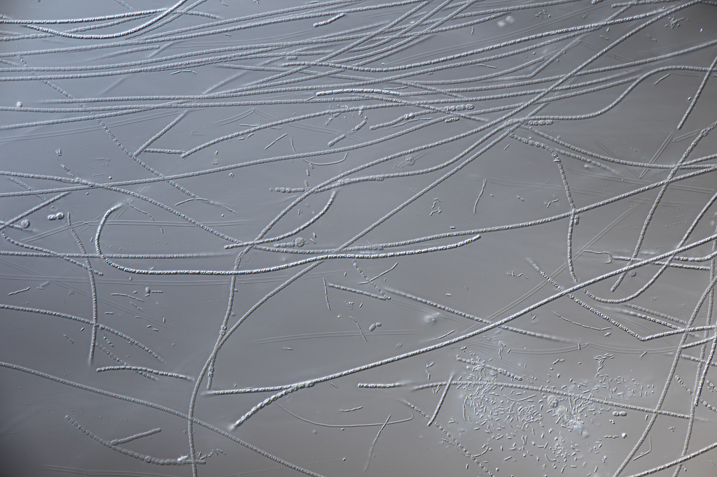

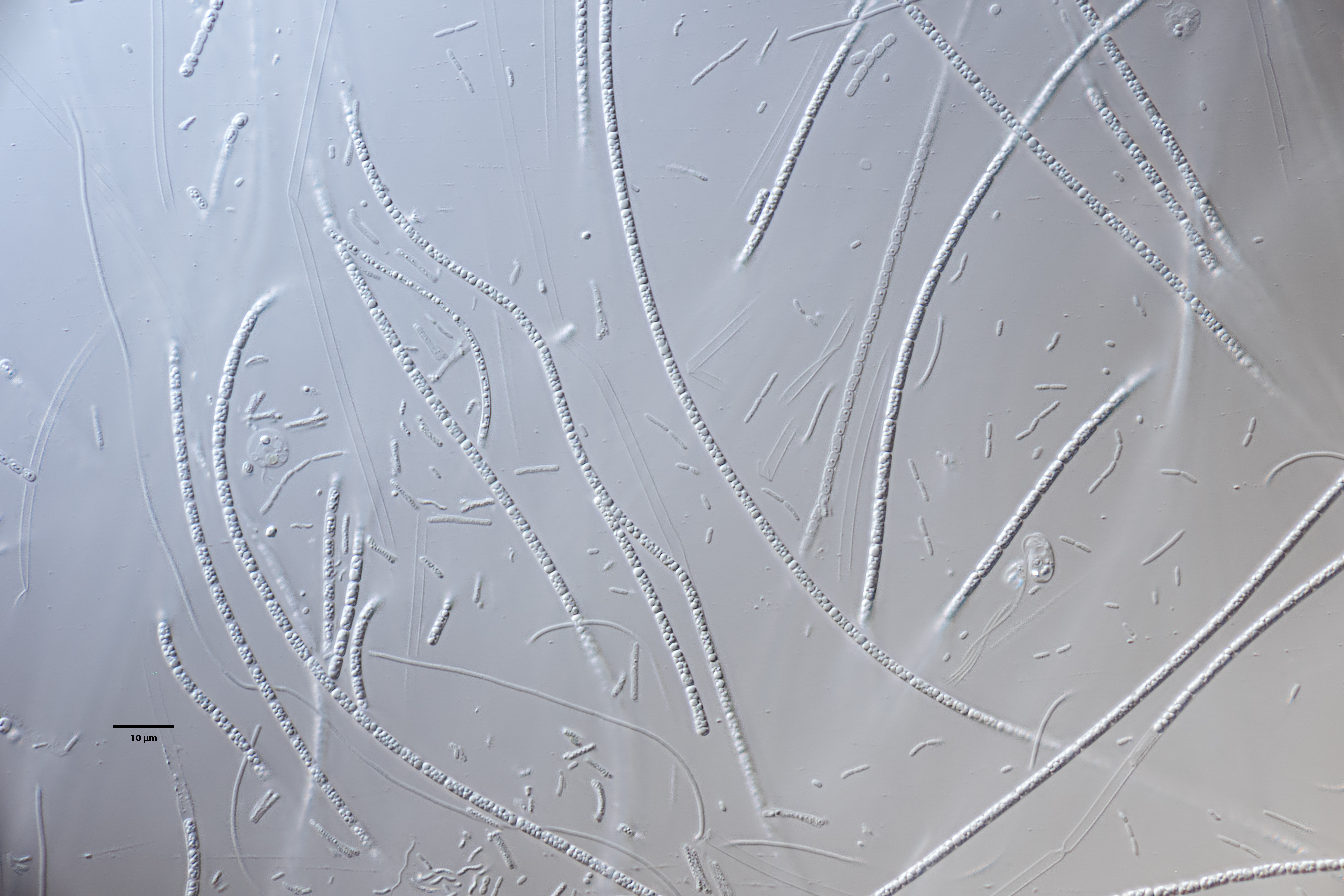

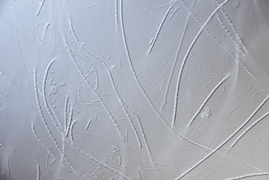

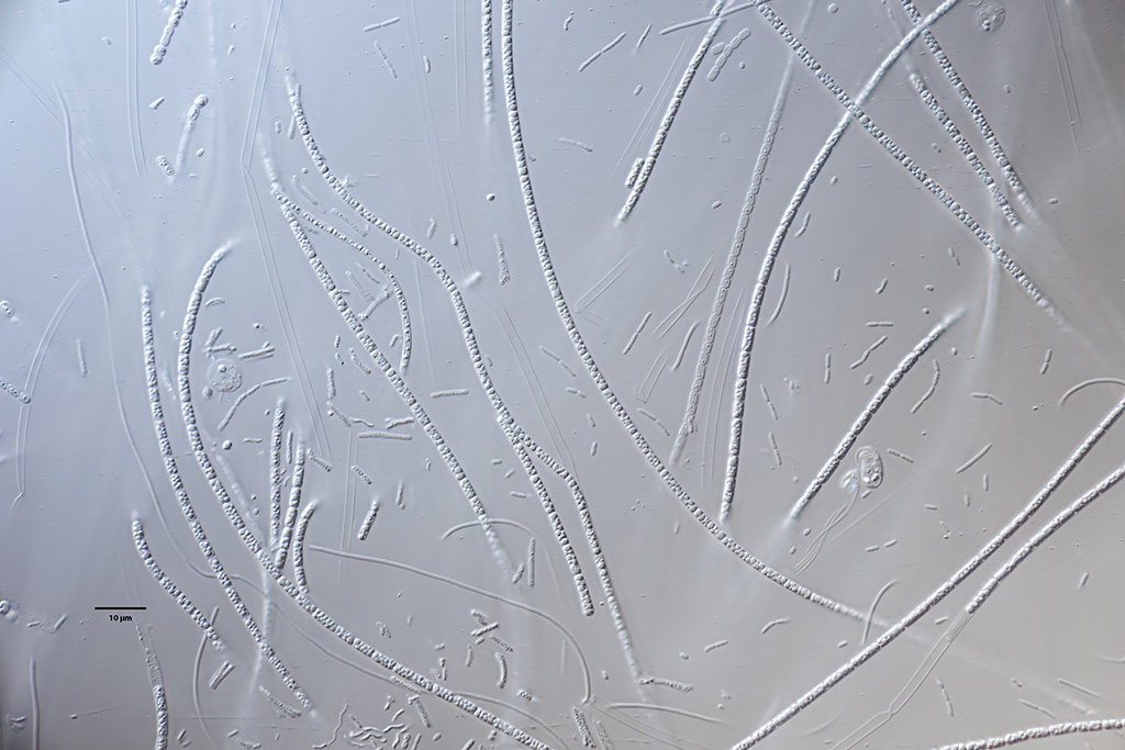

I get that it is near impossible to ID bacteria from a light microscope image alone without staining / other processing, but is it possible to narrow this down at least? It is long white filamentous bacteria that grows on newly introduced wood in a tropical aquarium - presumably feasting on sugars or something leaching from the wood into the water. It only lasts a couple of days then it dies off. It is visible with the naked eye as long white fluff.
Here are some images. I also know there are probably many species here, but I am mainly interested in the long filamentous species.
Bacteria from spider wood, freshwater tank, 60x/1.2, DIC, HF A
Bacteria from spider wood, freshwater tank (40% crop), 100x/1.4, DIC, HF A
Bacteria from spider wood, freshwater tank, 100x/1.4, DIC, HF A

Great images! I don't think it's possible to classify these without size measurements and stainings - there's such a diversity of filamentous bacteria https://www.iowaruralwater.org/tools_ti ... aments.pdf
The nature of the granules is interesting - these bacteria often have butyrate https://en.wikipedia.org/wiki/Sphaerotilus_natans or sulphur granules! Have a look by Pol microscopy.
Regards, Ichty

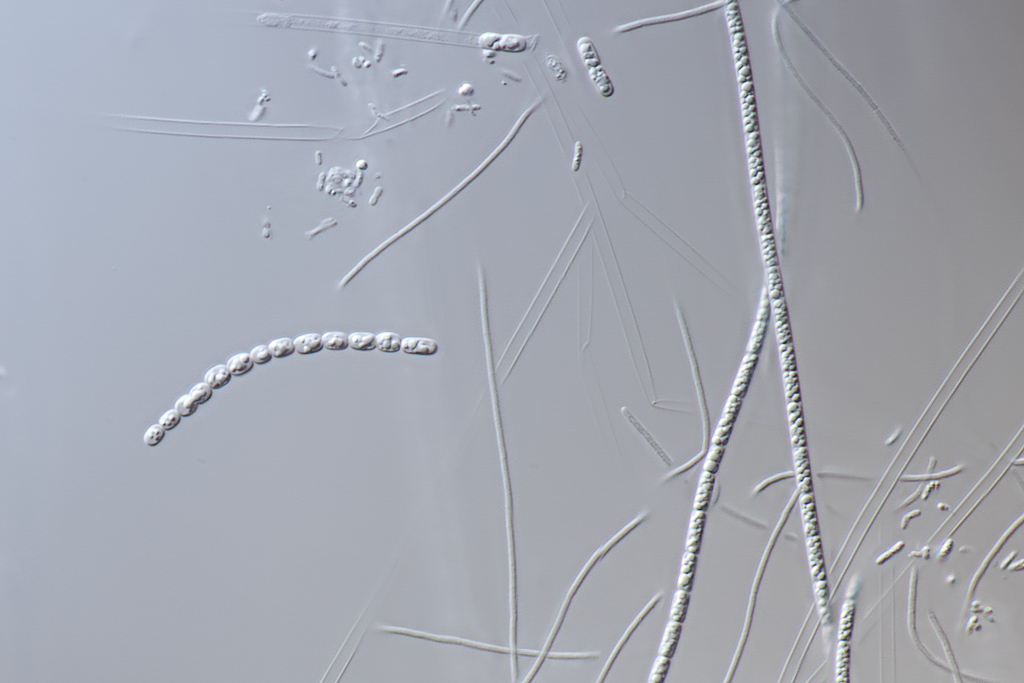

Here is a scale and another shot. The granules do not polarize, at least, when I photographed them I could barely notice any colour in the granules under cross polarizers.
100x/1.4, DIC
