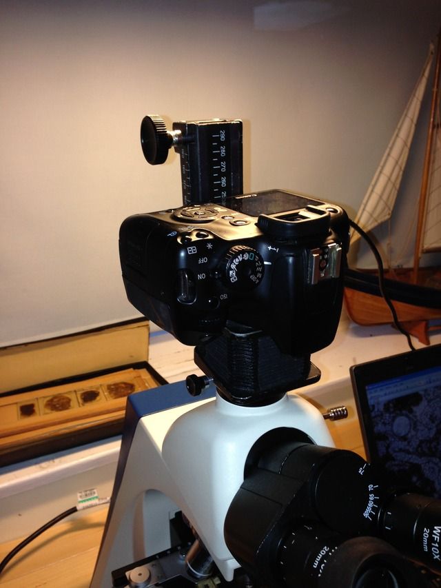

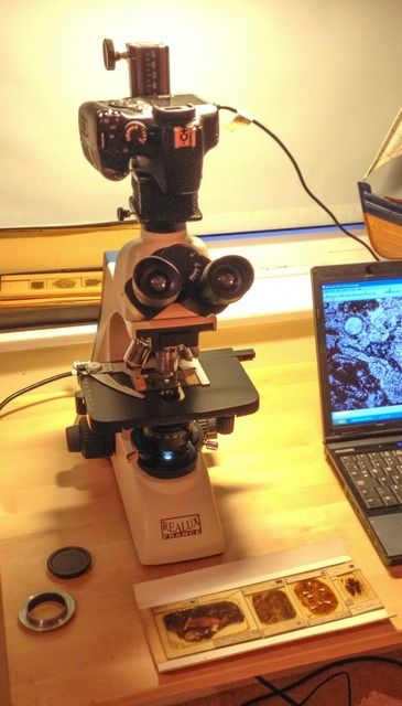

This is the new machine
It has 5 Plan objectives and seems very bright and clear.
I'm waiting for a suitable relay lens (c mount) and adapter for the Canon EOS bayonet.
Cheers
Steve
Cheers,
Steve

Hi Steve,
Why C mount?
C is usually intended for small sensor cameras and the parfocal distance usually is too short for a DSLR and its optics FL too short also, Is that adapter a simple empty tube or has it a lens?
Could you post a link to that adapter?

Hi Pau,
It has infinity objectives and a top port like this:
I think it is exactly 40mm diameter if measured with the vernier.
Cheers
Steve

Hi All,
Thanks to Pau (on a different thread) and particularly Icthy and Haris on this one... it works!
I set it up as you described with a set of old M42 bellows (just balanced on the mic and the Canon just sat on top of it).
Actually in this configuration it is slightly too long to be parfocal with the eyepieces but it proves that it works!
I am now looking at a range of plastic/aluminium tubes to make a custom adapter (and wishing the motor on my lathe was working!).
Thanks for your help! First photos to be in a new thread in the photos section.
Cheers,
Steve
