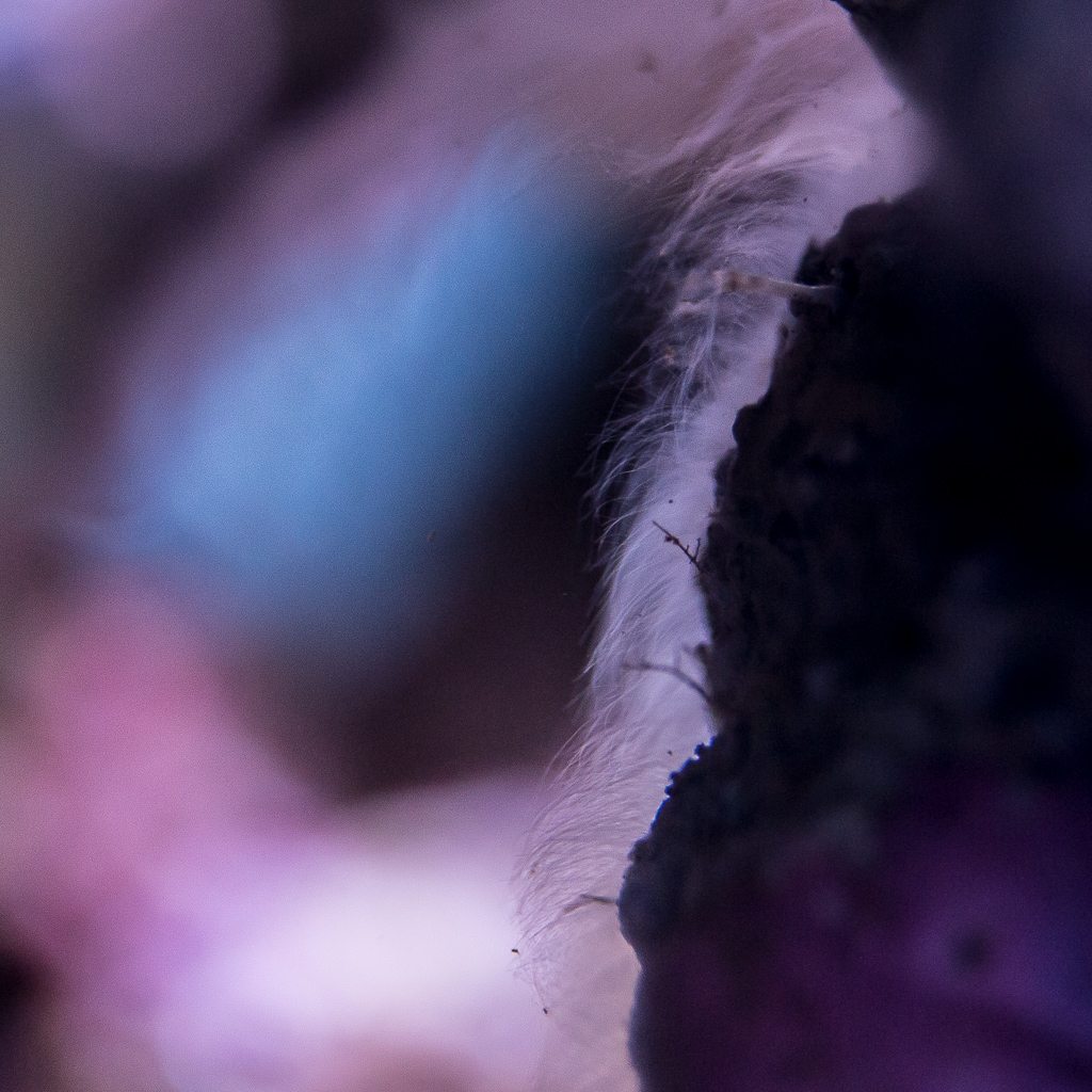

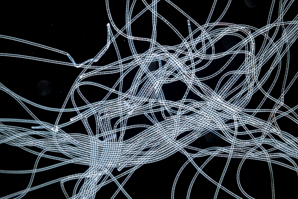

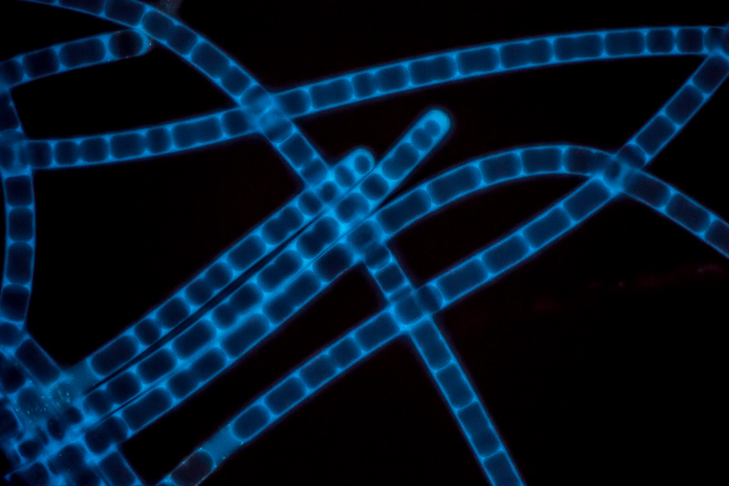

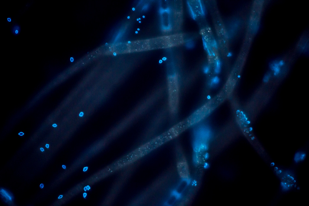

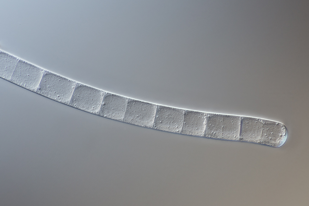

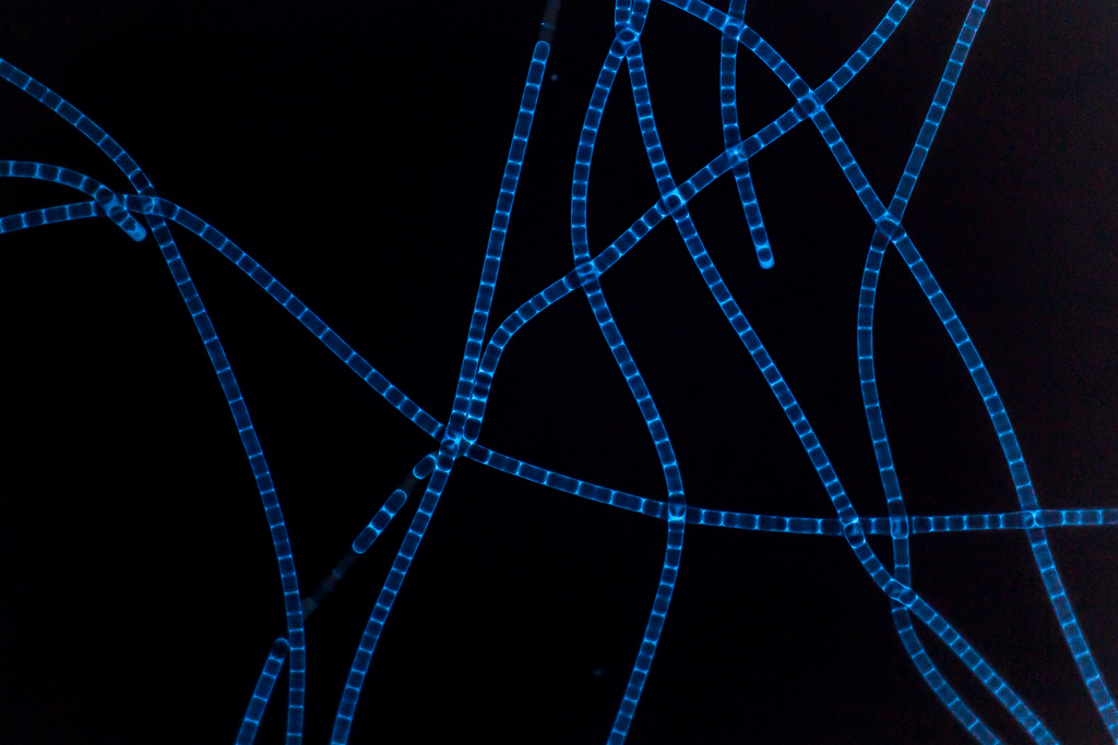

I have this white hair like organism growing on the live rock in my reef aquarium. It grows only in areas of darkness, i.e. the undersides of the rocks. Also, since it is white / transparent, I presume it has no chlorophyll and therefore not an algae. The strands are about 1cm long.
10x*1.25, DIC
10x*1.25, DF

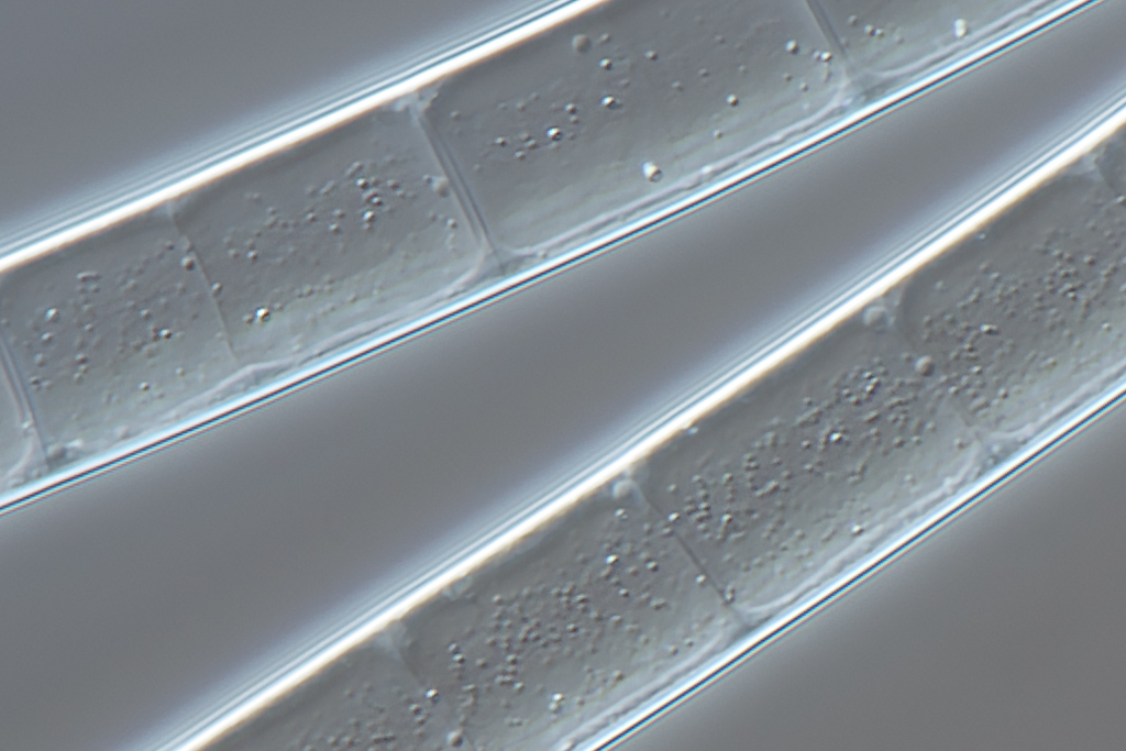

60x/1.2*1.25, FLUO-C6
60x/1.2*1.25, DIC, HF A
60x/1.2*1.25, DIC, HF A (100% crop)

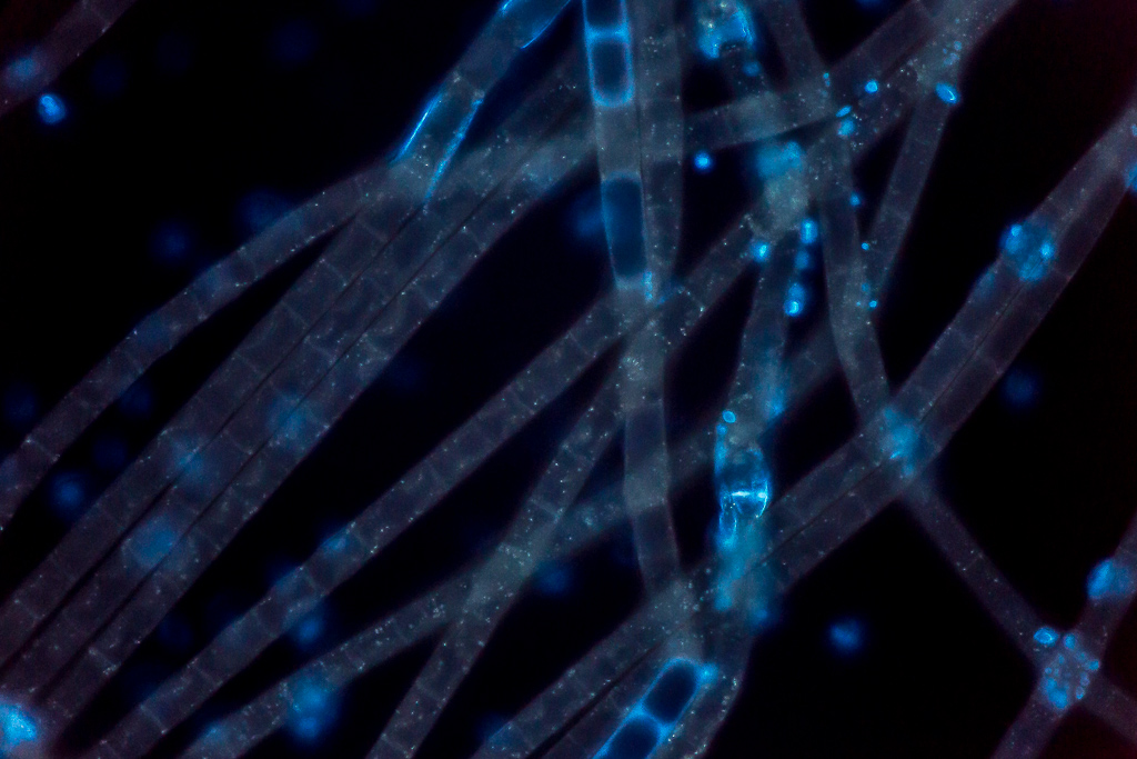

20x*1.25, FLUO-C6
Macro photo using Canon 1Dx and 100mm F2.8 lens

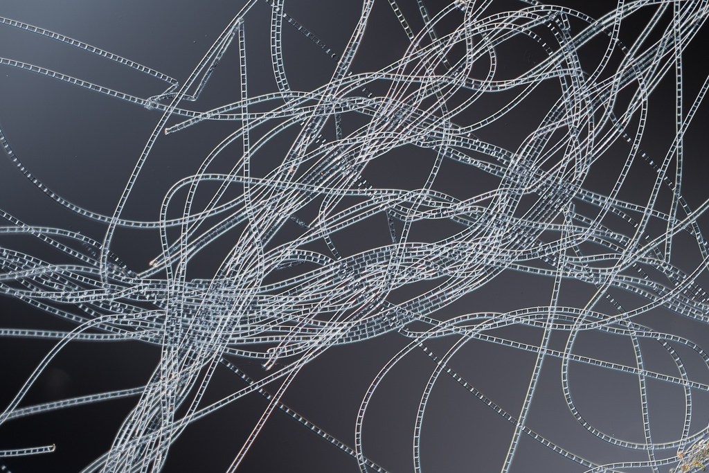

i particularly like #5 and #6.
You are certainly producing some wonderful (and informative) images with fluorescence.
No nuclei or other organelles so not a fungus (or alga). It is some sort of filamentous bacterium ~Beggiatoa or Thiothrix...both occur in marine aquaria.

Does not resemble Beggiatoa or Thiothrix.
http://www.asissludge.com/Scripts/d00000000.htm
Thanks for the comments so far. I am also wondering if it could be a bacterium as it is really large - look at the 10x shot, normally I cannot see bacteria at this low magnification. But then again I do not know much about bacteria...

There are some green sulfur bacteria which build long string-shaped structures. But this looks like a fungus hypha (feeding hypha). The calcofluor that you used binds to the chitin in the cell walls.
Regards
Ecki
Thanks Ecki. I did not stain these - the fluorescence is due to autofluorescence.

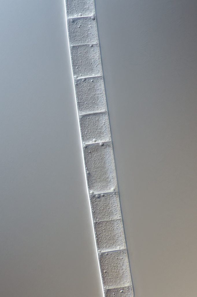

Here are two more pictures showing a circular structure inside the walls:
100x*1.25, DIC
100x*1.25, DIC
It seems a dead structure. Granules of sulphur or intracellular material are not observed

seem very long to be bacteria.
Are they moving?
Under the microscope they do sometimes move when exposed to light. Put it this way, I cannot easily take a stack of photos as one of the strands would suddenly move. Whether that is because of intrinsic movement or expelling of lipids / chemicals I am unsure. I know that as I take photos more and more oil like bubbles form.
Hi.
The most similar I've found is Planktothrix or Trichodesmium
