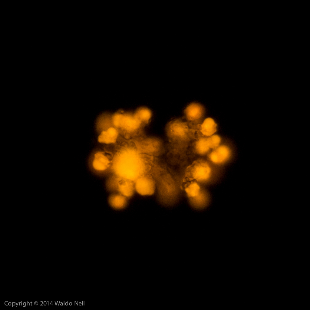

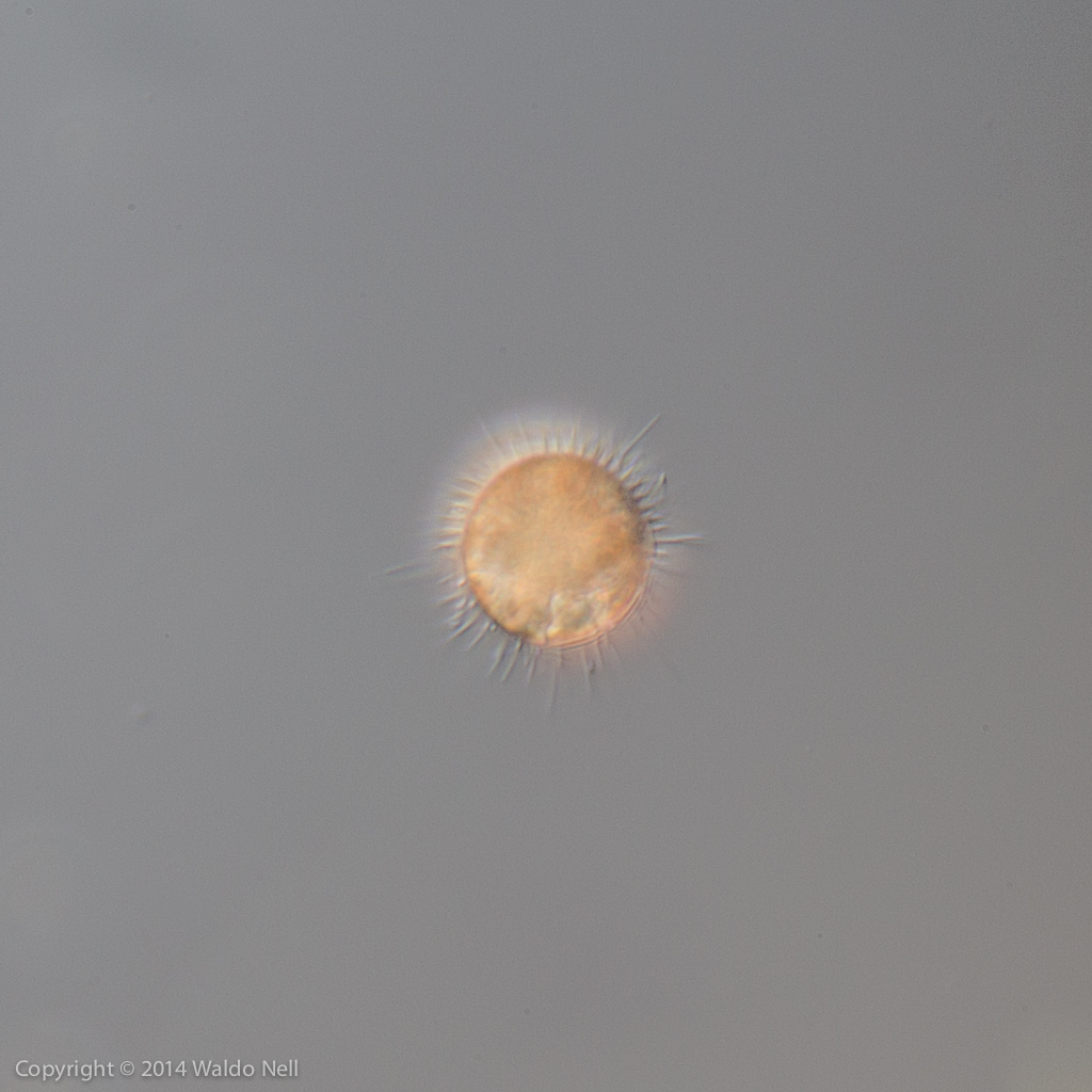

I tried to isolate the organism responsible for the red coloration in the red tide we had recently. However I seem to be struggling a lot. The only organism I could find that has a red tint to it is shown below. They consist of very small blobs (about 6 times the width of a red blood cell) that swim very fast - they swim almost like some ciliates. I can clearly see flagella, or bristles, that they use to swim with. However, as soon as I place a drop on the slide to photograph, they expire within 10 seconds. They would swim quickly, then stop, then the next moment they explode - the bristles drift away and their body changes into small cells that fluoresces. Each and every single of these organisms did the same - even in a slide with a depression so that cover slip pressure could be ruled out - that is why I could never get closer than with my 40x. Also, these images are very heavily cropped.
Please can someone ID this organism and tell my why their behaviour is so odd?
Shot within 10 seconds of placing on the slide:
20140713-DSLR_IMG_0024-Edit.jpg by pwnell, on Flickr
Red tide @ Coal Harbour, 40x/0.6*1.25, DIC, HF B
Shot within 10 seconds of the previous shot:
20140713-DSLR_IMG_0035.jpg by pwnell, on Flickr
Red tide @ Coal Harbour, 40x/0.6*1.25, FLUO-C4
Shot within 10 seconds of the previous shot - it "exploded" between this and the previous shot:
20140713-DSLR_IMG_0036.jpg by pwnell, on Flickr
Red tide @ Coal Harbour, 40x/0.6*1.25, FLUO-C6
20140713-DSLR_IMG_0041-Edit.jpg by pwnell, on Flickr
Red tide @ Coal Harbour, 40x/0.6*1.25, FLUO-C6, HF C

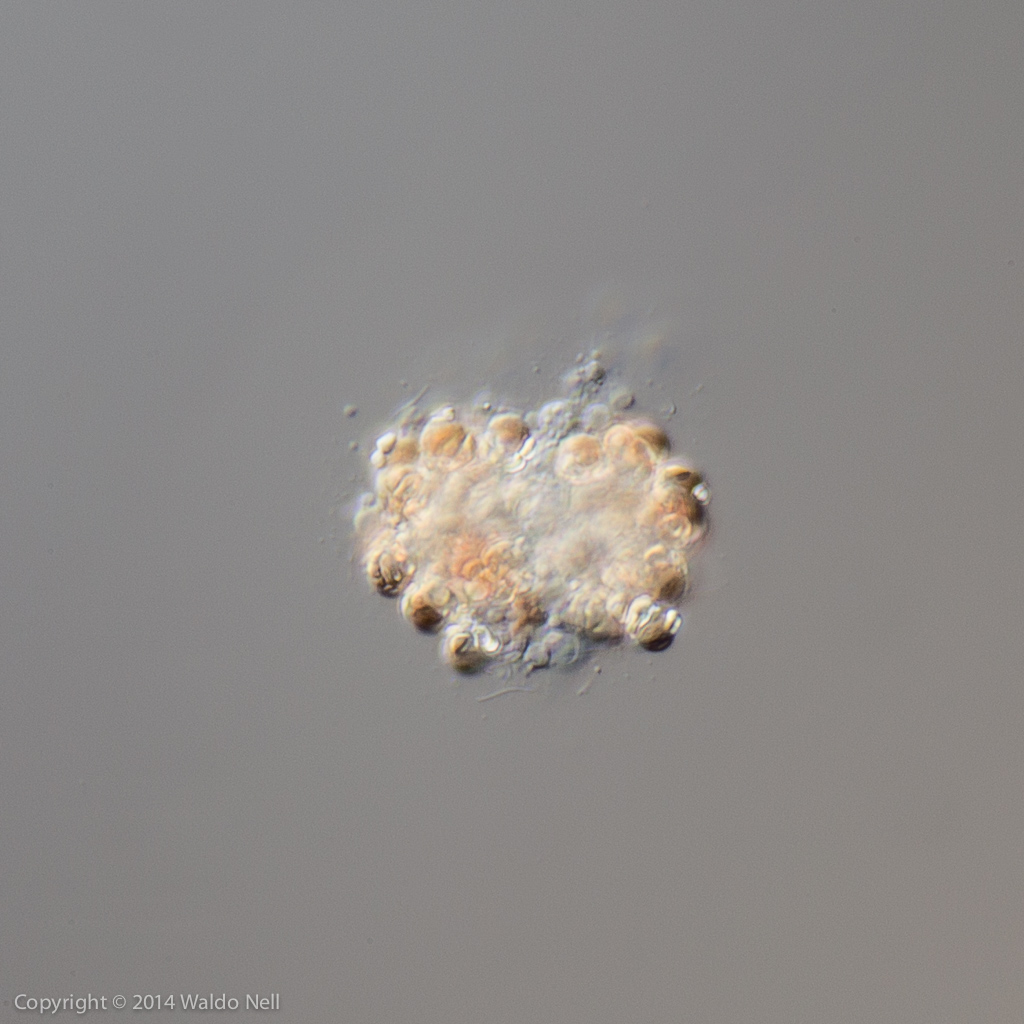

Three more... This one swam about and stopped in a weird position:
Then it exploded:

From the speed of it and the plastids, it seems like it could be Myrionecta--a kleptoplastic ciliate.

I agree, it is Myrionecta. They are very susceptible to stress and fall apart easily. In sedimentation chambers for use on inverted scopes they will keep a bit longer, and sometimes you can be lucky to find them still for a few seconds before they fly off again. Chasing them in such a chamber is a good sport...
I couldn't make anything of the first set of images from the red water, but now it is clear. From my memory, the chloroplasts are cryptophytes, which explains the yellow autofluorescence with some of the filter cubes.
Best wishes, René
