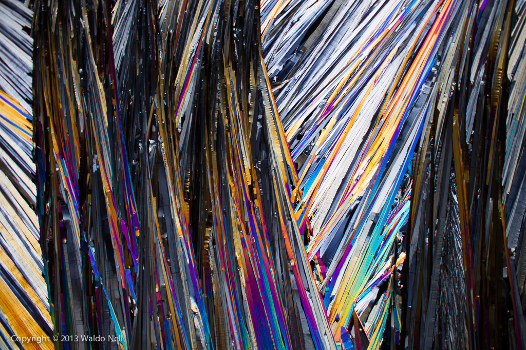

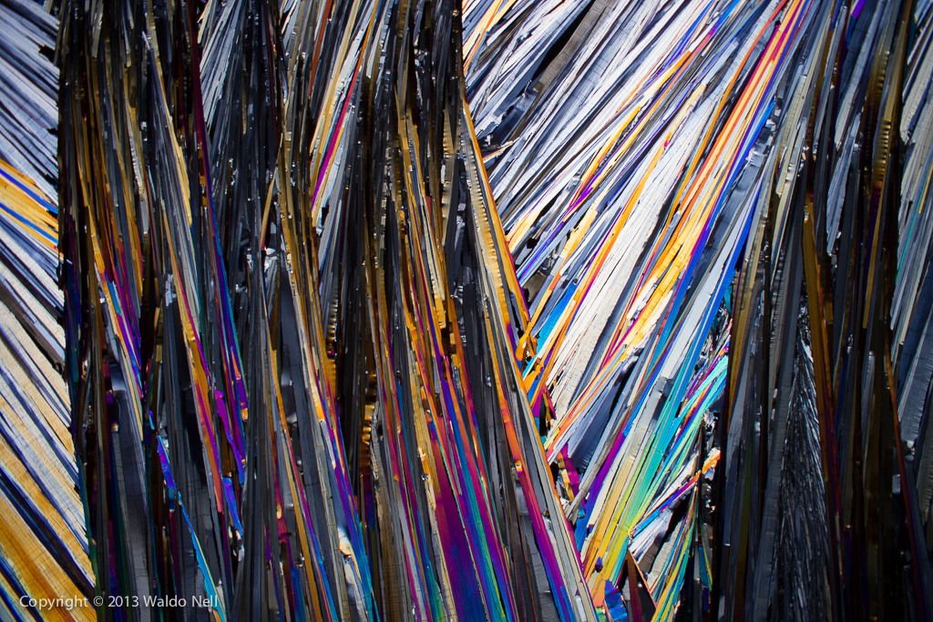

This is the third post of mine that actually all form part of a larger project I am working on with my daughter - Life In A Drop Of Water. Idea is just that - go out and see what life forms you can find in a single drop of water. The previous posts included the cyanobacteria (fluorescence pictures) and the ostracod / mite set. It is great to be privileged enough to be able to show your kid these things at home. She freaked out whenever I did something fancy such as the polarization of the amphipod - she loved seeing all those colours and learning about polarized light etc.
20130929-DSLR_IMG_0279.jpg by pwnell, on Flickr
Beaver Lake sample - amphipod,4x,POL
20130929-DSLR_IMG_0282.jpg by pwnell, on Flickr
Beaver Lake sample- amphipod,4x,POL+LAMBDA

In brigthfield ones i see some vignetting....why?
Arturo :wink:
Because the 4x/0.16 does not work with the universal condenser - I edited the black circular vignetting out but left a little.

hello pwnell,
congratulations for your pictures (specially Nr. 3 and 4).
In this case you could use a low power condenser (I made good experiences with it).
Franz
Franz Neidl wrote:congratulations for your pictures (specially Nr. 3 and 4).
Thanks!
Franz Neidl wrote:In this case you could use a low power condenser (I made good experiences with it).
As I mentioned above I tried Olympus' U-LC and U-ULC low power condensers designed specifically for the 4x and I could not see any difference between using those condensers vs. swinging out the TLD condenser in the universal condenser.
Besides - neither allows for any kind of lambda or quarter wave plates to be fitted, making above images impossible.
