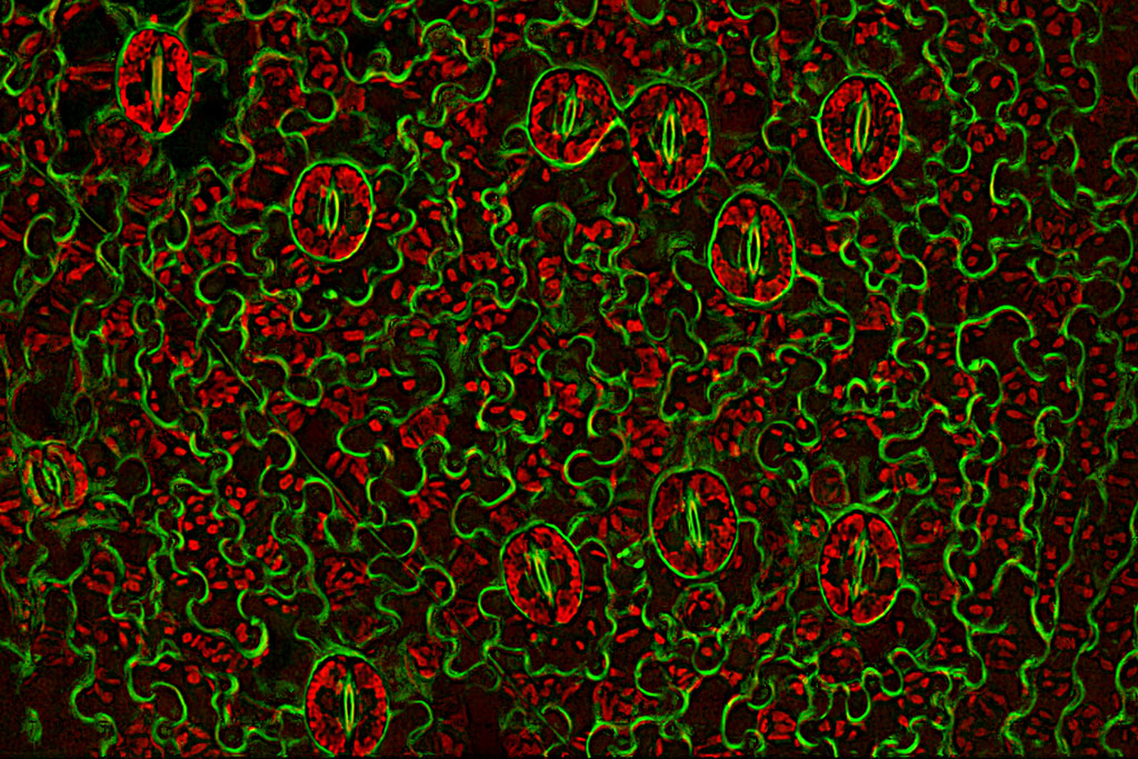

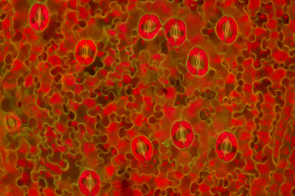

My first attempt at 3D deconvolution.
Original stack of 28 images using HF and Photoshop:
Deconvolution using cellSens Constrained Iterative:

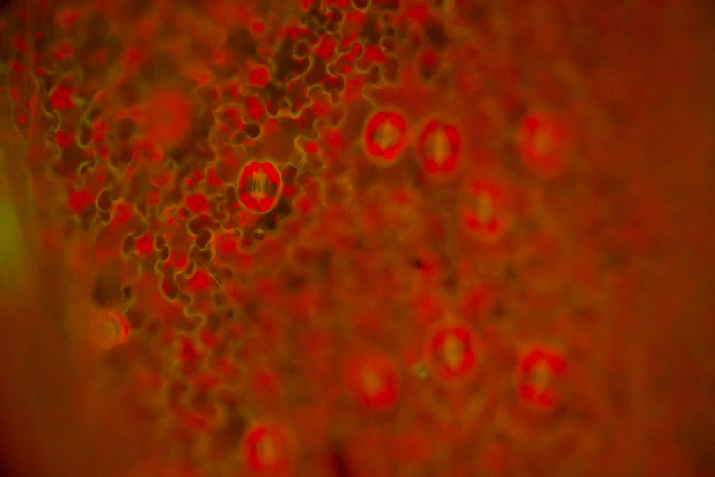

Wow! Great result. Can you show us a single image of your stack, for a comparison??

Amazing results!

René wrote:Wow! Great result. Can you show us a single image of your stack, for a comparison??
Here:

Well the first image is in fluorescence before deconvolution. So that would be "normal" light I guess? I have posted a reflected brightfield image in another thread on the fern stomata.

Hi Waldo,
Brilliant. I've not used the Olympus product, but your results are certainly equivalent to the best that I've seen using AutoQuant and Huygens. Which objective did you use? And does cellSens allow for superresolution? And did Olympus say which algorithm they use?

Hey David,
Thanks - I am quite pleased myself. Still not 100% convinced it is necessarily "prettier" than the normal stacking but it most certainly seems more accurate from a biology perspective.
For this photo I used the LUCPLFLN 40x/0.6 for its ability to have a correction between 0 - 2mm. I am unsure whether cellSens does support superresolution. The algorithm is Advanced Maximum Likelihood Estimation in constrained iterative mode. This photo did not have spherical aberration corrections enabled.
