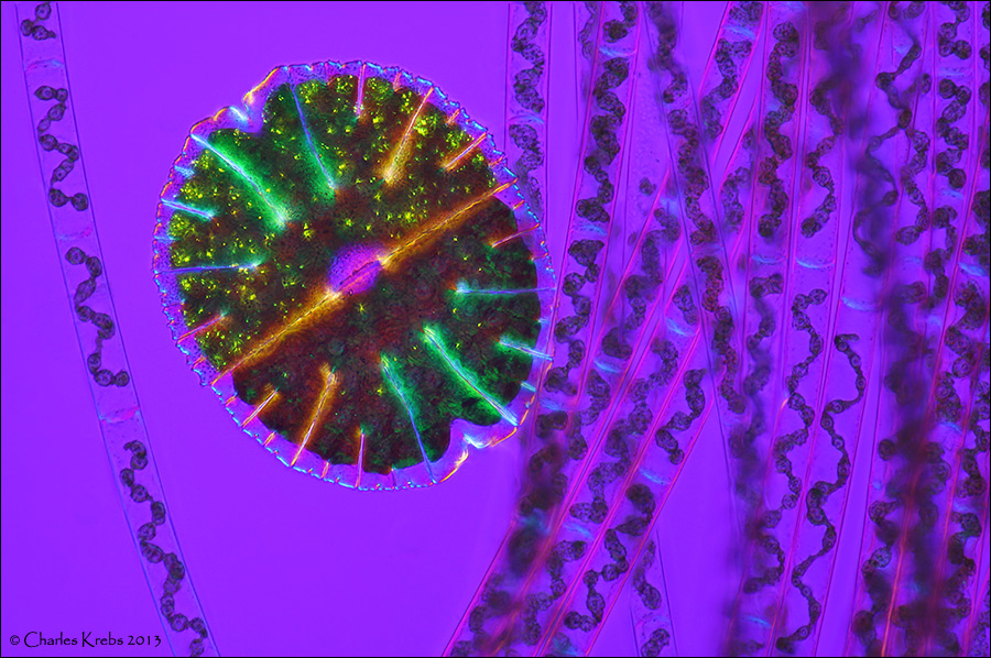

The pyrenoid bodies in euglena (where paramylon granules are stored) can really be made to visually "stand out" in this way. Here I've taken a few shots and showed the way they were recorded (with a strong red.magenta overall color cast). Then made a version where much of the red/magenta was removed in Photoshop. And as Marek has so beautifully shown us, desmids can really put on a color show with crossed polarizers and wave plates.

Nice photos Charlie! Its rare that you post something with wild colors like this. You've said a few times you prefer more natural colors.

Charles Krebs wrote: Then made a version where much of the red/magenta was removed in Photoshop.
A 1/4 wave plate will produce more natural colors while showing most of the cross pol character.
(I really don't like the magenta backgrounds but many people do)

A very nice solution. I also prefer less disco colours and the removing of the pink is very clever.
It is easy to make the corssed polars yourself. 3D glasses can be a source for the polar filters. If you place one filter under the condenser and one above the objective you have the corssed polars. As a wave plate you can use a piece of plastic.
But glass polar filters are of course best.

Crossed polarization (and the addition of "retardation" plates to jazz up the colors if desired) is not a complicated, or necessarily expensive, method of illumination to set-up. About the only tricky part is, on certain stands, determining the best implementation and location for the upper polarizer (analyzer).
