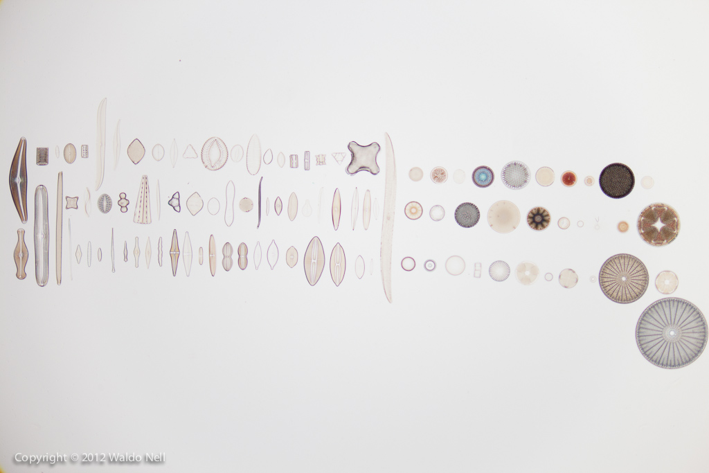

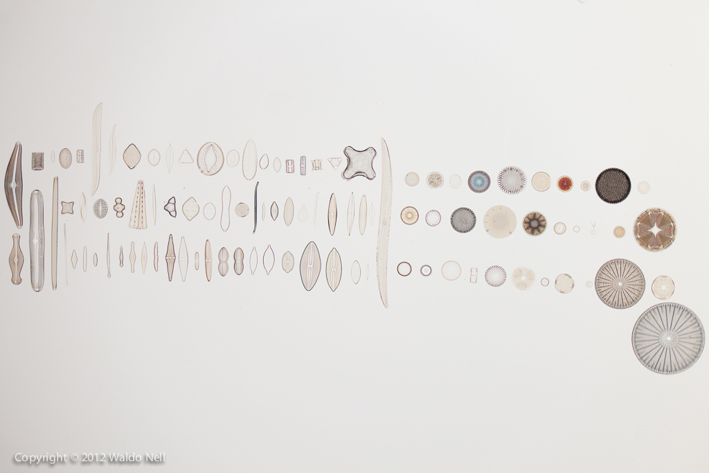

Since I sold my Nikon E200, I cannot compare the image quality with the CFI Plan Achromats I had. I tested my two 10x objectives on a very difficult subject, a diatom slide, and was quite surprised by the results.

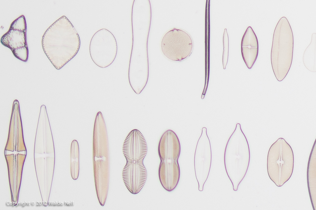

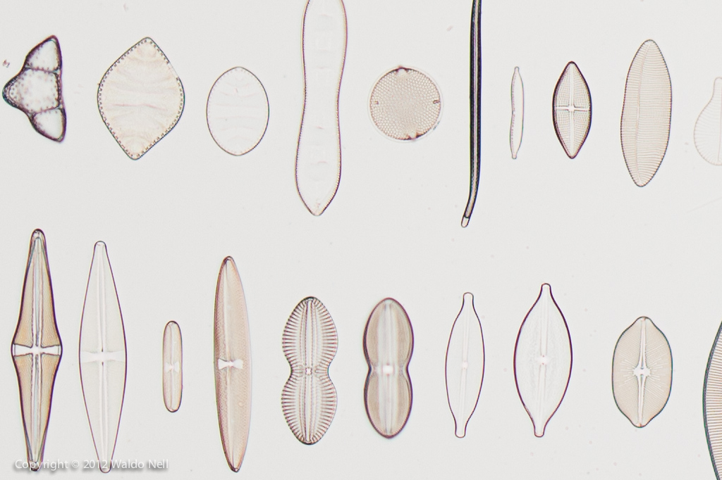

I am asking for feedback - I would like to know whether the new UPlanFL N 10x/0.3 is functioning optimally, as I found it to me much worse than the UPlanSApo 10x/0.4, which in my mind is as close to a perfect optical instrument I have ever seen in this comparison.
UPlanFL N 10/0.3, Bright Field, adjusted white balance, vignetting only.
UPlanSApo 10/0.4, Bright Field, adjusted white balance, vignetting only.
UPlanFL N 10/0.3, 100% crop
UPlanSApo 10/0.4, 100% crop
Well it looks like the Planapo is doing what it says on the tin ---- delivering noticeably better resolution and much superior freedom from chromatic aberration (fringing). I'm a little surprised that the difference is as marked as it is in those images.
