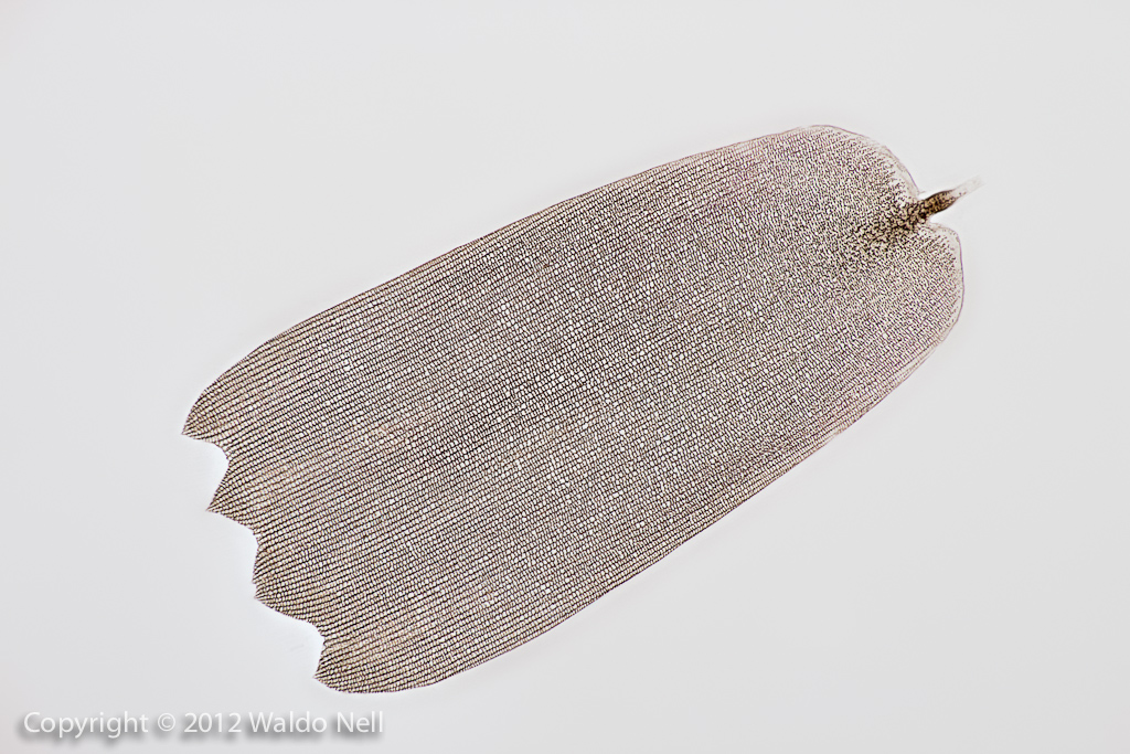

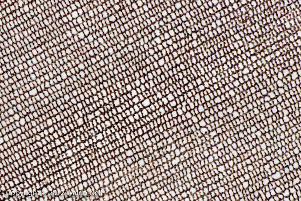

I tried to see what kind of resolution I can get with my setup using one single scale from this beautiful butterfly. The first image is an uncropped version taken with a 60x/1.35 oil objective and 2x magnification changer. The second is about a 100% crop. The tiny spore-like protuberances within the grid like pattern I measured to be about 290nm (0.29 µm). I think this is not too bad considering I am close to the theoretical limit of my 1.35 objective, which is about 0.23 µm. To get better I presume one needs a confocal microscope or a TEM / SEM.
ZereneStacker PMax
100% crop

That's beautiful. Do you think it is grown as a mesh with holes, or is it one piece with the space between filled with a clear membrane?
I am no expert on this but I do believe there is no membrane. The spacing between the ribs is what causes the irridecence, ie it diffracts the light.
Posts: 23352
That is a beautiful image!
Mitch, probably no membrane. SEM shots of lepidoptera scales consistently show an open network. See for example http://en.wikipedia.org/wiki/File:SEM_i ... view_4.JPG, linked from the article http://en.wikipedia.org/wiki/Lepidoptera#Scales.
Post by Mitch640 »
Rik, that's amazing. The question just came to me as I was writing a reply. I had no idea. The scales do not supply lift, but now it leads me to ask if air molecules are to big to fit through the holes? I don't have any idea of the scale of things. [I guess that's silly, come to think of it, or we would be able to see them in the eyepieces.] LOL
Air can easily move through the holes, as an air molecule is about 4 x 10^-10 m in diameter.
Posts: 23352
The molecules are about 1000 times smaller. Google search on "diameter oxygen molecule" etc turns up a small range of values. http://www.getnitrogen.org/pdf/graham.pdf has a detailed discussion. Roughly speaking the diameters of O2 and N2 are around 3 angstroms = 0.0003 microns.
