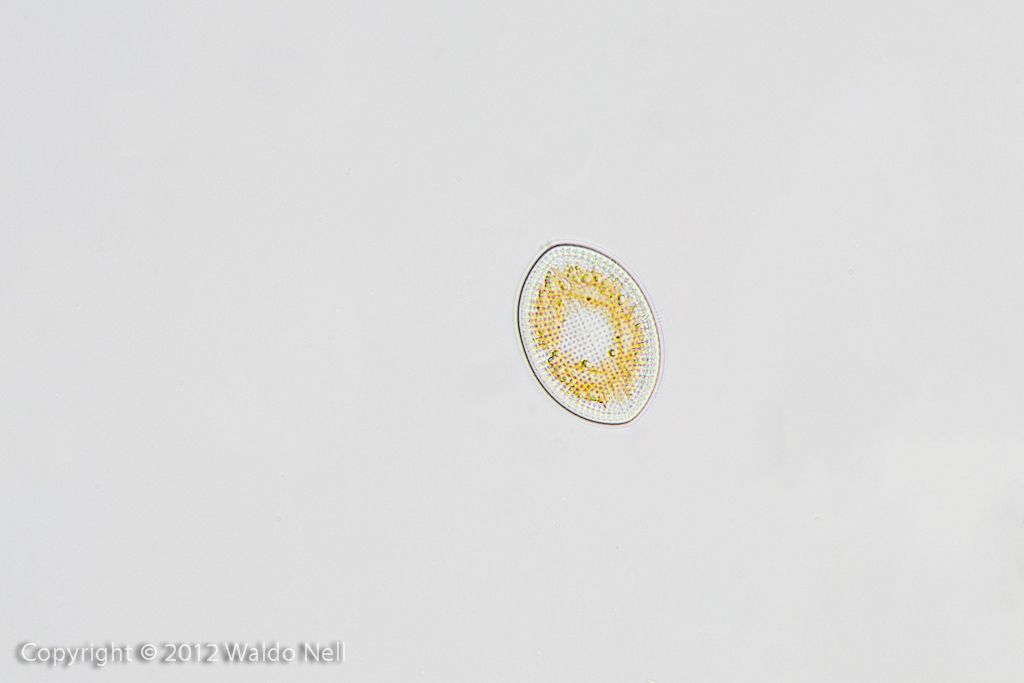

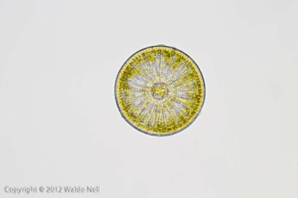

I'll leave the first two diatoms to the diatom experts.

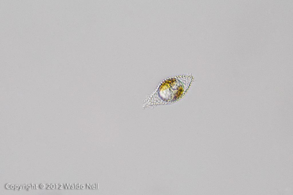

The third image looks quite a bit like a species of Mallomonas. But normally the chloroplasts "fill" the body.

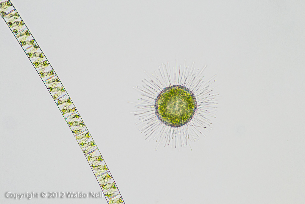

The fourth looks like Acanthocystis.

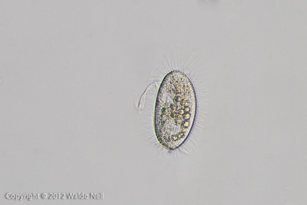

The last looks like Pleuronema. (A similar looking but much smaller creature, <30micron, is Cyclydium)

And one more, left side of the fourth image, looks like Spirogyra. (But don't trust me either! :wink: )
Thanks for the IDs. My "Pleuronema" is about 65µm long.

Agree with Pleuronema with feeding membrane up
Spirogyra + Acanthocystis Agree that first 2 are diatoms Can't help you with the remaining one.

The second picture probably diatom Cocconeis

Number 4 is Acanthocystis turfacea, a helizoon.

The third image is indeed Mallomonas and it was in stress. This resulted in the formation of a resistant cyst called a statospore. This is a unique spore and found only in the Chryophytes. The statospore wall is siliceous and has a small pore at one end. If you look at old Dinobryon colonies, statospores are very common. Related to the diatoms.
