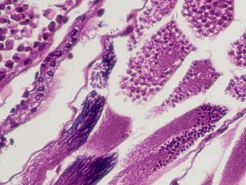

First try at darkfield with new E200

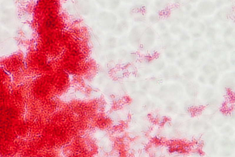

PS: Is it possible to get decent photos from the FF 1Ds3 without any kind of projection eyepiece? I see my DD20NLT will only arrive in 2 months, and I did a quick test at 10x with my 1Ds3 just held above the trinocular head by hand. Obviously some vignetting... And some softness in the corners. But the per pixel quality seems much better than the D90.

Absolutely. As long as you can position the body so that it is in focus at the same time as the viewing eyepieces are in focus. (It is better to not alter the eyepiece focus of a properly set up microscope in order to accommodate the camera). This is what we are talking about when we say "direct projection". With a 24x36mm sensor you will get vignetting when working this way. Pretty good chance you'll be good to the edges (or very close) with an APS sized body. If I did not need chromatically corrective eyepieces with my finite Olympus BHS objectives I would be very tempted to work this way using a APS-C sized body.PS: Is it possible to get decent photos from the FF 1Ds3 without any kind of projection eyepiece?

So right now nothing is glued in place, but the fit is tight. Here is the best I could do with the 1Ds3:
As you can see from the image above (stained gram positive and gram negative bacteria - prepared slide), it is horribly blurred. I can assure you the focus was tack on because I focused it to be sharp in Live View on DSLR Remote Pro with the 1Ds3 tethered to the computer.

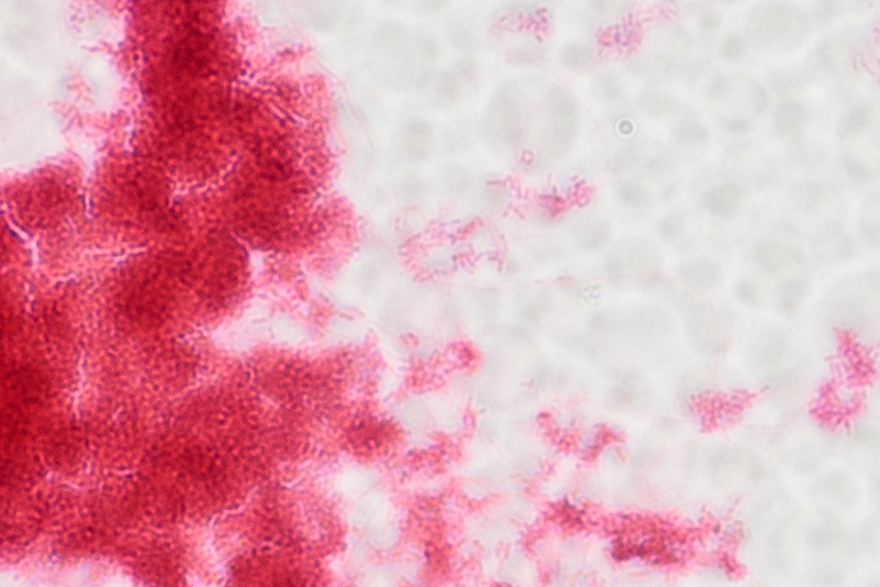

So I repeated the test, same 1Ds3, but hand held above the photoport - direct projection. Keep in mind this is horrifyingly difficult because my natural adjustments to keep the z-axis and x/y axises correct, are inversed. Up is down and vice versa. But here is a shot I can consistently get by hand:
This shot actually shows more detail than what I can view through the objective (40x) and 10x eyepieces. This proves to me it is a mechanical shutter vibration issue, since in live view the mirror is locked up, and no combination of MLU / remote triggering helped on the 1Ds3.

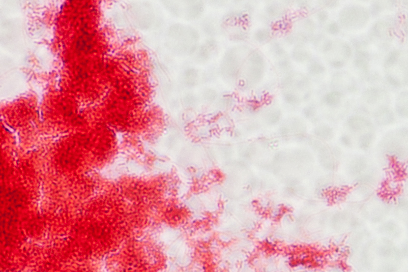

Also, take note above shots were at 1/60, which is the sweet spot for vibration induced frustrations. To prove it, here is the same static object shot at 2s exposure - it is tack sharp:

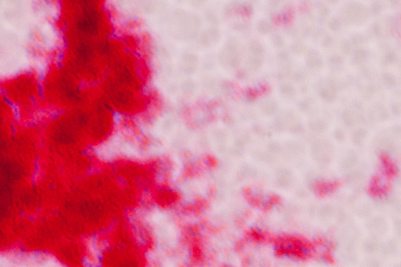

So I just picked up a 600D (T3i whatever that means) and attached it to the microscope the same way as I did for the 1Ds3 in the first example above - the T-ring adapter on top of the Y-T TV tube for the Nikon coupled with a PVC tube. Since the 600D is an entry level camera I have no options for MLU / Silent Shoot mode 1 or 2. All I did was to tether it to the computer with DSLR Remote Pro and used Live View, focussed and took the shot:
Now it might look a bit blurry compared to the 1Ds3, but do keep in mind with no projection eyepiece I am cropping the image circle heavily. As I said, I am pretty sure cropping this heavily on a cheap $500 40x CFI Plan Achro objective would not really pick up more resolution. If I resize the 600D down to match the 1Ds3 this is how it looks like:

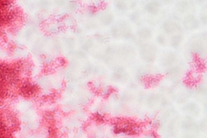

To my eyes I see the same detail. Just for fun here is some white blood cells I think from a stained blood smear. 1Ds3 directly coupled:
And the 600D:
It is clear to me that unless you can mount the 1Ds3 like Charles did - no direct coupling between the camera or microscope, it is no good for many higher magnification shots unless you use flash.
From now on I'll use the new 600D which seems more than capable for microscope duty.
And the 600D:
