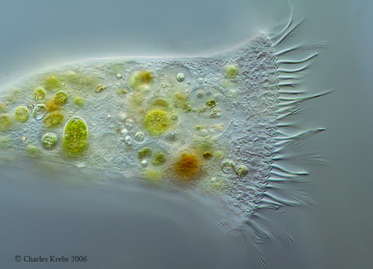

Stentor with cilia "frozen" by electronic flash. This one looks like it's had a good day "grazing".
Posts: 23360
Can you explain a bit about the anatomy of these beasts? In the picture, the cilia have sort of a front-like appearance. It looks as if there may be groups of cilia, with their bottoms bundled together into a thick trunk, while their ends splay out in some organized fashion. Is that really what they do, or is it the appearance somehow introduced by the photography? I guess I could imagine multiple quick flashes producing this appearance, but that seems unlikely. Have you run into any electron micrography pictures that bear on the question?
I too was wondering the same thing Charlie :) . I know that the 9+2 configurationf of the microtubules, located in the basal body, cause the cilia to rotate or beat in a whip like fashion and I am assuming that this is being demonstrated in what we see here, with that thick looking base and feathery like appearance of the cilia. In a way they appear more like cirri than cilia. :-k Beautiful photograph! :D
Rik and Ken... they are cirri, multiple cilia fused together at the base. Sort of like a simple straw broom, bound together at the base but whipping about individually at the end. Must make for a relatively powerful "feeding current".

Hi folks,
Stentor belongs to the Spirotricha/heterotricha. It thus features a AZM and the cilia of the peristome are referred to as membranelles (see Patterson p. 107). To my knowledge, only the hypotrichs do feature cirri, but I'm willing to learn!!
Bernhard

Bernhard... I want to get the terminology correct as well. Looking into it more, I think you are correct. So we should call it the "adoral zone of membranelles"... but there are many references to "fused cilia" and cirri in regards to stentor.

Hi Charles,
I see what you mean; well, after Chriatmas I'll dig in a bit deeper into my literature: Let's see if we can sort this out. But, regardless to how they're called (what's in a name!), they're certainly impressive to watch, aren't they?
