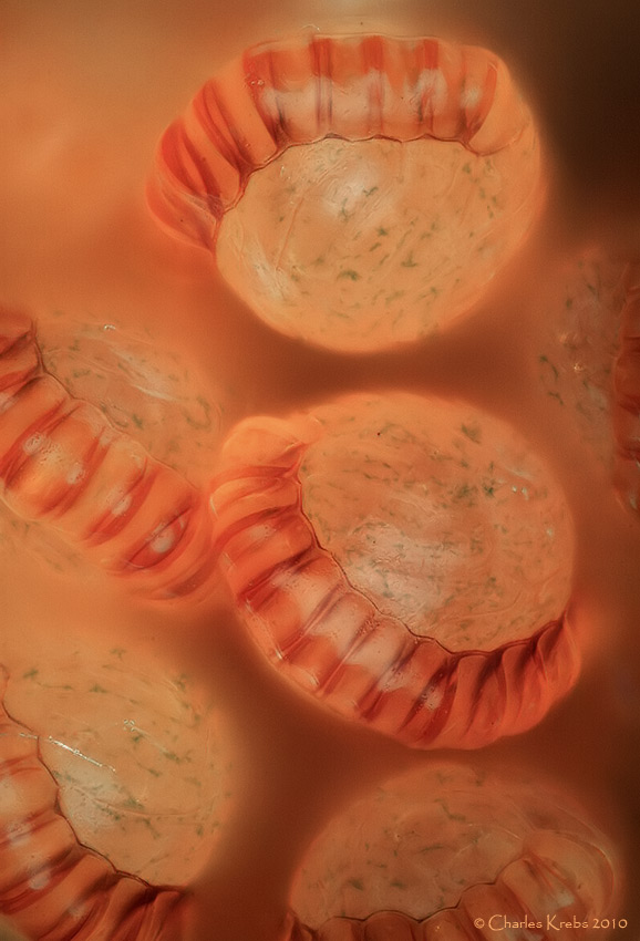

25X (with 10X M SPlan) and 50X (with 20X M SPlan) on sensor. Olympus BHA with BH2-UMA vertical illuminator and NFK 2.5X photo-eyepiece. Brightfield with crossed polarizers to reduce glare.

The choice of objectives and photo-eyepiece. Was that due to working distance requirements and/or other additional factors?
Looking forward to seeing what happens next with these fern spores.
Craig
The choice was simply to get the composition I wanted.
I prefer to use the 1.67X NFK, but that is usually in the BHS stand. If I am going to take a number of shots with the BHA and epi illumination, I will switch it out. If, like in this case it is simply a single subject with a couple shots I'll sometimes just leave the 2.5X in, as I have done here.

Amazing........these look animal rather that vegetable:
What wonderful colour and texture too:

Spectacular. That's a great use of an epi illuminator. I must admit these remind me of the clutch of eggs from one of the Alien movies. Now I have to go and grab a fern from the woods, what species did you use?

Pretty sure this is a Western sword fern (Polystichum munitum). It is a different species than the "macro" shot I posted over in the "Technical and Studio" section. This time of year there are many fern species that offer very interesting shots of sori and the sporangia.

wow, the lighting on the second pic is spectacular. They remind me of cornish pasties, and somehow the pictures bring out the tangible living quality of these spores. Could you explain how crossing polarizers reduces glare, since the reflections from the surface will only go through one of them? Brilliant as ever.

Julian Brooks wrote:wow, the lighting on the second pic is spectacular. They remind me of cornish pasties, and somehow the pictures bring out the tangible living quality of these spores. Could you explain how crossing polarizers reduces glare, since the reflections from the surface will only go through one of them? Brilliant as ever.
Because the subject is being illuminated by light that has already polarized.
The light illuminating the subject is polarized by "A" in the first diagram below. The image forming light reflected from the subject then passes through the second polarizer "B" ("analyzer") before reaching the sensor. Polarizer "A" has a rotating mount, so when rotated it controls the glare off the subject. Direct "epi" brightfield is a rather "static" direct frontal lighting, and sometimes it's tough to get pleasing effects. But without the polarizers the glare is really hard to deal with.
Light comes in at "5". Is polarized by pol "A". Hits half-mirror unit at "3", is reflected down onto subject. Light reflected from subject passes upward through pol "B" and on to eyepieces and camera.

Julian Brooks wrote:Could you explain how crossing polarizers reduces glare, since the reflections from the surface will only go through one of them?
The key detail is that specular reflections retain whatever polarization the illumination had, while non-specular reflections do not. Hence the polarizer on the lens, crossed against the illumination, can almost completely kill specular reflections. while leaving mostly intact the rest of the image content. See http://www.photomacrography.net/forum/v ... php?t=3945 for full discussion.
