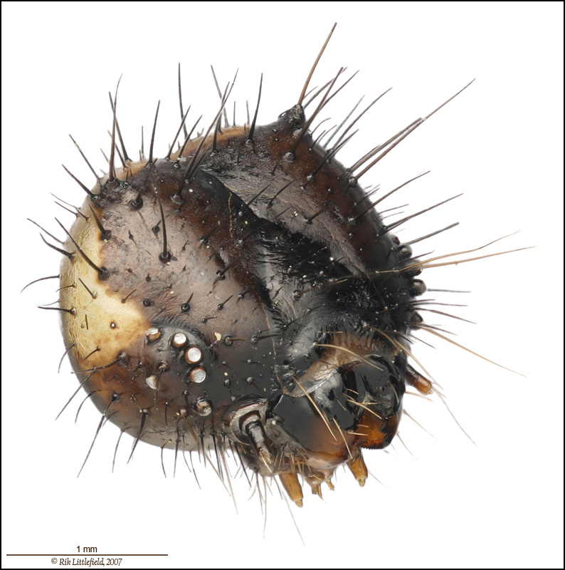

Looks like a theatrical mask... (2nd picture added)
Isn't time for another hint? :-k
A caterpillar of some sort?
Posts: 23362
Well, I don't know if it's a hint or not Nikola, but I can safely say that there is no caterpillar anywhere near this mask, nor were any caterpillars harmed or even annoyed as part of its creation. O:) :D
Posts: 23362
For what it's worth, here's a different view of the same subject.

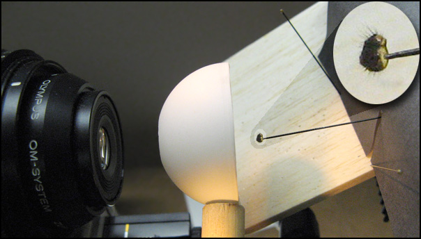

Here's the "How It Was Done" setup shot. I'm sorry it's difficult to figure out exactly how everything was positioned in this shot, but things were at pretty strange angles when I finally got the subject positioned the way I wanted.
Lighting was the now-traditional dual-head fiber illuminator with ping-pong ball diffuser, here seen exactly from the side. I have the fiber illumination cranked way down in this shot, otherwise you couldn't see much besides the pingpong ball and balsa board.
Background for shooting was a uniform card, printed and illuminated to be light gray in the image. The light gray was then pushed to pure white by post-processing in Photoshop, using a mask constructed mostly by Photoshop's "magic wand" tool, then tweaked by painting.
38mm f/2.8 Olympus bellows macro lens at f/4, stacked at 0.001".
Notice that what you're seeing in the pictures is essentially the entire structure of the subject. It is suspended in "mid-air" by being super-glued to a headless insect pin with the tip ground to match the bevel of the subject. From the standpoint of the camera, enough of the pin is behind the subject that what's visible is very OOF and faint enough to be masked. The subject is extremely light. I don't want to tell you how many times I blew it away by breathing before I gave up and hauled out the superglue -- then how many more times until I actually succeeded in restraining it well enough to complete the glue job.

This subject comes from a butterfly caterpillar, one of the fritillaries in genus Speyeria that are native to the mountains of southeastern Washington.
What may be particularly interesting about this subject is hinted by the words "comes from". As I told Nikola, no caterpillar was harmed or even annoyed to get these pictures. In fact the caterpillar seemed very content with its role in the whole affair.
What you're looking at is a head capsule that was shed by the caterpillar as part of the normal process of growth and molting.
The elaborate structure you see here is used for only a few days while the caterpillar grows as big as it can in its current skin. When it's time to molt, the caterpillar becomes quiescent for a few days while it literally grows a new head, inside the old skin and behind the old capsule. Finally the old skin splits behind the head and the caterpillar crawls out. The old skin gets left behind like a crumpled sock, while the old head capsule gets popped off the front and drops down into the ground litter, or in this case, into the bottom of a plastic rearing container.
This particular head capsule is the largest of the set of five (I think it's five) produced by these caterpillars as they grow. The smallest of them come from the first-instar caterpillars that hatch directly from the butterfly's eggs. I have the full set, but the small ones are kind of difficult to handle and so far I have not been able to get decent pictures of them.
