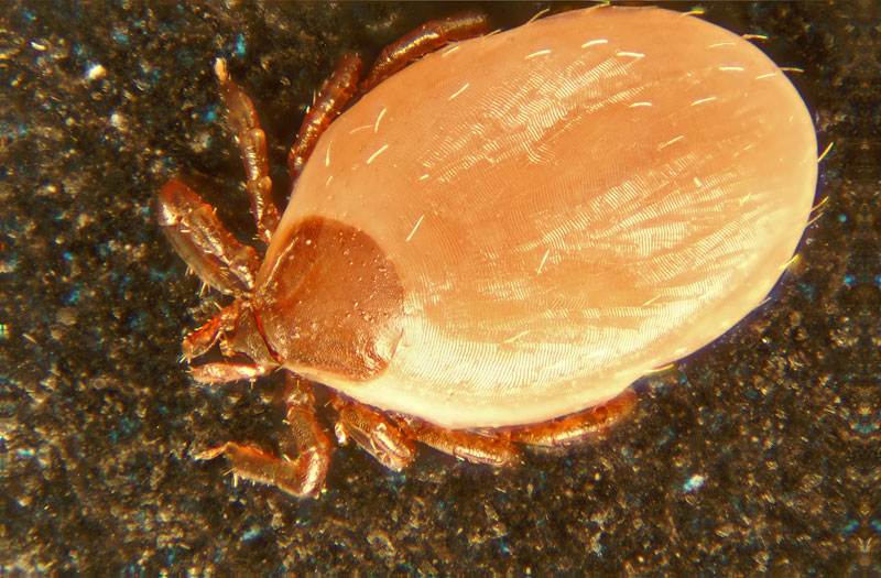

Is 3 pics and a URL over the limit, it is just there may be someone who can answer this here, any idea why this thing http://www.scientificillustration.net/_temp/tick_02.jpg found on my sons head (some kind of tick about 1.5mm in length) didnt manage to get any blood after at least 24 hours undiscovered? Will be on the lookout for rashes, so no worries abot Lymes, fingers crossed.

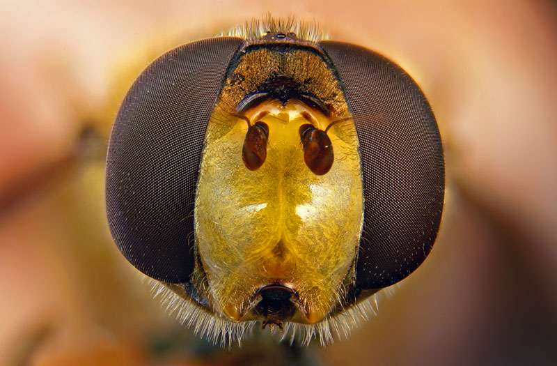

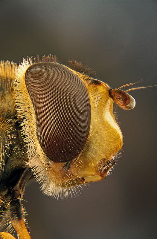

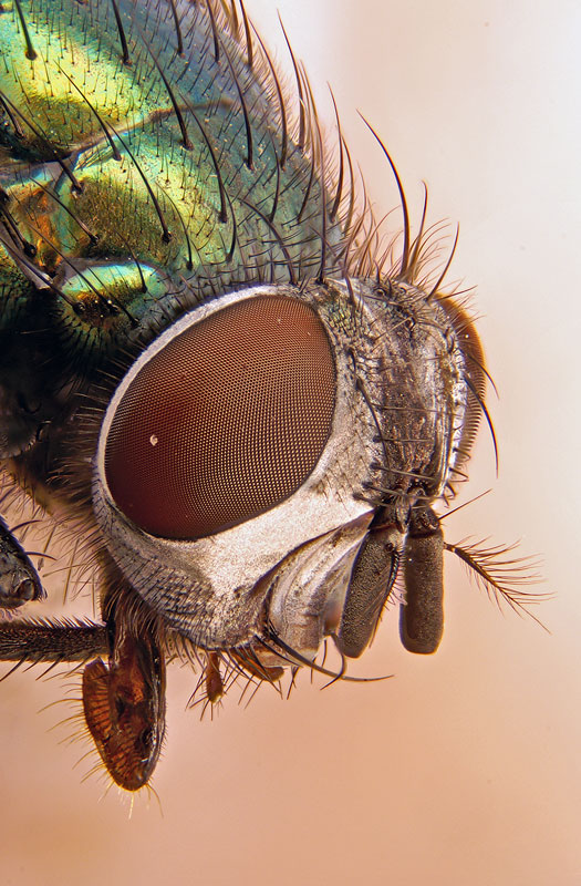

Anyway I got one of the lenses i had been looking forward to from USA the other day (reichert 2.5x Plan Acro). Since then I have been trying to put the advice to use. There have been loads of mistakes (it has to get into gigabytes on the hdd soon), but at least i know where they come from on some of them, so now i see more of what I did wrong. Here are some of the better ones, some of the mistakes are still there I know, but at least something has come out of it. I had no idea that camera shake could be sooo much of a problem even when the camera is screwed down. Still a work in progress but a little more predictable now.

My compliments ... Details excellent sharpness and color ... :shock: :shock: :wink:

Well, the subjects in the main pics are also v. familiar to me - seen same thro' v/finder often enough, such that when I saw yours, I was just about to put my gear on Ebay (and take up knitting or some such) ... then realised they're stacks :)
A very fine start to stacking, I'd say ...

The photos suggest that you've caught on rather quickly! :wink: Very nicely done... :D

Haven't a clue about the beast on your son's head, sorry!

Excellant work Tim. As Rik said you have caught on. Congratulations, hair details are very well displayed. How about some info to go with the pics like spacing, software etc.
As far as the tick is concerned I don't know the species but it looks full to me?
Three very nice images indeed. This is the sort of detail that is well worth taking time to examine closely.

Thanks Bruce, good to know i am on the right track, its all down to this place, i dabbled with stacking once before here and it did not go well so didnt dare touch it for about a year after.
Walter The greenbottle fly was 47 images of about 0.07mm sepperation, software was combineZ and a quick levels adjustment in photoshop and that was about it, camera was released with a cable and on a 2 second timer in the hope of reducing shake, exposure was 0.4 s I have seen similar ticks (and been bitten by in the nastyest places) that have really swollen up with blood, but this one looks much less swolen, i have a feeling that they have some kind of inflatable stretchy skin, and wonder if the ridges are to help inflation? Many thanks for the encouragment too :).

Superb images!

these shots are truly wonderful. Remarkable in fact. I was wondering what stacked was or meant

Incredible photos Tim. The bluebottle is stunning with all the detail. Maybe the tick is a male. Isn`t the female the one that sucks the blood?

wow, just wow. incredible shots, i cant decide which one i like most. what setup did you take these with?

Darren, "stacked" means that a number of images are taken, all as similar as possible except for different focus points, and then software is used to pick out the sharp bits and put together a single picture that looks well focused everywhere.
