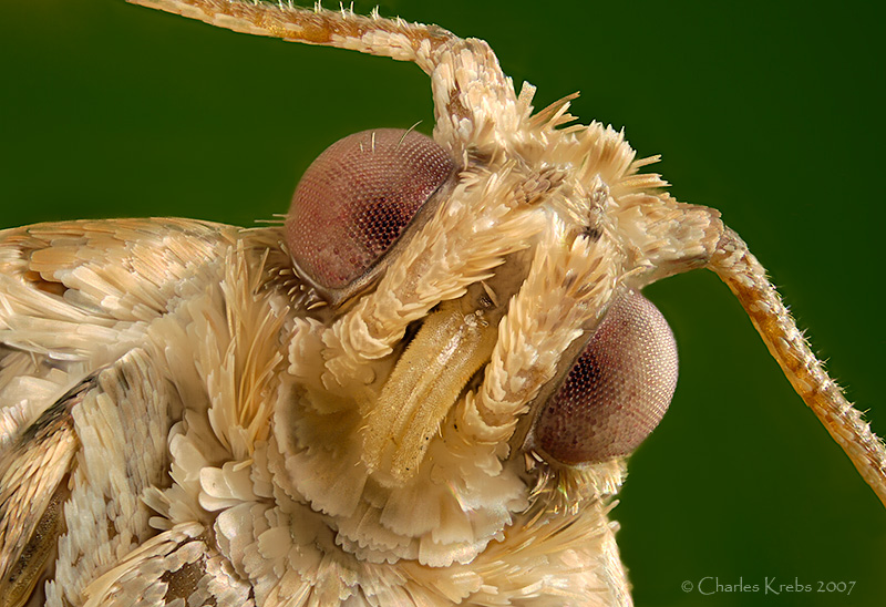

This (unidentified) moth was only about 8mm long, and was photographed at about 10X. So the total field width in these shots is about 2-2.3mm.
Impressed by Riks Fritillary butterfly egg results, I wanted to try a Nikon 10X microscope objective on bellows instead of the macro lens I would otherwise use for this magnification. A year or two ago I had tried a different 10X but was plagued by serious chromatic aberration, and gave up on it. This objective is much better for this use, and I was pleased with the results.
You get great resolution due to the large aperture, but it sure does take a pile of images combined to get any depth of field! (The top image is from a stack of 95 images and the lower from a stack of 102).
Nikon CF N 10/0.30 objective on Nikon bellows. Camera was a Nikon D200. Images stacked with Helicon Focus.

those are incredible images there Charles,, never done any stacking before,, 95-102 images stacked,,, wheww,,,, great results :D

Strange how the top eye in the lower picture seems to have some adventitious hairs growing out of it but the lower one does not?

Some really grand photographs as usual there Charlie, especially the last one! :smt023
Incedible photos Charles. Lots of details to look at over and over again.

wow those pictures are incredible. i wonder what that eye above the main eye is for. 95 image stack that must have took some time.
