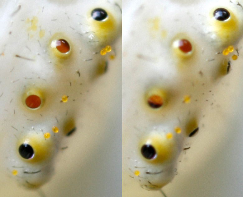

Beautiful as usual Charlie. I am assuming that the two red eyes are actually the primary eyes of the spider while the rest are nothing more than mere ocelli. :-k

"I am assuming that the two red eyes are actually the primary eyes of the spider while the rest are nothing more than mere ocelli"
Nah, it's red eye from flash on camera ! :evil: :D
Seriously, great shots, photostacking of a live subject is really pushing the boundaries. Good job spiders don't blink. Or do they?
DaveW
Those two eyes were interesting. No flash was used. While taking the photos it was apparent that the spider could "rotate" or ""move" something under the surface that made the eye appear either red, black, or partially red/black when viewed from the same position. These two enlarged (consecutive) frames show what I mean. (They are at slightly different focus points so try to ignore the softness). Of particular interest is the "lower" red eye. If you look at about the 2:30 to 3 o'clock position off to the side of the eye socket you can see that it is darker in the right frame. I could observe this darker section moving about below the surface and as it moved about the eye would show various stages of red, black, and "partial". I didn't notice this with the other eyes.

Pretty neat there Charlie, thanks. I suppose that explains the eye thing pretty much, doesn't it? So if, I am assuming, all eight of them are looking at you then they might all be red and that none of them are quite like ocelli, of which I thought six of them were. :-k That's what I get for thinking. :lol: Good info, thanks again :D
