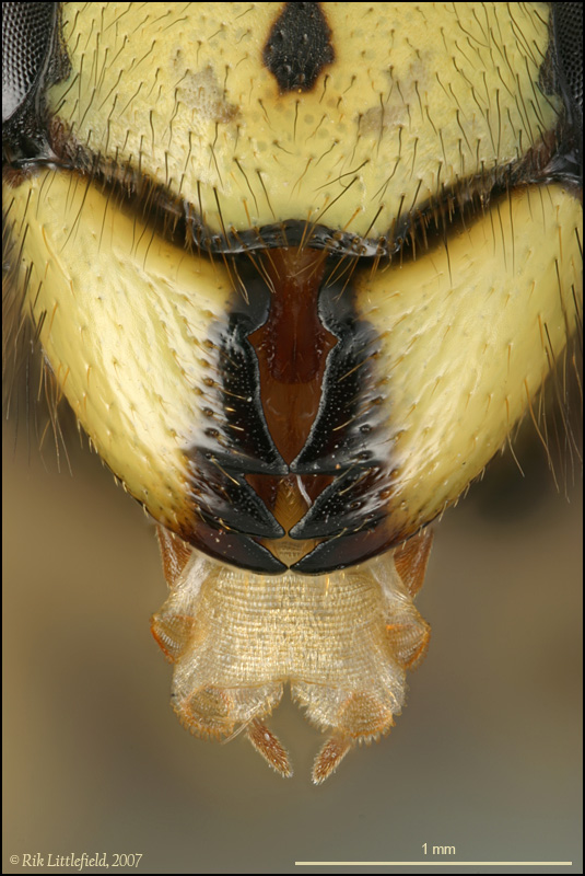

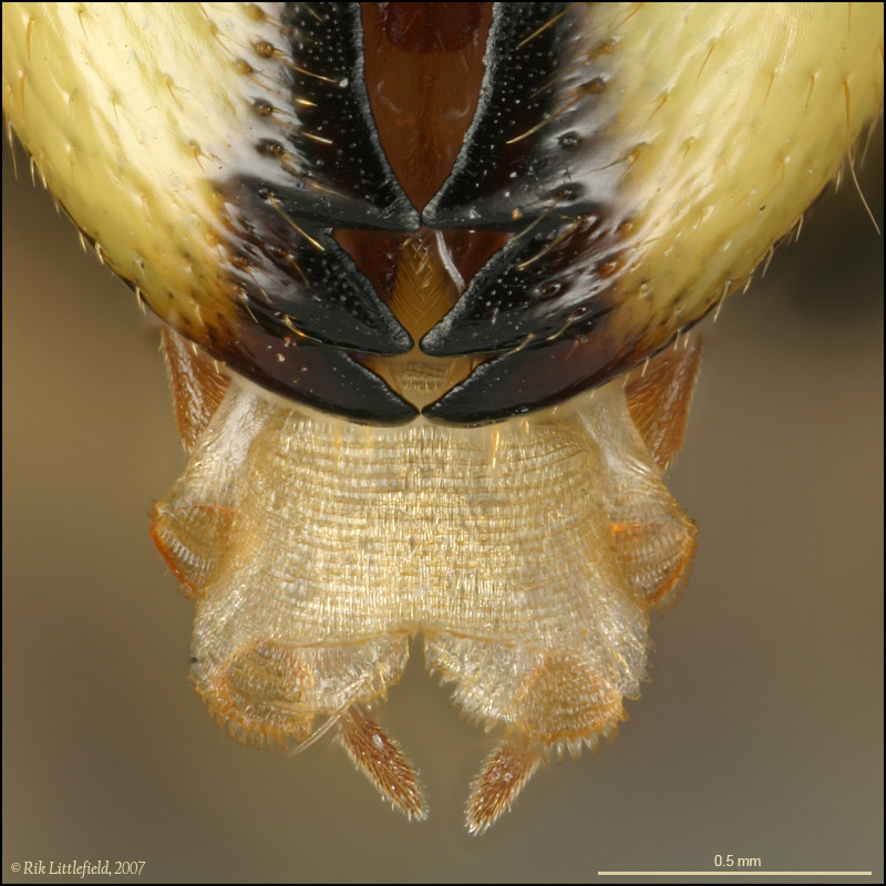

Normally I follow the "macro photographer survival technique" of never trying to work a subject that Charlie Krebs has already done. :wink:
But neither of his truly extraordinary yellow jacket faces (here and here) shows off this particular bit of anatomy.
Fact is, I didn't know it existed until tonight, when I was trying to figure out what to do with this particular corpse, which apparently died sticking out its tongue at the offender.
The thing I'm calling a "tongue" is the four-lobed fan-shaped organ that's behind the mandibles and in front of the two palps. It seems to have a fairly elaborate structure of its own.
If anybody has a good reference for the anatomy of wasp mouthparts, perhaps they can pass it along? I think it'd make interesting reading. (Yeah, I can imagine what you're thinking -- but you should see some of the other stuff I consider interesting reading. :roll: )
Hope you enjoy the pictures! :D
Technical: Canon 300D, Olympus 20mm f/2.0 bellows macro lens at f/2.8, stacked, 118 frames at 0.0005". Dual fiber illuminator with pingpong ball diffuser. First picture is full frame, second is a crop of the same image.
Edit: change title.

Great pictures Rik! What are the other structures behind the "tongue", the two furry long awl shaped things?

Wow! 118 beautifully stacked frames - a real labour of love repaid with a truly superb result.
The ping-pong ball lighting system has brought out astonishingly subtle detail and texture right across the image. The satin-like sheen on the complex and finely detailed "tongue" is particularly unexpected - very interesting.
Now I'm eager to see a side and ventral view to complete the set :D
Rik - An excellent project in every respect and unquestionably worthy of the same respectful genuflection afforded to a CK masterpiece.
Bruce :D

Rik, I go "Wow!" as well and indeed really do enjoy this gorgeous work of yours again. For me an eye candy it is to look so closely at the mouthparts of this Vespula sp. :D
Ad hoc I can´t recall a good reference that deals with the mouthparts of vespines in particular, but later today or on Monday when I visit my library I will have a look into some books on vespines I know to see If they provide something useful about mouthparts for you.
edit:
My friend (Good Booooy! :lol: ) just found an instructive drawing of the European hornet´s (Vespa crabro) mouthparts in one of our own books right behind me on our bookshelf. :o
So I delete my initial reference proposal ´cause this drawing is more adequate. Rik, I will scan it and send it to you via personal message since I don´t wanna violate any copy rights.
Best wishes,
Betty (´s science on demand service :lol: :wink: )
Excellent photos Rik. Incredible detail throughout the whole picture. The "tongue" looks like a good organ for lapping up soda at the backyard BBQ :wink:

DaveW wrote:Great pictures Rik! What are the other structures behind the "tongue", the two furry long awl shaped things?
I believe those are the "labial palps". They are multi-function organs that combine manipulation with an assortment of mechanical and chemical sensors. Kind of like fingers that also taste and smell.

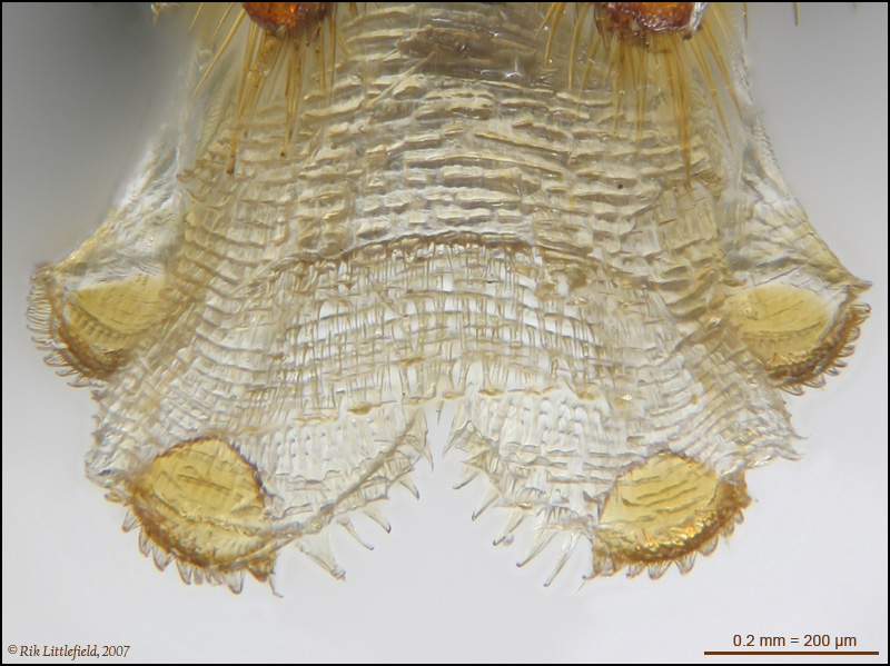

For now you're going to have to settle for this even closer, backlit view. I think it does a pretty nice job of showing how membranous the tongue is.
Thanks to Betty, I now have some great drawings of Vespa mouthparts. If I am reading them correctly, then what's shown here is actually two slightly separate structures (and the very tips of a third, at top of photo). The two large central lobes are termed glossae (sing. glossa), while the smaller outer lobes are paraglossae. (I have not investigated enough to know what the two dark tips at top of photo are.)
It was an interesting challenge to get the tongue separated from the palps so that I could take this picture. I suppose I could have dissected the specimen, but I wanted to leave everything connected so that I could shoot other pictures later. What eventually worked was to lash the specimen to a chunk of balsa with sewing thread, and simply tuck the palps under the thread! (While I was doing this, the tongue pulled out a little farther than it had been, exposing those two tips that used to be hidden behind the mandibles.) Then I lowered a piece of white index card into place to provide the backlighting. What you're seeing here, and in both the earlier pictures, is upside down from the way it was actually shot.
Fascinating structures...I hope you're enjoying the pictures. :D
Technical: Canon 300D, 10X NA 0.25 microscope objective on 150mm extension. Stacked, 64 frames at 0.00025".
