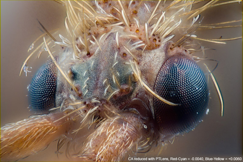

My sliding table has an adjustment of 0.00002 Mr. Which gives 50 x 0.02 mm divisions per turn of the adjuster. I've just done a stack of 66 frames with an adjustment of 0.02mm bewtween exposures. I'm not all that happy with it. I tried your advice of zeroing the auto-adjust in the Prefs, and didn't notice much difference.
The main problem is with some fuzzy areas in the final image which are not there in the idividual frames. I'm thinking that Helicon is struggling a bit dealing with some of the out of focus areas and is overlaying some of this fuzzyness onto the frames where the same area is sharp.
Here is the stacked image. This is straight from HF, I have not done any cleaing up of artifacts yet. You can see several fuzzy areas in the hairs above the eyes. If you look at the fly's right eye, you can see a heavy ghost of the in focus hair that crosses it. Also in the area between the two antennae.
There also seems to be some chromatic abberation which is obvious on the hair near the fly's left eye.
I'm not entirely sure if it's the lens, my technique or HF struggling with the characteristics of this lens. Probably a combination of all three.
I can definitely see that this lens, or something similar, has the potential to produce great images. I'll keep at and see if I can't improve things a bit.

It's not unusual to have visible chromatic aberration. Your image shows more than I usually see, though. That could be due to the coverslip correction, or to running the lens at an extension different from what it's designed for, or perhaps some funny interaction with the TC, or perhaps the objective is designed for use with a strongly correcting eyepiece.
Whatever the cause, CA can be greatly reduced by software such as PTLens. For example:
The other problems are harder to deal with and I think some of them are intrinsic to the use of large-aperture lenses.
The ghost of the infocus hair over the fly's right eye (left side of this image) looks like what commonly occurs whenever there are strongly contrasting features in very different depth planes. There is a fundamental problem that when the lens is focused on the eye, it's still seeing the hair as a very blurred but visibly bright overlay on the dark eye. Check your individual images and I'll bet you see the same thing there.
If so, then there's not much that software can do about it. It's theoretically possible for software to figure out the relative contributions of in-focus background and OOF foreground, and use that to remove the effect of the blurred foreground. But to do it in practice is very difficult and I don't think anybody has demonstrated success yet. To the best of my knowledge, there's nothing in HF that even attempts it.
The mystery to me is why you don't have the same problem with the hair on the other eye. But I notice that the geometry of that hair seems a bit strange, like it's thicker over the eye than over the face. By any chance, is that hair broken off and lying against the eye?
By the way, this problem is also more visible with bright foreground and dark background, because adding a little bright to dark makes a lot bigger percentage change than adding a little dark to bright. It sounds weird, but given free choice of subjects, you'll often get better results by picking ones with dark hairs.
The other problem is getting detail replaced by fuzzy haze, such as behind the hairs near top of image. I suspect the loss of detail is not fundamental (though the brightening is, as discussed above). You may be able to make some improvements by tuning the HF parameters, but I don't know how much. Again, this is a common problem with dense mats of hair, see for example the long hairs at the end of my click beetle trigger pictures.
The hair on the left eye is broken and lying directly on the eye surface. I suppose the best answer to this is to be a little more careful when setting up the scene and to avoid those circumstances which will cause artifacts when stacking. I find your observation s on the Light over Dark background fascinating. I will watch for this in future.
