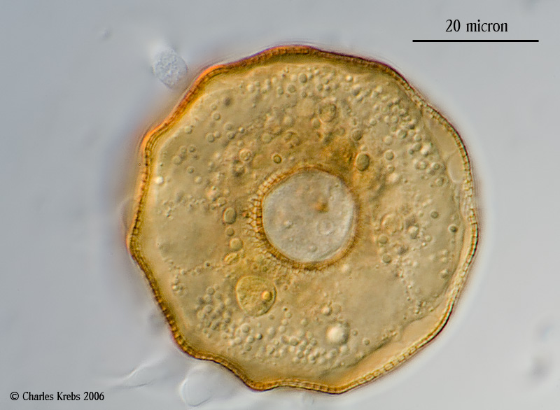

My last pond sample had quite a few Arcella in it. They can look very different depending on the viewing angle, and I've always thought a "diagonal" view gave the best overall sense of the shape of the test. But it's been tough to find a nice looking one in the proper orientation that would remain still enough for a "stack" to be made. I found one today that looked promising so I took the shots. It was taken with the 40X, and because of the angle and depth, when the correction collar was set for the "top" the bottom looked a little soft. Frankly, I was not expecting Helicon Focus to "spit out" anything good, but was rather surprised and pleased with the result. Of the shots of Arcella I've taken with a mind to representing the true shape, this one does OK.
The lower image is a view of a different Arcella using the 100X. I think I have posted similar ones, but I can't resist taking more shots when there is a good one creeping across the cover slip!
Top: Canon 350D, Olympus 40X S Plan Apo. 1.67X NFK eyepiece. Brightfield illumination.
Bottom: Canon 350D, Olympus 100X S Plan Apo. 1.67X NFK eyepiece. DIC with electronic flash

Well, these two certainly conform to your "manly magnifications" exhortation -- and they're beautiful besides!
The diagonal view of Arcella is one that I've not seen before. (I don't spend much time staring into a microscope, and it seems that nobody publishes these diagonal views -- no surprise, since without stacking, it would be essentially impossible to interpret.)
It's really incredible that you could get this shot with ordinary brightfield -- the dang thing is so sharp and clear that I'd swear you had substituted a partially deflated basketball!
I know that other people have encouraged you to turn this stuff into a book, but I figure one more vote can't hurt. If you do it, I'll buy copies for myself and a stable of friends to boot.

"DID I READ A BOOK...CHARLES DID A BOOK" The first picture is fantastic, very 3D in a microscopic flat world. All you fellas can ramble on all you want because a lot of info comes out of your rambling
