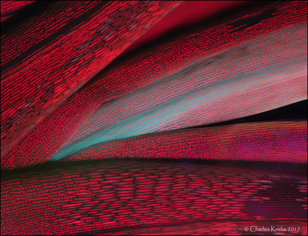

I've been playing around with a few "new" things. I motorized the MM-11 for stacking and also finally tried a little fluorescence with it as well. These are my first "test" images with the new additions.
The fluorescence is done with a Nichia 365nm LED and a Thorlabs 420nm long-pass filter (#FGL420, $25 for 1" circular). I used the Nichia LED directly and did not add anything to trim any potential minor "spill" above 410nm. I need to test a little more to see if this occurs. If so I will add a sharp bandpass filter to it... but it appears at first look to be doing a decent job in this regard.
The stepper arrangement uses a 0.9 degree stepper motor (400 steps per revolution from WeMacro) and the WeMacro controller and Android control program. It drives the Nikon fine focus knob (200 microns per revolution) directly and thus provides 1 micron movements for each full motor step. (I can go much smaller with micro-stepping but 1 micron will be fine for the objectives I generally use with this microscope).
This first image is a bright green moss

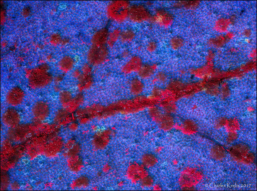

This was a leaf collected at the edge of a marsh. It was bright "kelly" green all over, and I have no idea what I'm seeing with the fluorescence! Smile 10X
Same plant, different leaf with 20X

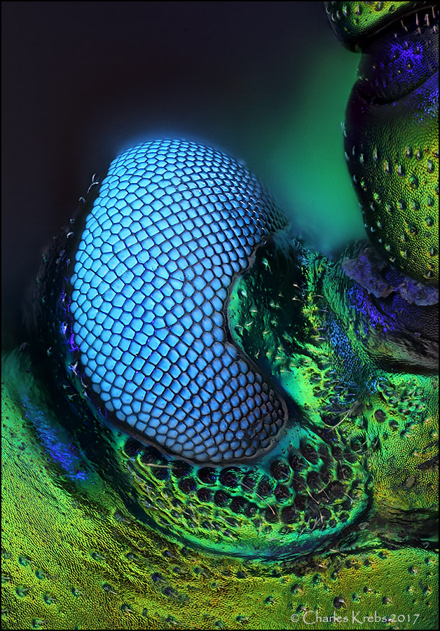

On my workbench I found a jewel beetle I had previously photographed. The eye fluoresced a very bright "baby" blue. But everything else was black so I added a little diffused "white" light which created an odd looking beetle indeed!

Very nice indeed. Inspiring. I think the red fluorescing cells on the back of the leaf are likely a unicellular terrestrial alga, a bit like Pleurococcus. A regular brightfield image would confirm.
