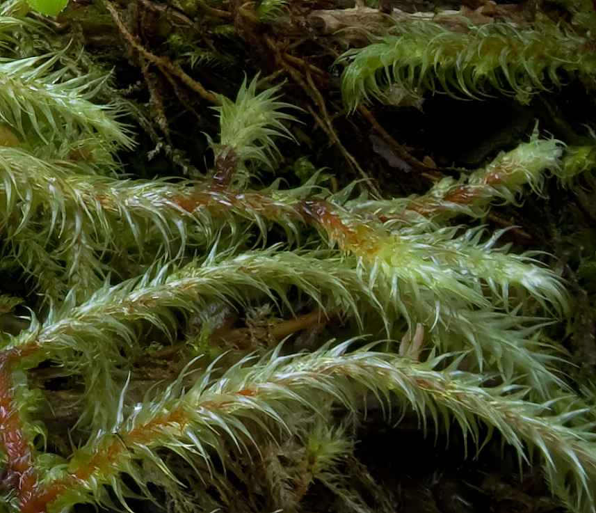

I thought I would add these images to show how nicely the Oly 28/3.5 does when extended in this manner. These are 100% pixel sections taken from the original full size stack (as indicated by the red boxes).
Very nicely, but how close is that?
I would guess that toadstool isn't a foot across, but I don't know...
Musing - some of the impact of therse pics comes from realising the scale of things. Problem with much veg is its fractal nature, there's always a bigger/smaller version. Something recognisable like an acorn would be good.
Wow! OK, they look like club mosses, but stunning detail.
Having very recently obtained a multicoated, later version, of the Zuiko 24mm f2.8, a lens with a particularly good reputation, I must do something about seeing what it will do. It may be that the m4/3 sensor is a limiting factor. We are just emerging from the longest freeze in many years, so nothing will happen in a hurry.
